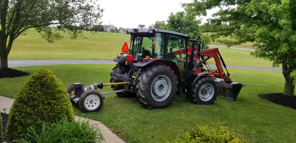

Been four years with my 4707 now and still love it. It's just a fantastic tractor. The upgraded loader (with self-leveling) was well worth the money and it's easily the most comfortable tractor I've ever operated.
In four years, they've gone up $11k, though.
Just over 3 years of owning mine and it's still doing great. I love how I can get home from work and it's too hot to do anything outside except get in the cab, turn on the AC, and catch up on my mowing!!!

other than the jerky three point control, which I feel better knowing I'm not the only one who had issues with it, my only wish on this tractor was that they hinged the iron grate over the moon roof. Hinge it back for cleaning and clip it in vs a spot for stuff to collect and hard to get a cleaning mop underneath.
Initially had concerns over it being a three cylinder. Also owned a 3 cyl 50hp Massey, totally different tractors and I'm now a believer in less than four cylinders. I think the sound is just a little harsher. Vs my 27hp Massey with a Mitsubishi four that ran amazingly quiet and smooth, one of my favorite motors. One 3 cyl came from India, this one came from Massey's new factory in China. Massey has always been very international in its approach, wonder how pricing is affected by the current tariffs.

I haven't had any issues with the 3 point being jerky. I really like having the fender controls on both fenders. That's really made hooking things up a lot easier!!!
The clutch is another story. It's very jerky. I've read up on how to calibrate it, but I just use forward reverse lever on the left of the steering wheel, and the button on the gear shift to bypass the clutch. The only time I use the clutch is when I start it, or a panic stop. And for some reason, I push on both the clutch and the brakes at the same time when I feel that I absolutely have to stop right that second.
Since the 4707 uses the same engine as the 100 hp 4710, I don't have any concerns with it being 3 cylinders. It's so far derated of what it's capable of that I have no worries about it at all. 70hp is plenty for what I use it for.

Four years and a little over 200 hours later, my '21 4707 still has a jerky clutch, but I mitigate it by not using it very much and only when necessary. As a previous poster said, just use the reverser and the button on the shifter.
As far as the 3pt issue, my tractor initially had it pretty bad. The dealer sent a tech out a couple times and could not fix it, so they eventually loaded it up and took back to their shop for a week or so and when I got it back, it worked quite a bit better. Not perfect, but almost.
The hood still won't stay up when lifted, but I guess it's going to be that way as long as I own the tractor.
Having said all that, this is the best tractor I've ever owned or operated and I look forward to every time I hop in it.
