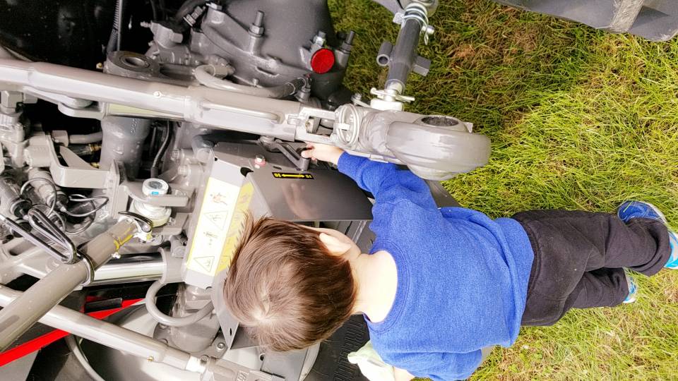

What does everyone have for stabilizer bars on a 4707 deluxe? Turn buckle or telescoping? Literature says telescoping but I’ve seen a few with turnbuckle & apparently the telescoping is backordered?
It's a combination. Pull the pin, get it close, then turn turnbuckle to fine tune and lock. My grandson Peanut will show you a closeup 20181025_152733.jpeg
I have found the stabilizer setup on my Massey not as friendly as the one on my last Kubota. But it works.

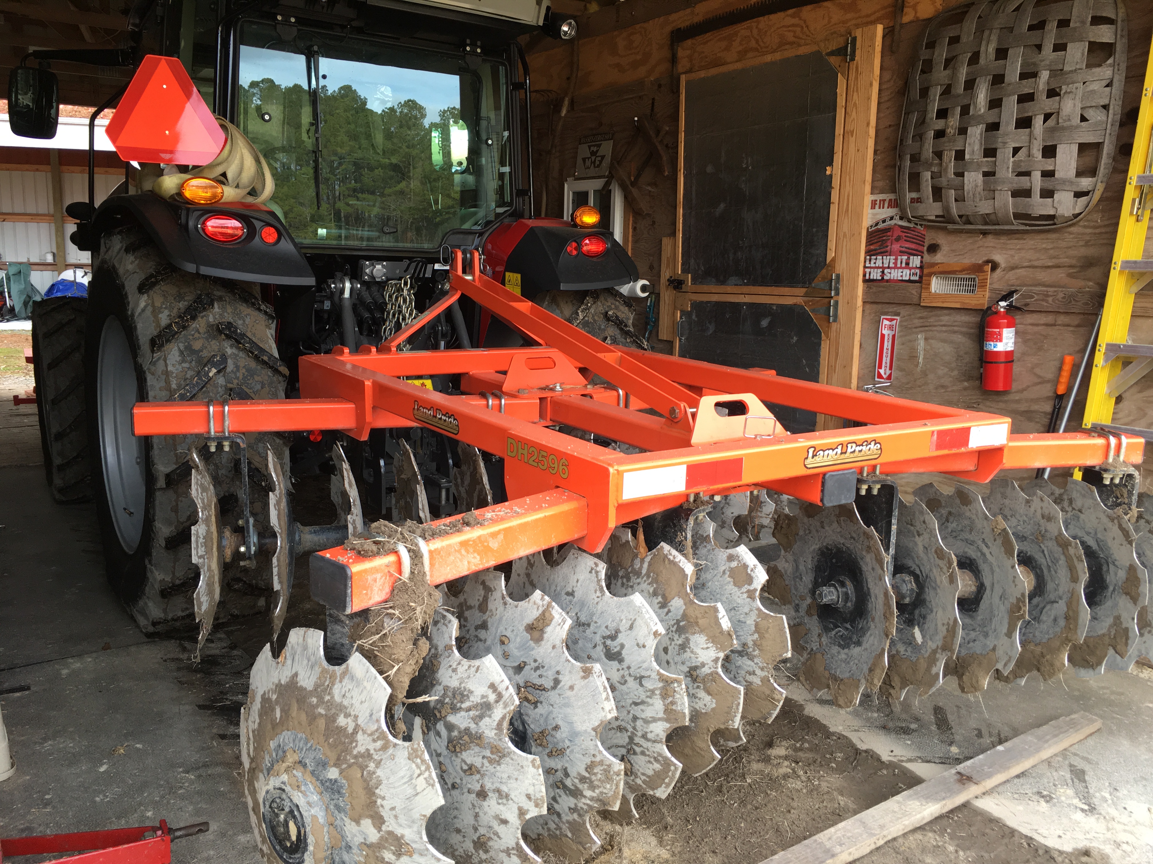

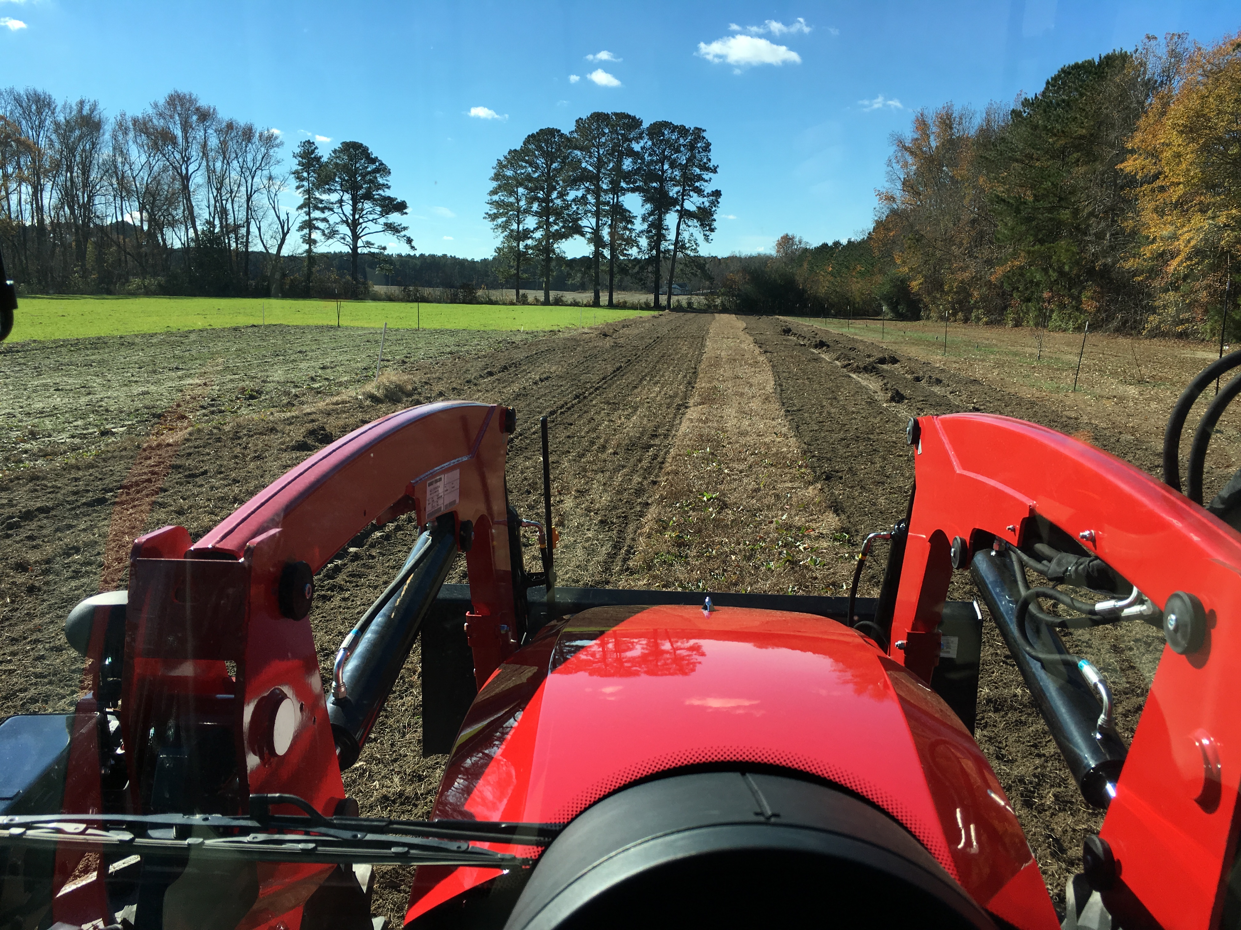

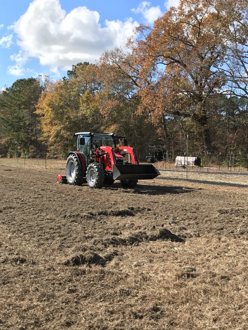

Neighbor took some pics of my tractor, hope to be out in fields in a few days, after this last rain dries, and rototill that field
for potatoes and collards going in next week.

Ohh, my dealer doesn’t sell many of these tractors.. or this sales guy doesn’t ask the right people questions. (He’s nice, they just sell more orange)
When I demo’d it I thought it had to be turned by hand the entire time & it was such a pain. That sounds actually really nice to keep the movement/sway out of it. They said the tractor would arrive today, but they said that before a few times so I’ll wait and see.
And, thank you to peanut for showing me :)

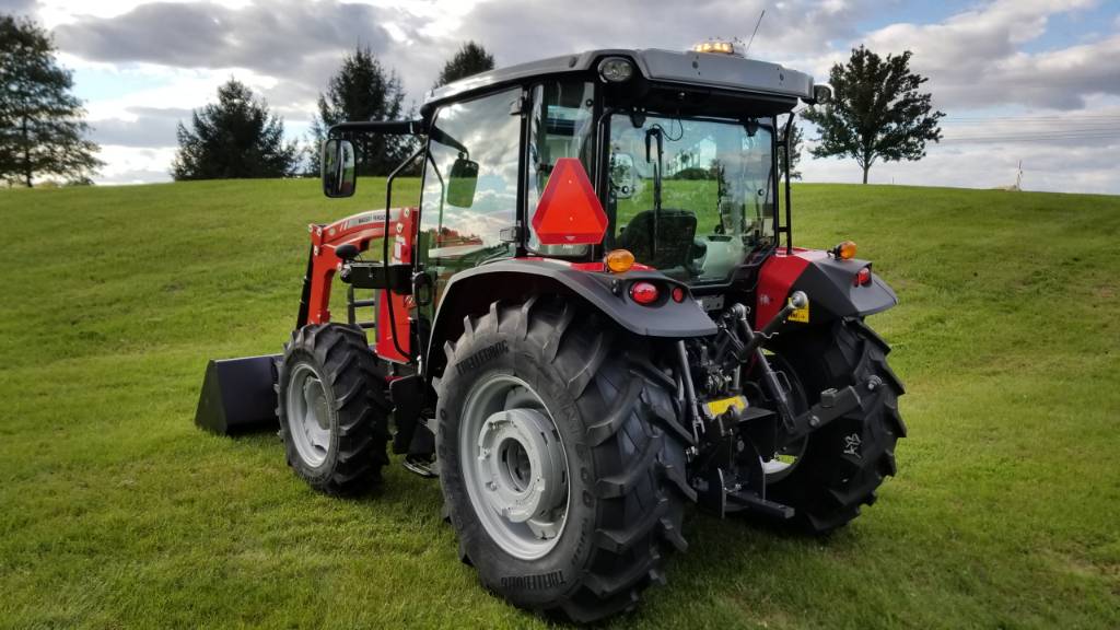

Nice pics! It looks like you have the 34” rear tires?
He does have the 34's. However, the 4707 should have 30's. The 4708, 9, 10 should have 34's. My dealer said that the 4707 will be underpowered with 34's .
yes, 420/85/34 a lot more tire than 70hp needs...but happy to have them.

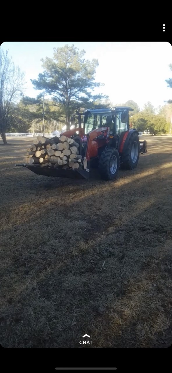

it is such a pleasure using this heavy solid bottom grapple on the Massey, totally overloaded my Kubota, but now it's properly
matched to the tractor. The hydraulic speed on this tractor is very fast. I almost chucked a log back into my windshield pulling up too quickly at one point, got some air but not backwards. ok dokey, a little slower next time...
I agree.
another way of saying that is 70hp is not enough to get the full traction capability out of those size tires.
Anyone pulling heavy wide implements is going to go up to a higher hp tractor anyway.
But I've always liked over spec'd tires so this is fine with me; e.g. if the trailer needs a B tire, I put a C on it.
I am surprised that they are useing a 420/85 tire,
a 16.9-30 or 16.9-34 isn't that big of a tire.
I would have expected a 18.4-30 or so on that size tractor.
Which would have been a 460/85.
Hard to have to much tire, if it is pulling to hard drop down a gear.
I'd rather have to drop a gear then spin out.
