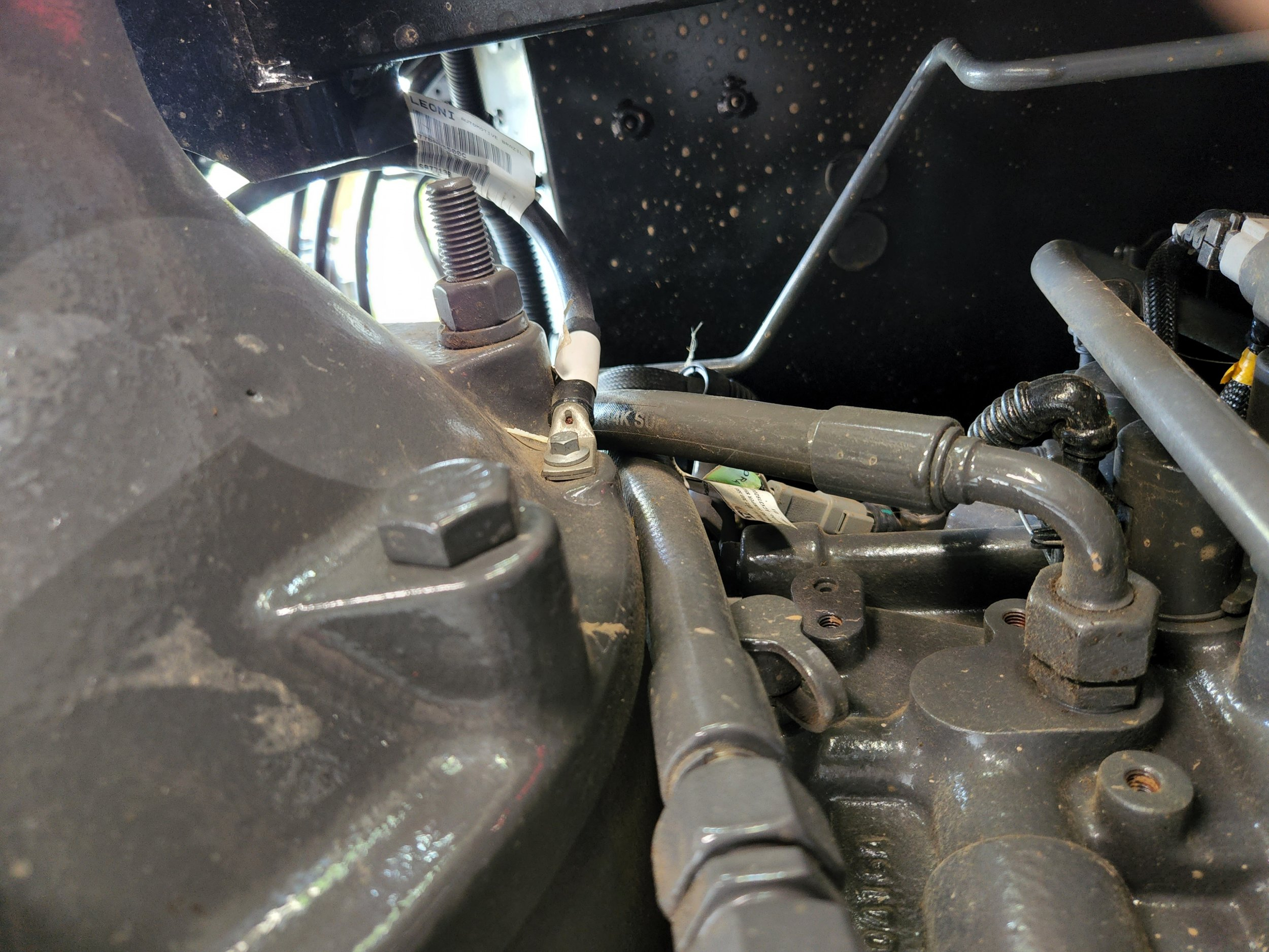

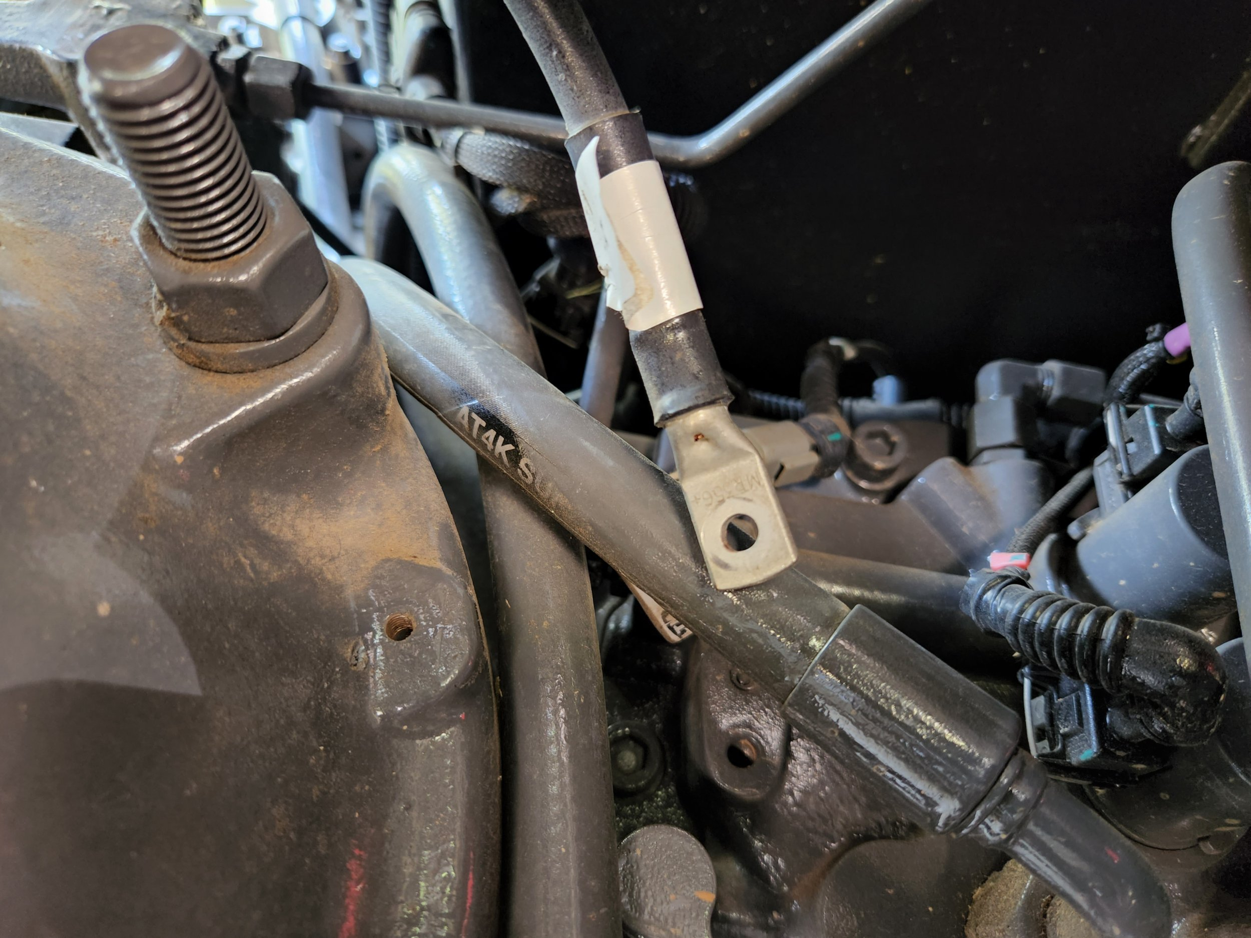

Guys, I read the Facebook post about cleaning the grounds on the global series tractors and I can't recall the guys name but he is correct in urging us to do it. My cab ground at the back was loose and the bolt threads stripped and where that same cable connects to the chassis at the axle housing was just bolted down loosely on top of the paint. You all need to remove these and clean them to bare metal and reinstall them tight. If you find one with a star washer under it remove it and toss it in the garbage. That H code I was having pop up from time to time during pto operation was fixed by this.
