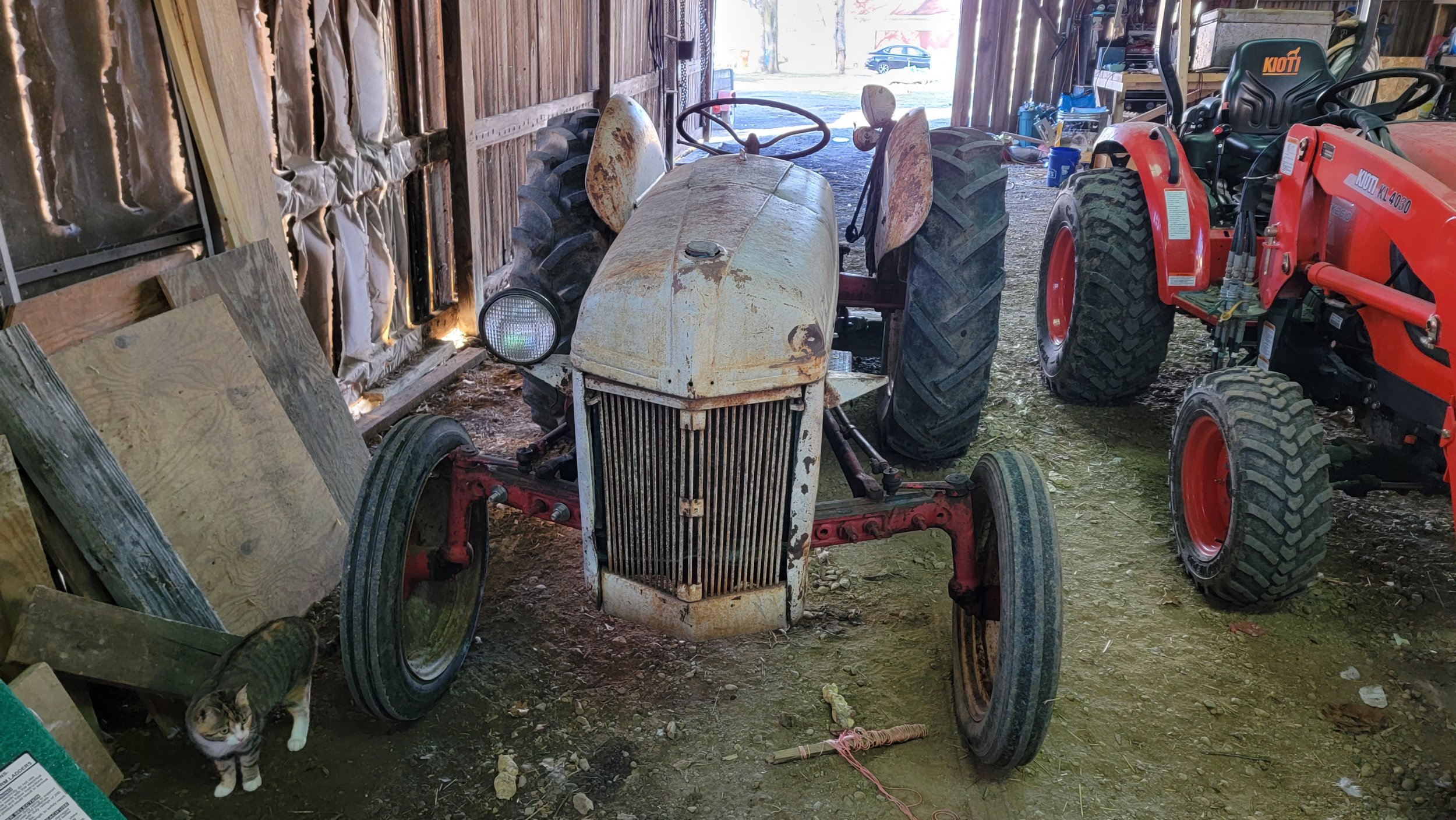

Good to hear. Post a pic. We love pics of old tractors.

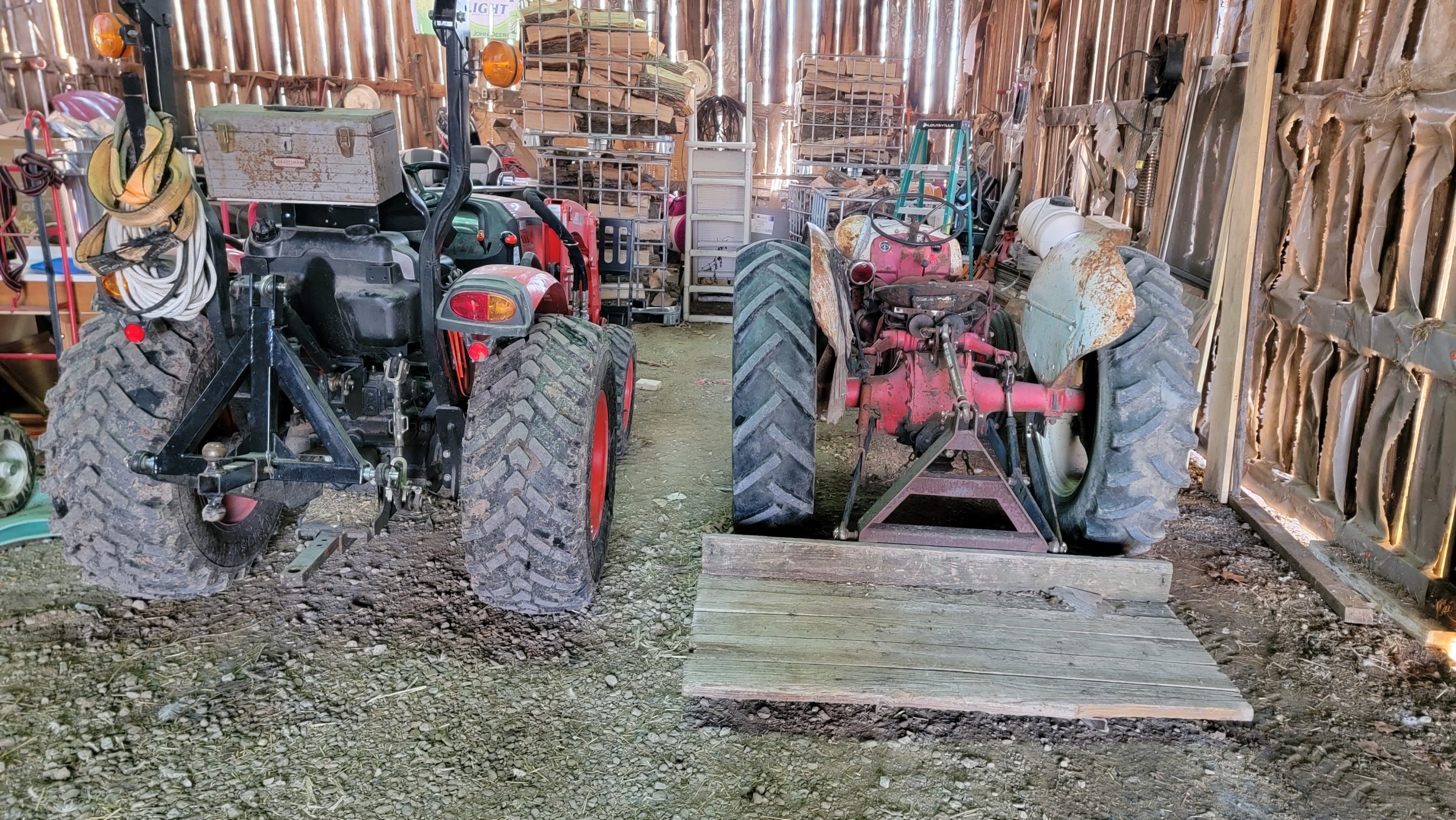

#23
