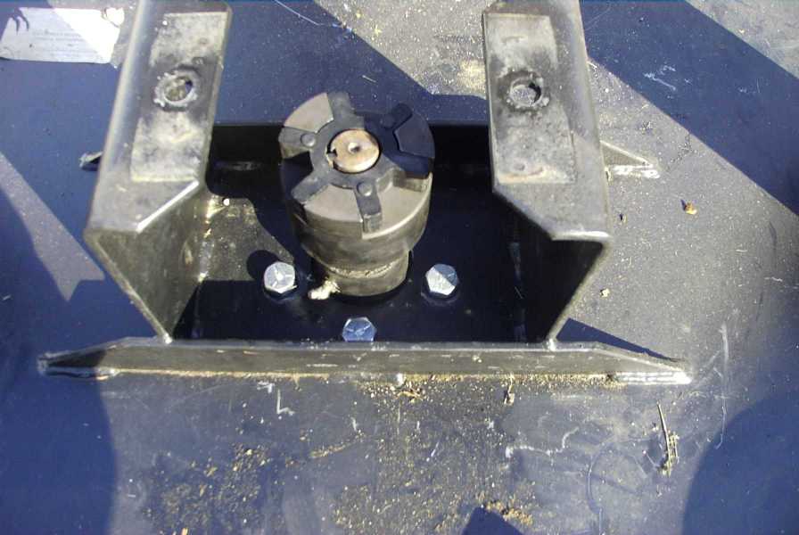

MR: I assume the picture of the hub was taken after cleaning it up with solvent. My assumption on the rough-cut, with similar configuration, is that there is a gallon or so of grease in there. It must be going somewhere. /forums/images/graemlins/grin.gif

Nope. Never cleaned it. Haven't seen a grease fitting on it either. It's probably a mystery, just like the grease fittings on the underside of the finish mower spindles.

Well, I went and bought some grade 8 bolts and put the thing back together today.
The first picture is of the hub under the brush hog deck, with 3 of the 5 self centering bolts installed loosely.

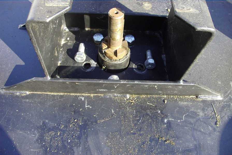

Second picture shows all 5 bolts in and tightened. Also shows a grease zerk installed. The unit came without one. There was a hole for one already tapped. I used one with a 45 degree angle to make it easy to get to once everything was installed.
Duane had asked a question earlier...
<font color="blue"> Did you pull the bottom stub shaft out of the hub. Just curious whether it is just a greased bushing, or has roller/ball bearings. </font>
I can't tell. Can anyone tell from the picture? I didn't want to take it out and look.

Third picture shows the bottom half of the coupling slipped over the shaft. The star shaped thingy at the bottom will go into this half of the coupling. It is made of hard rubber type material.
   / 48" Brush Hog Re-Assemble
#20
Re: 48\" Brush Hog Re-Assemble
Fourth picture shows the star shaped rubber thingy installed in the lower section of the coupling.
