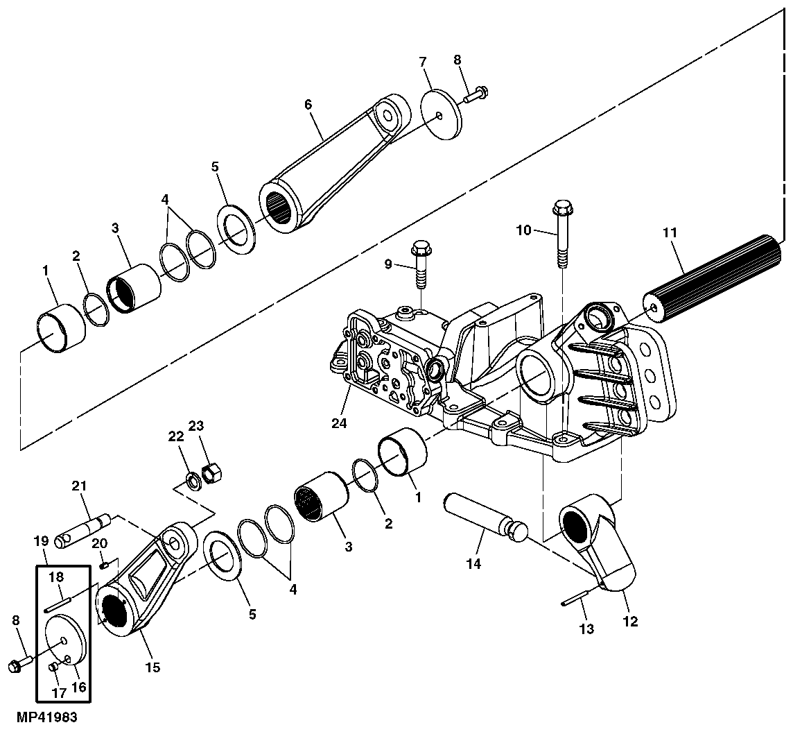

I've had the 485 BH on/off my 4320 several times since new about a year ago. Two things. First, when removing the hoe make sure it is resting with little/no pressure on the cylinders and the hose connections will be much easier to connect/disconnect. Second, there is an up-stop adjustment for the 3ph which when adjusted properly will enable lifting the hoe high enough to insert the two top pins w/o using the stabilizers. The up-stop adjustment has been discussed before and can be found with the search mechanism. I had to do it on my current 4320.
Edit/Add: Here is the link for adjusting 3ph up-stop http://www.tractorbynet.com/forums/...rating/170046-adjusting-3-ph-485-backhoe.html

Thanks for all the information ! You guys are spot on !
I forgot to mention that the 3pt was out of adjustment so I can't pick it up high enough to get the pins in so I've been trying to use the stablizer arms/etc. to get it up high enough.
Sounds like once I get it adjusted I will have no more problems.

I played with installing and removing the 485 and the 3PH doesn't lift it high enough to engage the two locking pins. I see the adjustment but I've heard you can damage the 3PH if you adjust it too far so I'm reluctant to do it.
Right now I'm using the stabilizer arms to install the BH, takes me about 10 minutes to get it on this way.
I can see where pin 14 can be over extended and cause problems, also part 12 can hit the front of the housing if the adjustment is wrong.
Rob
