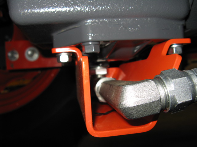

Thank you sir, and to all of the other kind replies.
To anyone reading, I have a question.
These two photos show a hose/fitting (the blue rectangle and then down inside of that skid plate "tunnel") connecting to a block set up for PB (last two photos).
My question is: what is the component/outlet/inlet that is in the tunnel that the hose is connected to?
Thank you.

That is the feed line going into the transmission then out to the 3rd function valve. That area were the line is going used to be the drain plug on my 4240 and the feed line was in another location on that. With these 5740's if you hook that guard off and that line comes down your dumping all your fluid :shocked:

"...if you hook that guard off and that line comes down..."
My eyes would not be big, they would be rolling back in my head!!
Mr. Short,
Since that is/was the hydro drain plug, how do we then drain the hydro?
Do I have to dismantle all of that to do an oil change?

Yep. There will be a drain plug under each housing plus you'll have to remove that guard, line and hose to get all the oil out unless you just hook it on a rock and rip it off :laughing:
You won't have to worry about the fluid change until you hit 200 hours.
Oh. My dads name was Mr. Short. My name is Paul. ;) :laughing:
