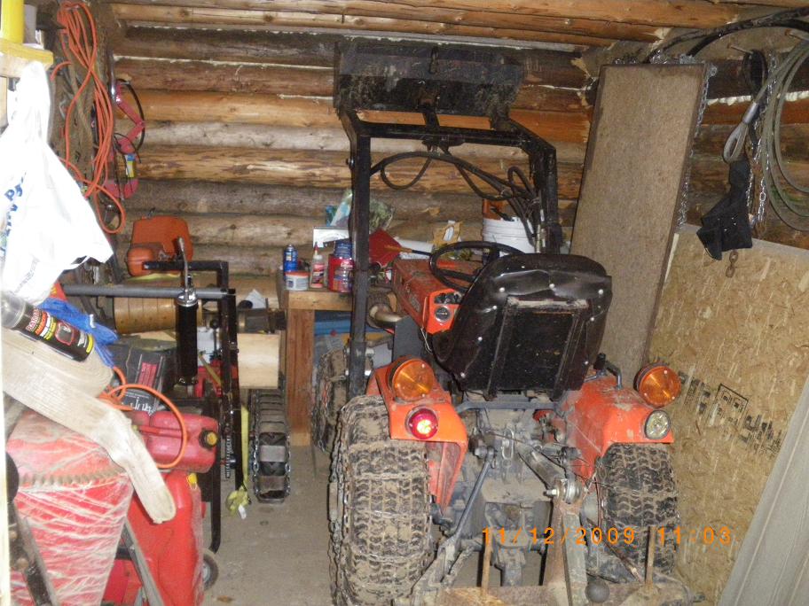

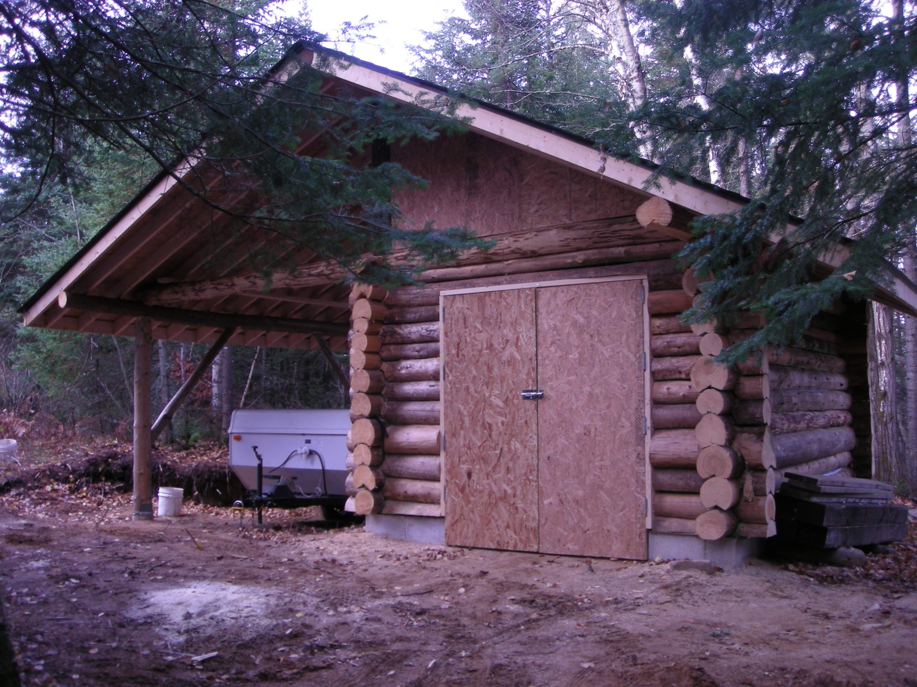

I have run chains on my mini Kubota for 6 years now. I have Turf tires on it. I used it to skid all the logs out of the bush, many times using a full bucket of sand to aid in the traction. I have to park it with the bucket up to make room for the rear blade. :)
Nice log construction. Your Kubota looks like a hard working little beast.
Dave.
