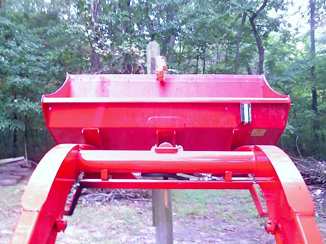

This past October I had to remove 25-plus 4x4 fence post all in in concrete. I started out using a nylon strap and choker and pulling them out with the FEL. Doing this by myself was going to take forever. So I had to come up with a better way. So the next post I curled the bucket while raising the loader on the corner of the post. It came right out so the next one I did broke off at the ground while trying to catch the edge with the bucket edge. So now I had to dig the concrete out. To keep this from happening again I got out the chain saw and cut a slot on each post so the bucket edge would be able catch more easily. This worked out perfect I was able to go from post to post pulling them out with the previous posts still on the bucket. I would have 3-4 post hanging on the bucket then unload and come back for more. I had the job done in a fraction of the time it would have taken doing it with a choker.
I had more pictures of this project but some how they all got deleted accept for this one.

I never though of notching the post.
I take a piece of scrap 2x4 or whatever I have lying around, and screw it into the side of the post. Same result, just probably takes a little longer.
If you don't have a FEL or tractor handy, you can also do this towards the bottom of the post and use a hydraulic bottle jack to get the post out. I've done this allot when repairing fences.

"I've just took a hammer and driven a spike or larg nail into the post a ways .
Just need something on the post to snag the feel or BH bucket.
Wonder if I could do the same thing and pull post with a front blade.

I used a slip hook and a chain and it worked well.

I have cut them flush with the ground, and ran a large lag screw into the wood with an impact wrench. Then, I put a chain with a 2 fingered hook over the head of the lag bolt, laid some boards out, and used a bumper jack to pop them right out.

I just use chain with a grab hook. Wrap around a couple of times and hook on edge of bucket. Out it pops.

Before I had a FEL I used to take a 16" wheel rim, hook a chain as low to the bottom of the post as I could. Then sit the rim against the post and run the chain over the rim. Hook low on draw bar, drive forward and it would role right up the rim and out. Now I have a loader and life is easier.

To pull posts and/or lift other items prior to my FEL, I used my Hi Lift jack...What a great little workhorse it is...Still comes in handy in tight places.

No FEL for me, a choke and a home made 3 point boom pole and had no issues pulling out 6" dia posts. One exception was that there was no concrete involved. I reckon that'll be a bit different case.

After hurricane Ike alot of my privacy fences treated 4x4's where snapped off right at the ground. I ran a large lag bolt with a washer through a end link of a chain using a 1/2 drive impact ran the lag bolt into the broken 4x4,then hooked to the hooks on the FEL. Pulled the broken post and concrete up easily and I had strainght clean holes to reset the new 4x4's in :D
