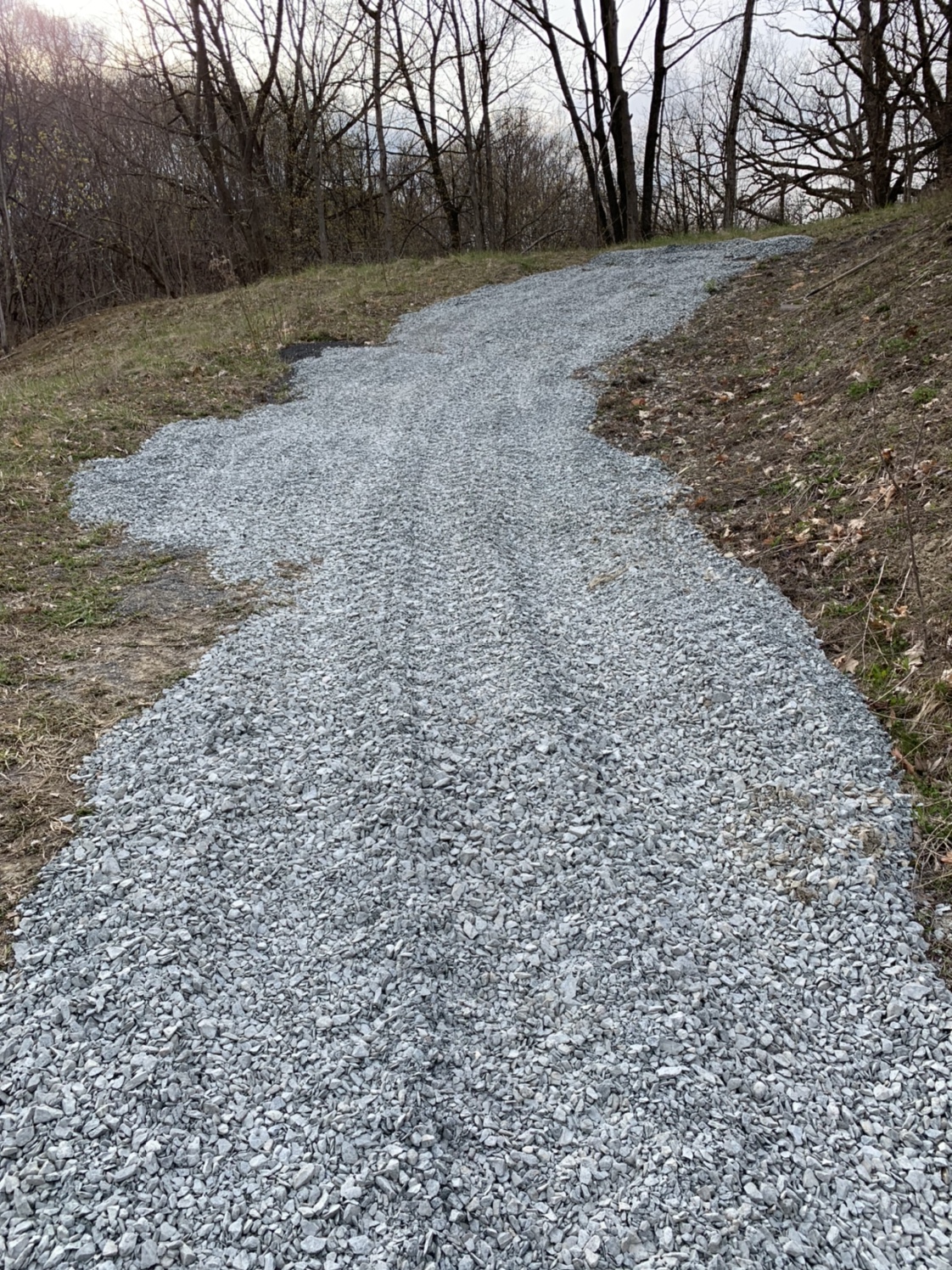

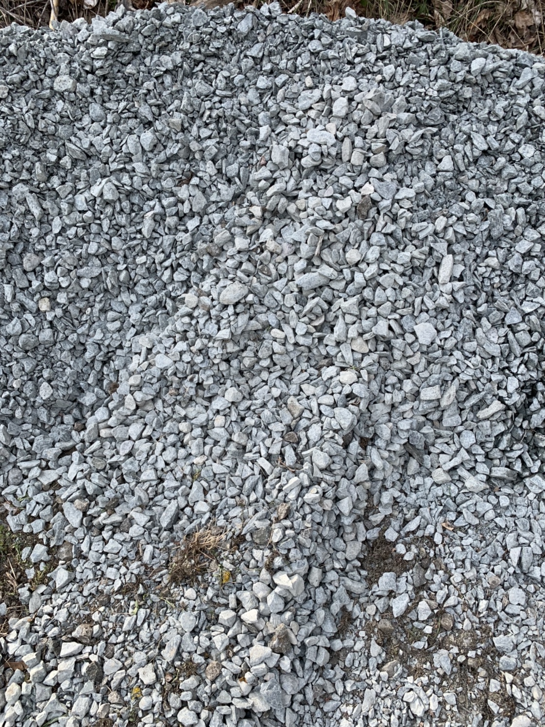

Thanks for the advance! IMG_3129.JPGIMG_3131.JPG this is what need to maintain. Would a box blade be the right implement for this? Should I consider a back blade or rake? I have other uses for a box blade so if that will work, all the better.

I agree with fried1765, a 6 footer will be a lot for your 1720. If you are just scraping the top layer of loose gravel or soft soil, you would probably get away with it. For what you describe, a heavier 5 footer would do you better. I have a 25 horse compact tractor, I can get it to spin tires when I get a 5 footer loaded up. Better to do a couple more passes than be frustrated not being able to pull it.
This sounds more like a traction issue...I can pull a 60" bb over flowing with wet crusher run up hill with just a 17HP b series with no issues...the only time I lose traction is when a scarifier hooks on a huge rock or big root...which the same thing will happen with much heavier and more powerful machines...
Again, what does the manufacturer recommend ??
