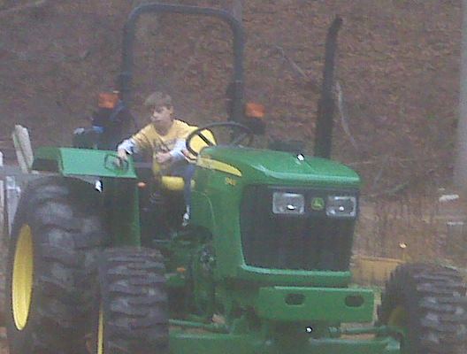

I made the trade , the 4300 is gone and the 5045e has took its place
I'd say that is a good step up in size and capabilities.:thumbsup: Of course we want some pics when you get it.

Only have this one for now
