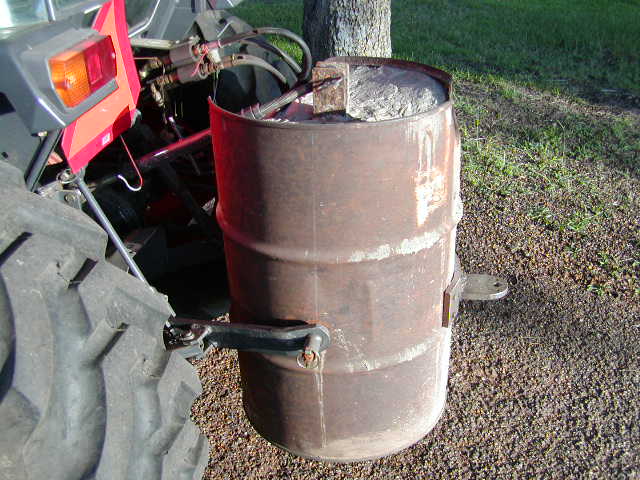

Attached is picture of mine. Few things I did & wished I did.
Forgot till afterwards I needed a hitch, so I installed one with 6 hilti masonary anchors, fully expecting to have to run a band around the barrel to hold it on, when I jerked it off. So far it is still on & have been jerking a 7000 lb roller around with it.
I made my knotch for the top link a little too small & bent the top link when I raised the barrel all way up.

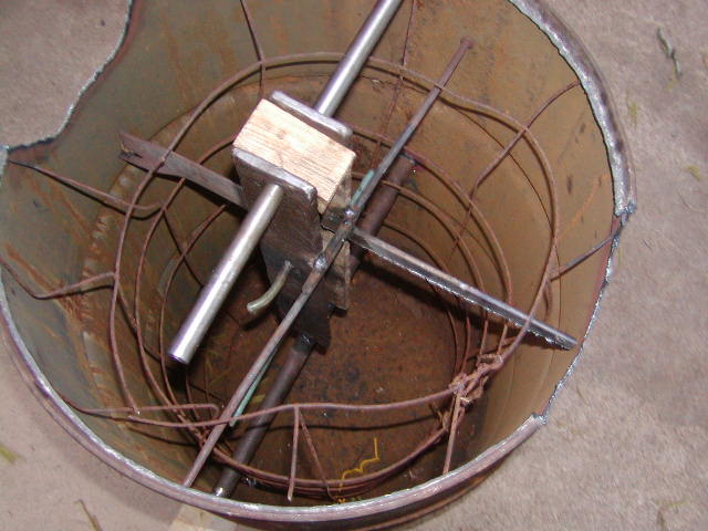

I took a 1" round rod, cut the ends down to 7/8" & drilled the holes for lynch pins & ran it through the center of the barrel. Then welded flat bar to it, running up top for the top link connection. Welded a little junk iron to hold it in place while pouring.
Works really well. I store it on a Harbor Freight car dolly. If I remember correctly, I did spread the casters out a little. Use a hay hook to drag it and other implements around to store or install.
   / 55 gallon drum weight? #23
Before I poured

You will want a hitch on it. This is a darned if you do, darned if you don't thing. Have a hitch sticking out, & you will back into everything & leave an ugly mark. Don't put the hitch on, and you will miss it almost every day. If you can engineer a quich-tach or low profile hitch onto it.... now's the time.
I would not want the floppy chains, I'd want a solid top link. You can custom make a short one from the front of the barrel, but realize how that drastically changes the 3pt angles and get it right.
However, you can put 2 limiter chains from near the bottom of the barrel, up to the top link, in addition to the solid top link. Then the chains will carry the weight of the barrel, not your hydraulics. Many mowers have this type of limiter chain to keep the front of the mower from dropping too far. Know what I mean, check it out.
My uncle built one long ago for his IH 404, he intentionally put the lower pins in too low so the barrel would not scrape on the ground if the 3-point was lowered. He parked the barrel on a block of wood. Me, I would prefer the limiter chains....
Now, a person kinda gets up to rammimg speed once in a while with a loader, & you might be using this thing for a decade or more. With a 1/2 a ton back there. I'd reather have a solid shaft through the barrel, rather than a couple flimsy rebars welded onto some short ears. Consider a decade or 2 of stress.... But you might be building this part more robust than I am picturing in my head.

<font color="blue"> I'd reather have a solid shaft through the barrel, rather than a couple flimsy rebars welded onto some short ears. </font>
I would have to add a "me too" to Rambler's comment here.
You might consider a cross drawbar for that bottom cross piece. TSC sells a Cat 1 cross draw bar with 7/8" pins on the ends for $21.19. It is 26" long...don't know if that is overall lenght or length of the bar between the inside pin ends though...

And you don't need the 3 Pt. ends either! Just use a piece of 7/8 steel rod stuck through the drum. Drill a cross hole at each end to take the lynch pins.
I poured my weight in a 33 gallon rubermaid storage bin. Then peeled off the bin when the concrete was set up.
Oh, and if you use a top link, be sure the attach point on the weight is far enough forward so the link clears the weight when the 3 point is all the way up. Don't ask how I learned that!
