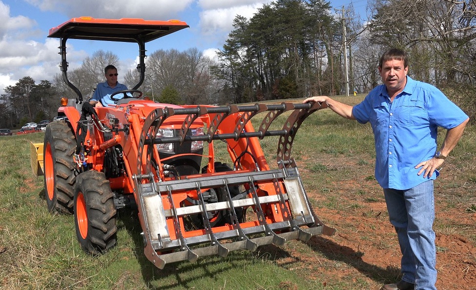

Ah, after looking a little closer at theirs, I see exactly what you mean. Yes, even with our superior material aside and with their gusseting present, our curved, continuous tine is MUCH stronger. We do not piece tines on ANY of our grapples, long or short. Another weakness of theirs is the lids. One side mounted cylinder pushing each lid is VERY stressful. It will cause premature wear and twisting, sooner or later.
Our 239 pound Wicked 55 was strong and impressive right out of the gate. I mean, the very first one survived a torture test with Ted and our L6060.
After that, it was cleaned up, painted and went to live on a New Holland TC.
It is still on it and very healthy to this day!
BUT, as with all EA attachments, we are constantly looking for room to improve things. Since the first one, we have made a few changes.
We increased the outer lid tine thickness to 3/8" and added DOM tubing to the lid and for support through the lower tines(vs. the original bolt in plates).
The current Wicked 55 is stronger and more rigid than ever!!
The 400 pound Wicked 60 you have and it's 660 pound, 66" big bro...
Well, they've been bulletproof from the get go!!
How do we know?
Well, here she is with EA Team member, Nate. :laughing:
Travis

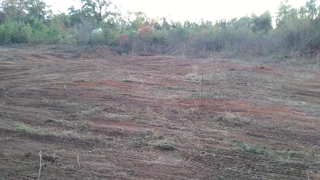

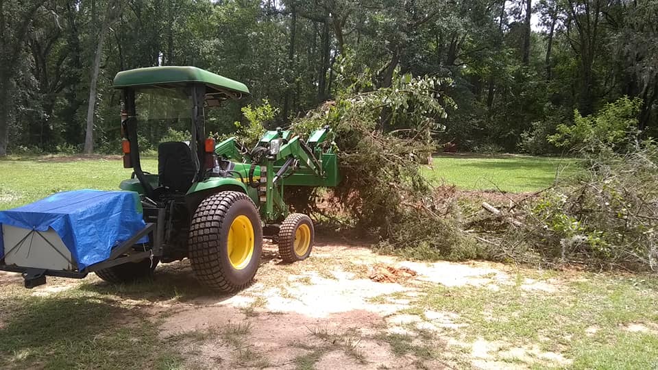

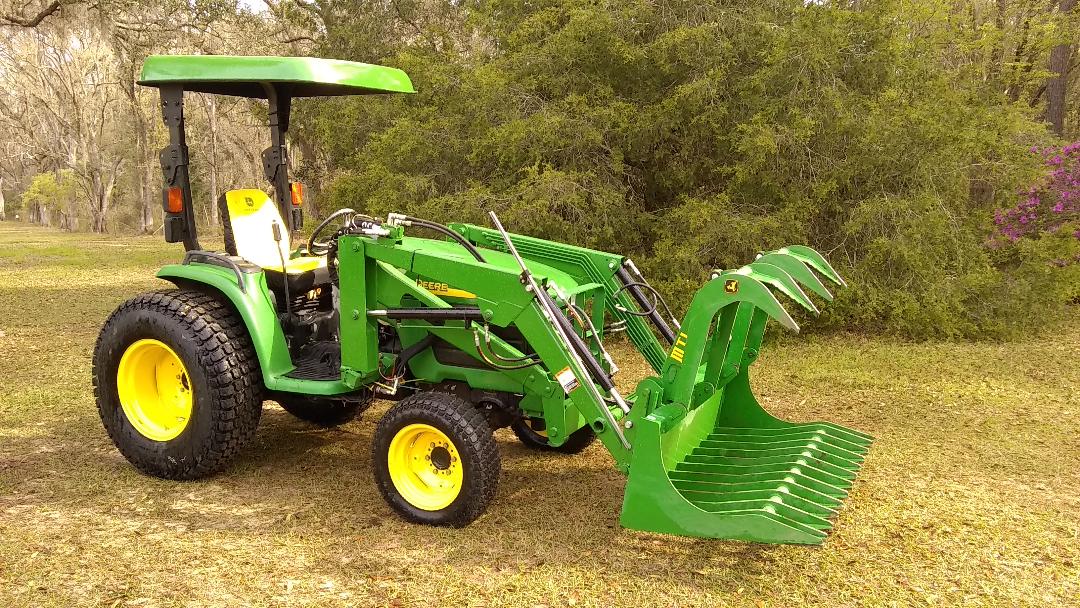

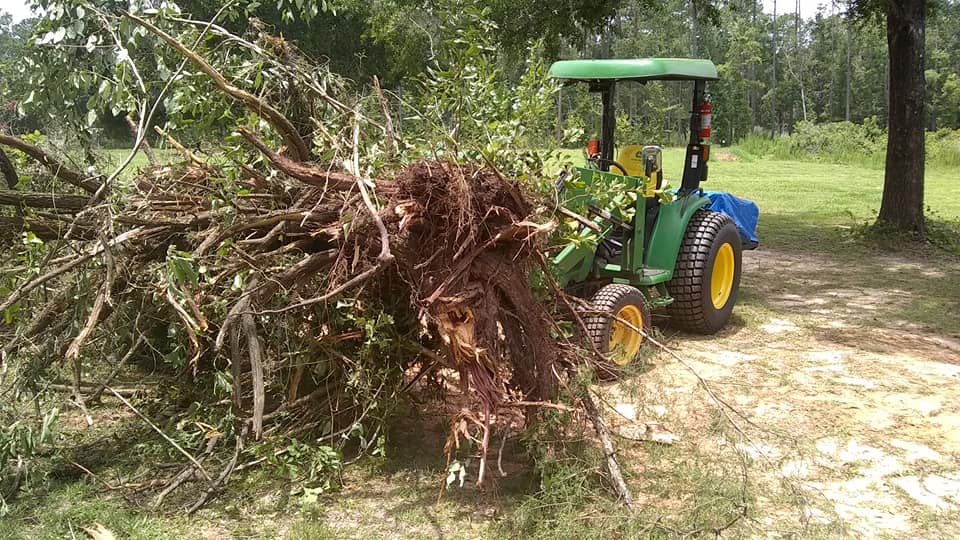

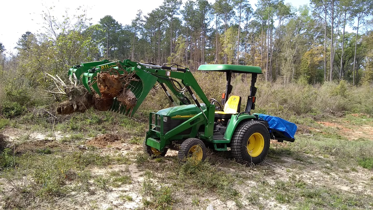

I don't think this is the same model in question but here are some examples of what you can pick up and move with the 60" MTL RK5 grapple and a 32HP tractor rated for 1200 lbs lift.
I paid the extra $60 fee for home delivery so for $1200 total it arrived in my yard 3 days after it was ordered. I wasn't specific about what fittings I needed so I had to make a trip to town and spend another $40 on adapters and couplings to use it.
At the expense of a little extra weight the RK5 has a solid back. This prevents sticks from poking through and you can also do a little grading with it. Not finish grading but you can get it smooth enough to come back with a blade and finish things up.
