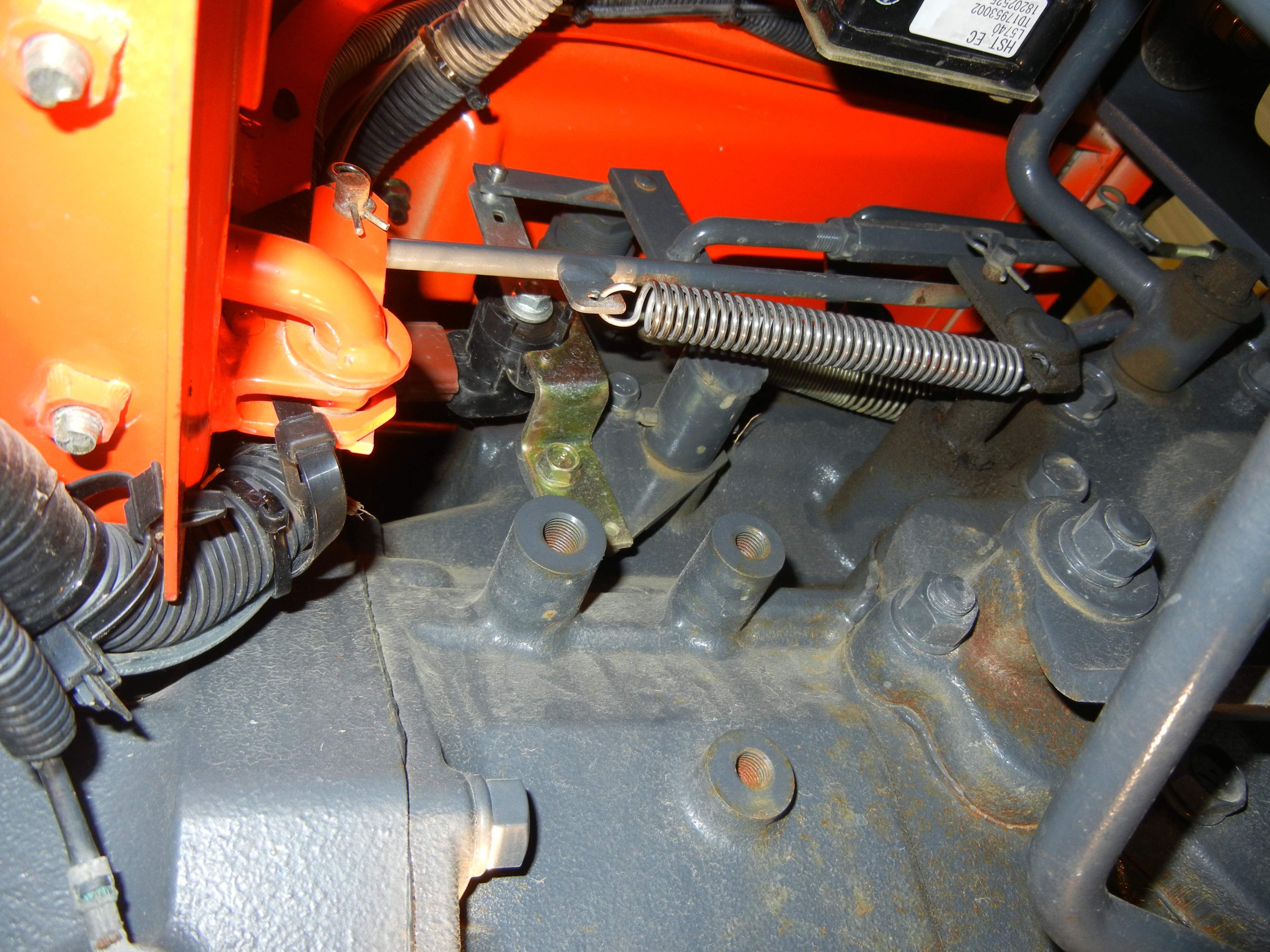

I may be onto a simple inexpensive solution here for us. I removed the diff lock pedal return spring from my L3940 last night, see 1st photo. I then wrote down the specs to the best of my ability, including spring force rate using my fish scale, see 2nd photo. I then ordered a spring of similar size but with half the spring force rate last night from McMaster Carr, see 3rd photo. When the spring from MMC comes in, I will have a baseline to check my orginal spring rate measurment, and make corrections as needed. If the rate of new spring is half the rate of old spring, I will install and report. If changes are needed, I will buy a few more springs and report. Philip.

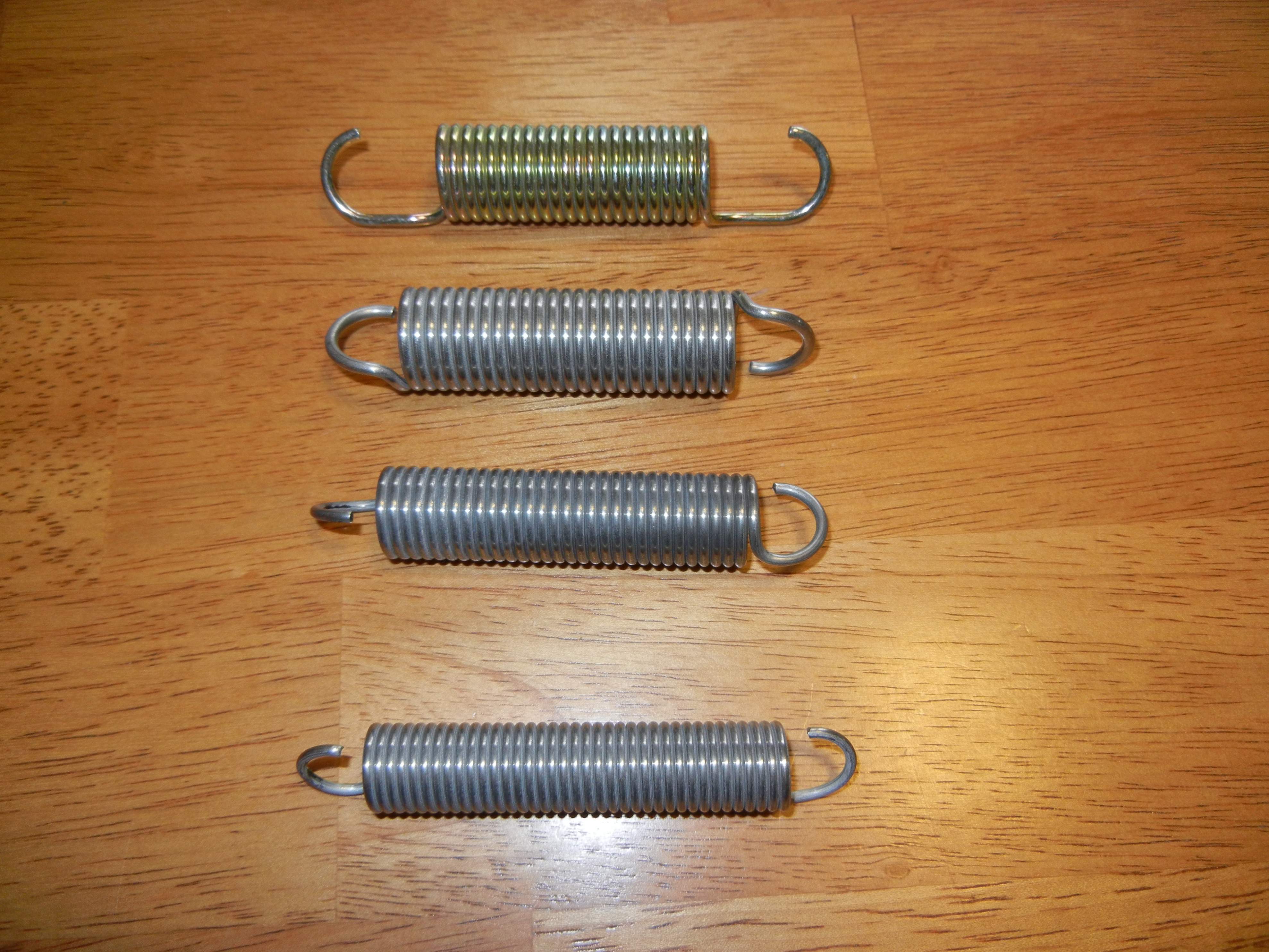

Got results from spring test and installation. I received 3 springs from McMaster Carr, all of 302SS material. All spring rate test were done to same test conditions, 1 inch of extension, force measured with fish scale.
Stock spring, 30lbs/in., .104 wire, .815 dia, 4.21 long.
MMC 94135K34, 22lbs/in, .106 wire, .840 dia, 4.00 long.
MMC 94135K33, 17lbs/in, .092 wire, .730 dia, 4.00 long.
MMC 94135K32, 13.5lbs/in, .080 wire, .640 dia, 4.00 long.
The 1st pic is of all 4 springs sitting together in order listed above.

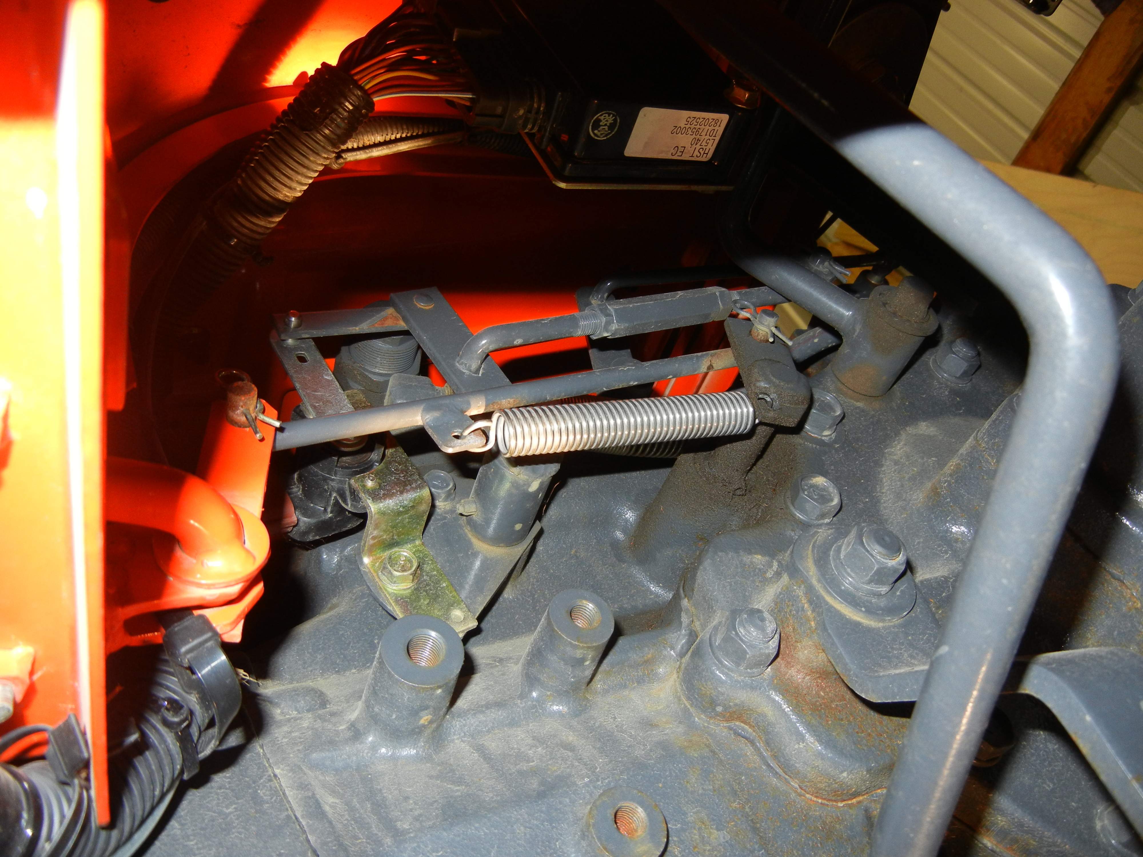

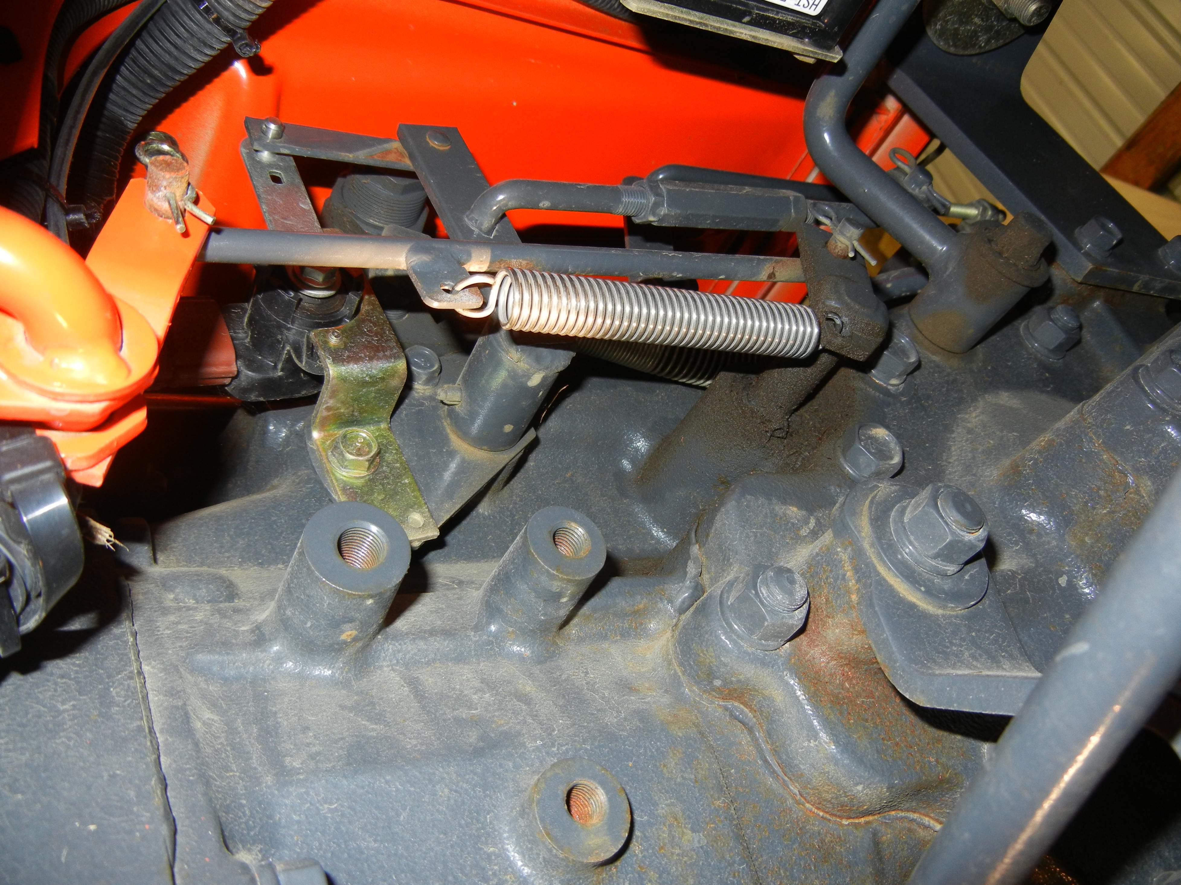

I decided to install the K32 spring. When insalled, spring was still expanded, and pedal was pulled to top limited position. Pusing the pedal down was MUCH easier, but still offered enough resistance so it cannot be done by accident. I have attached 2 pics of spring in normal position with pedal up, and 1 pic of spring fully extended with pedal fully depressed. If you decide to change springs, pull the spring pin from pedal lever to remove and replace spring, this will make job much easier. If you think K32 spring will be too weak, try the K33 spring. They are less than $10 each, so you can't go wrong. I am really happy with the new feel of the diff lock pedal. Philip.
