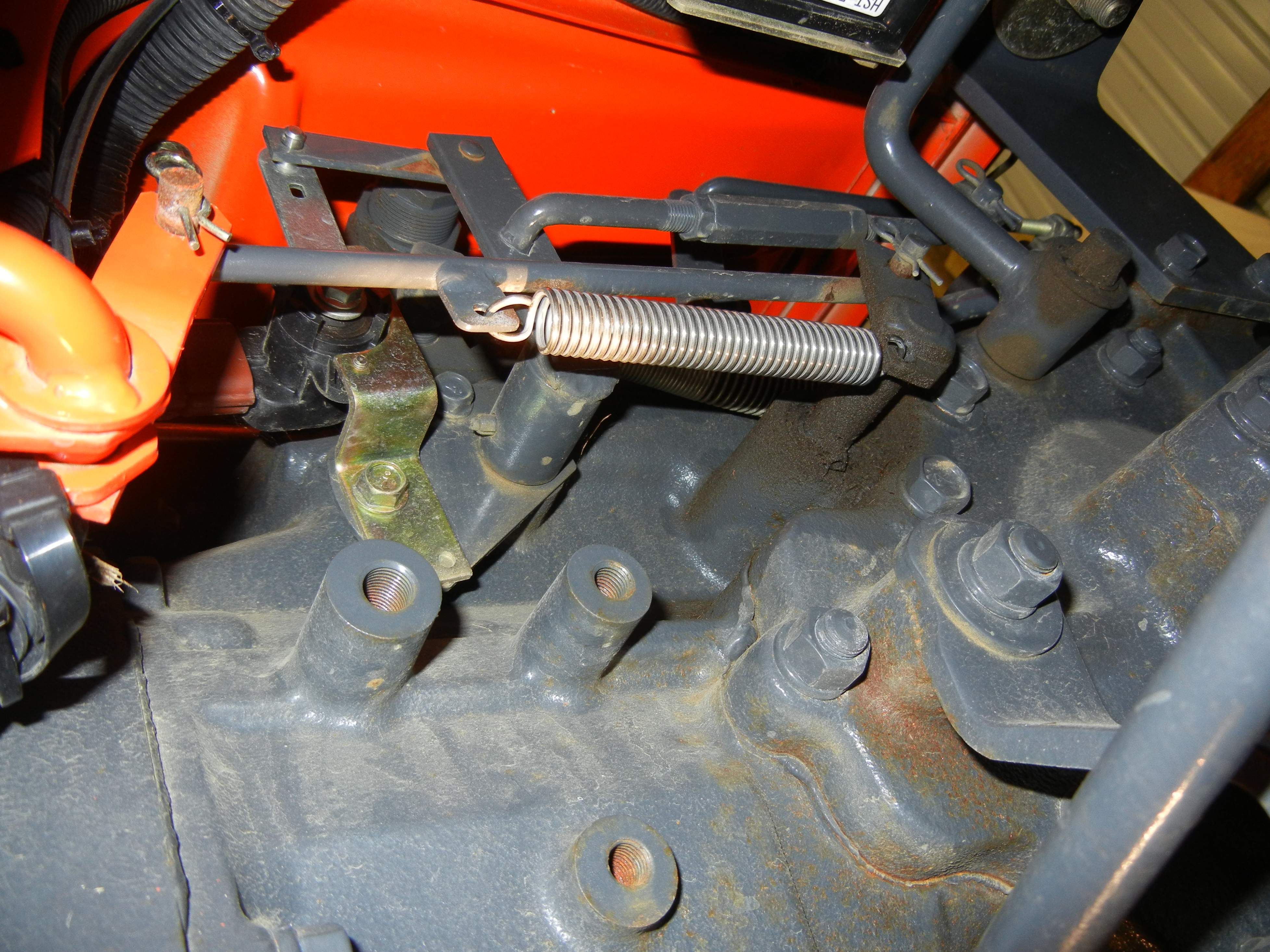

I am convinced. I am going to order one.

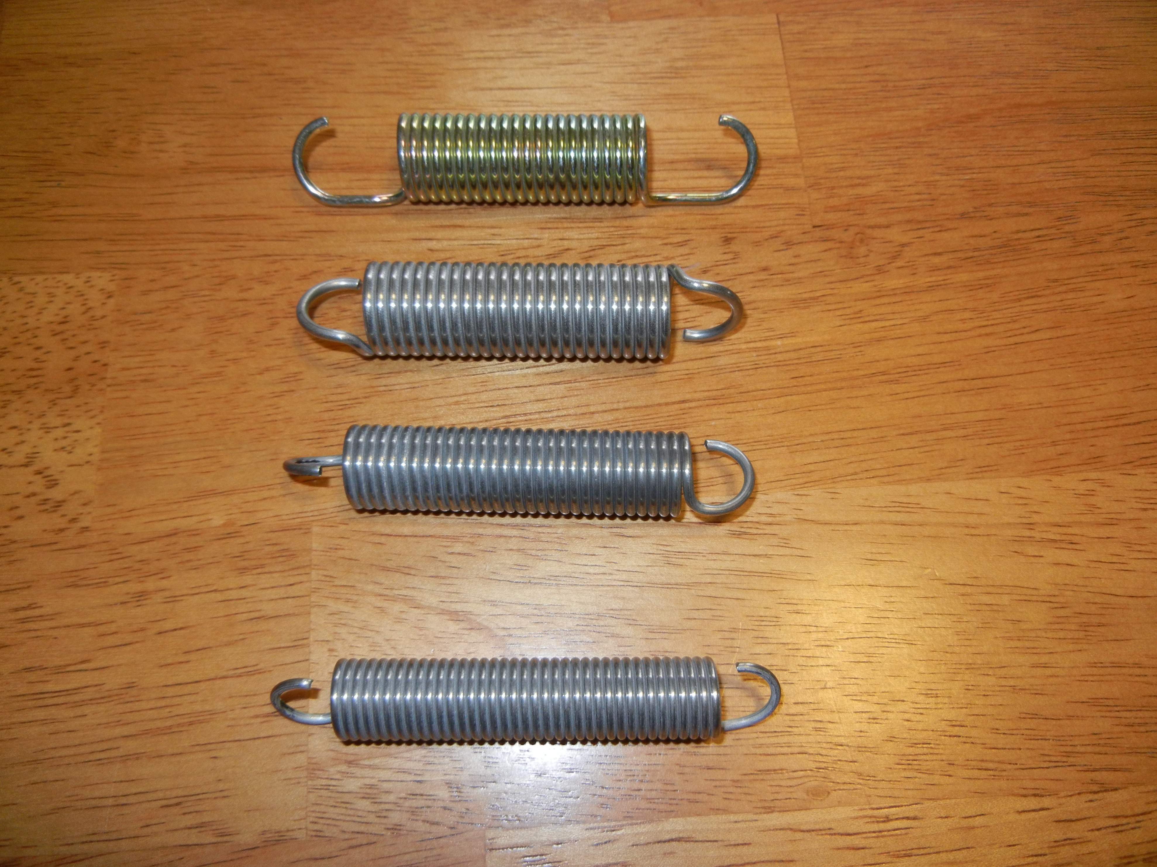

Seems like the MMC 94135K32, 13.5lbs/in, .080 wire, .640 dia, 4.00 long has been tried and is sufficient. Do you think it will hold up long term, or will the lever start to "sag", and then be half in half out.
My inclination is to order the MMC 94135K33, 17lbs/in, .092 wire, .730 dia, 4.00 long one, as it will most certainly be better than what is there and will be a little stiffer than the lightest one. Do you guys think the lightest one is good?
Thoughts?
/ 5740 dif lock lever #42
Thoughts?
Only time will tell. The spring is stainless steel, so environmental conditions should not effect it. The lightest spring has a good feel, and still takes a little resistance to push down. But once the pedal is down, it takes little force to keep it there. When you remove your heel, is comes back up sharply. The springs are cheap, postage will be the same if you order one part number or both, so get both and try yourself! Philip.

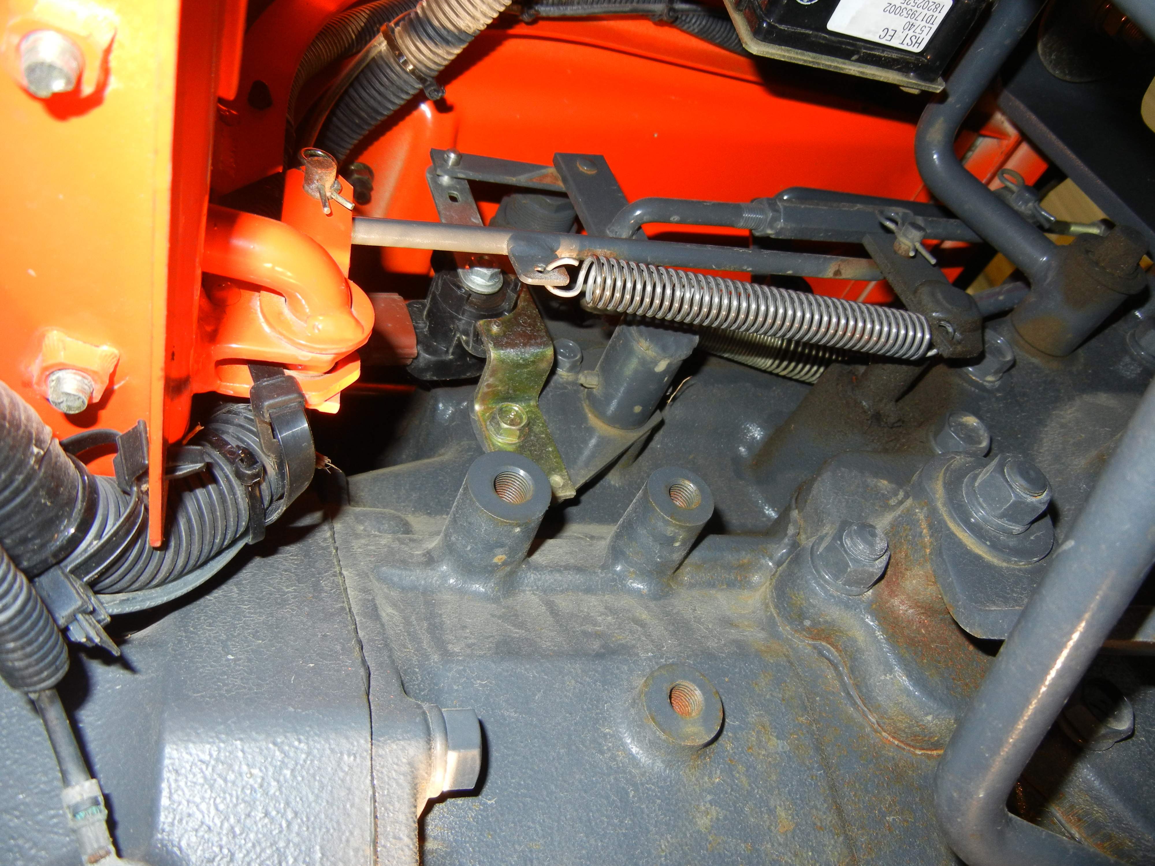

I got the springs and put on 94135K32, 13.5lbs/in, .080 wire, .640 dia, 4.00 long.
What a difference.
If you have any doubts, just do it. It is worth the trouble.
Thanks for the suggestion.

I know I am reviving an ancient thread but made this mod on my L3560 and it makes a world of difference. Had not seen it until it was linked to in another thread. Maybe someone else will notice it if its gets bumped to the top.

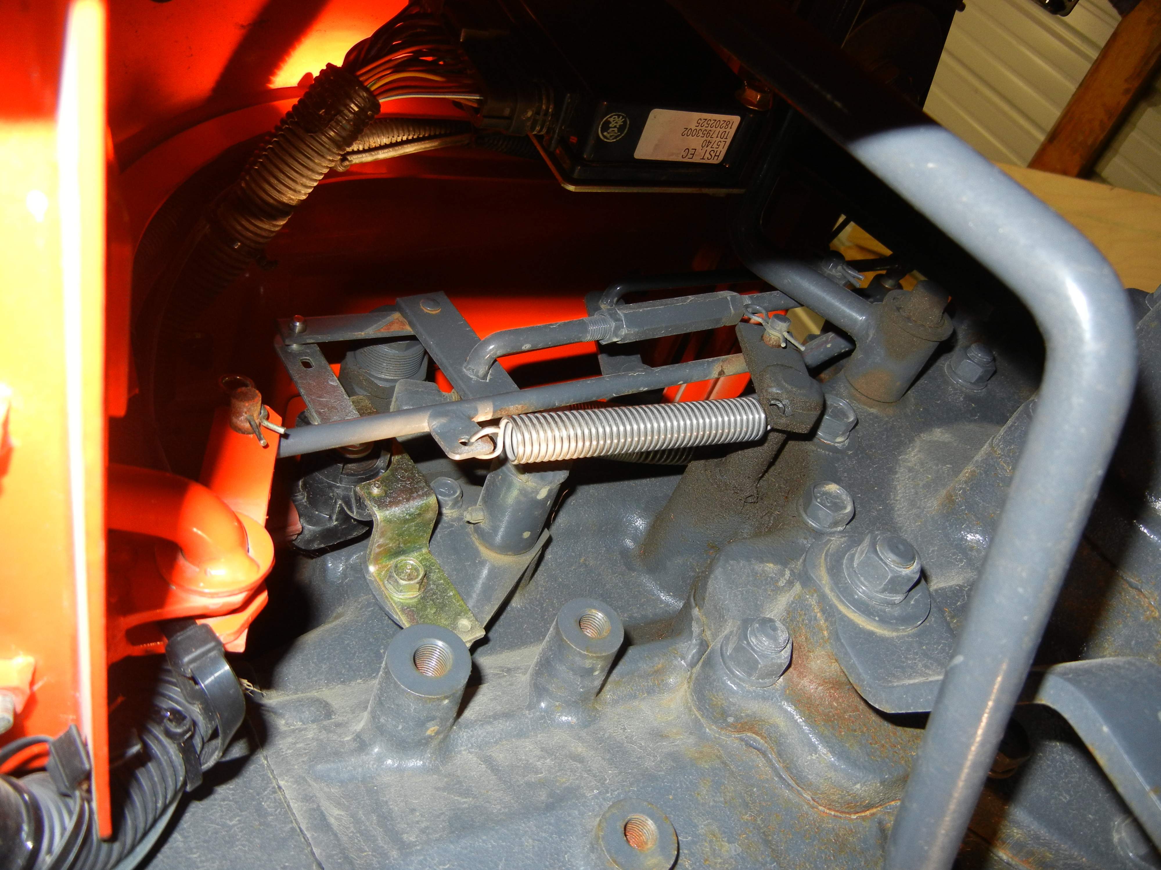

I am the one who did the original modification in December 2011. Everything has held up fine and have not touched a thing since the modification, works very well. Philip.

I guess better late than never just did this on the L5240. Lot of difference in the springs. I always hated that strong spring. Good quarantine project. Thanks PHILIP8N for posting it.

I know I am reviving an old thread but I wanted to thank Philp8n. I ordered the spring like he did for my Grand L 5460. It worked like a charm. I did pay almost $24 for spring (actually 3 as that is how they are sold) but oh my what a difference. My differential lock actually works. Now if I had a pedal instead of a round rod I would be set. This is a terrible design on Kubota’s part. I looked at a couple of local places to try and find a spring that would but couldn’t find a suitable spring. It was worth every penny.
It’s ashame I had to modify my top of the line tractor to function almost as good as my former Mahindra 2615 which was a bare bones tractor but it had a differential lock pedal that didn’t require a ton of force to engage.

I must be doing something wrong. When I put 94135k32 in, spring of the same spec except 8.45lb/in. ??? Pack of three $12.76
