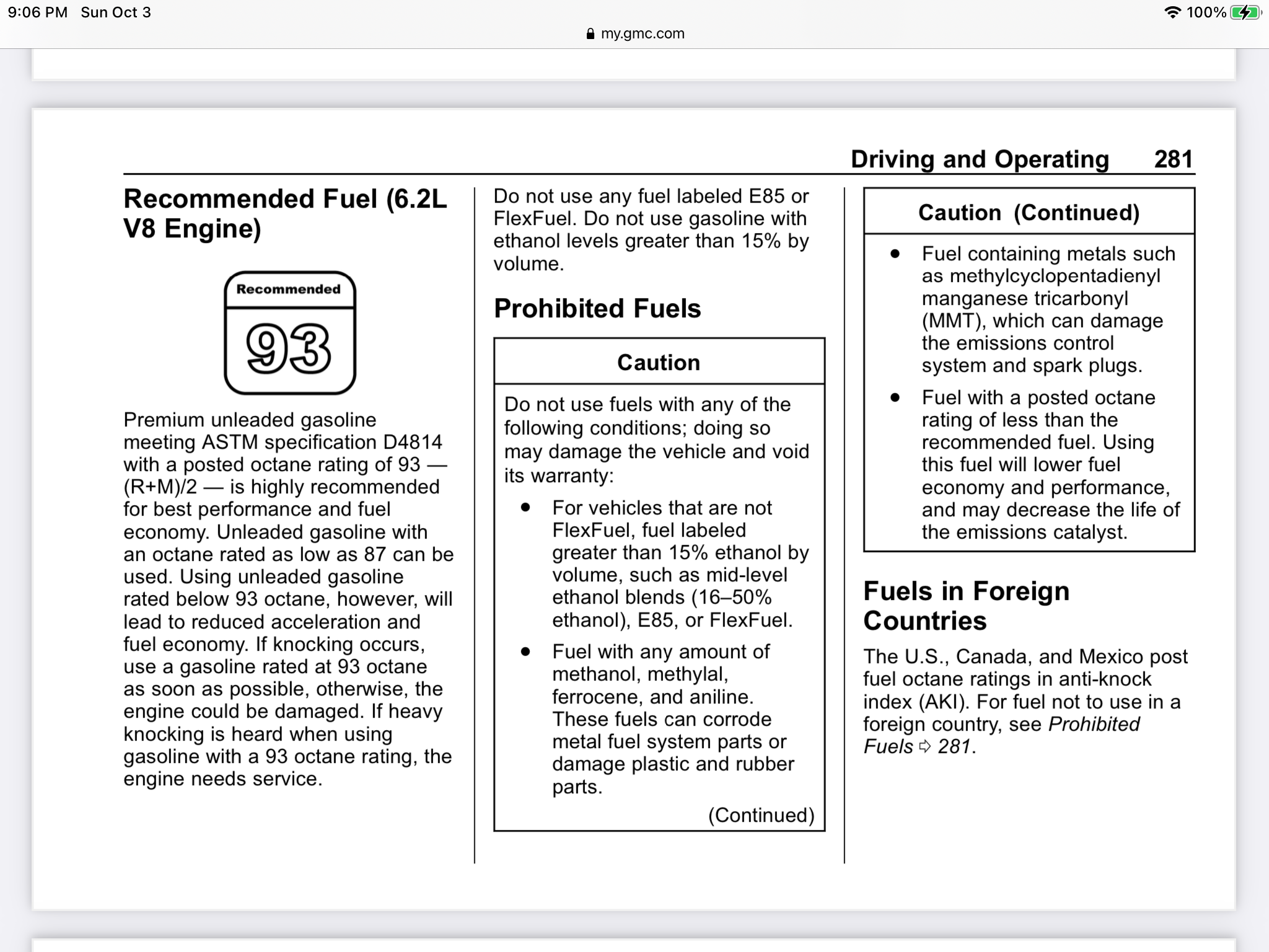

In a truck application, I will never own a GM 6.2, no need nor use for a truck engine that requires premium fuel, especially at $5.96 a gallon.
Actually the owners manual states 93 oct.fuel preferred NOT required in the 2020 Yukon with the 6.2 motor.$5.96 for imperial gal.I assume? It's $3.85 per gal where I live.
No, $1.583/L which is $7.20/Imperial gallon, $5.95/US gallon.

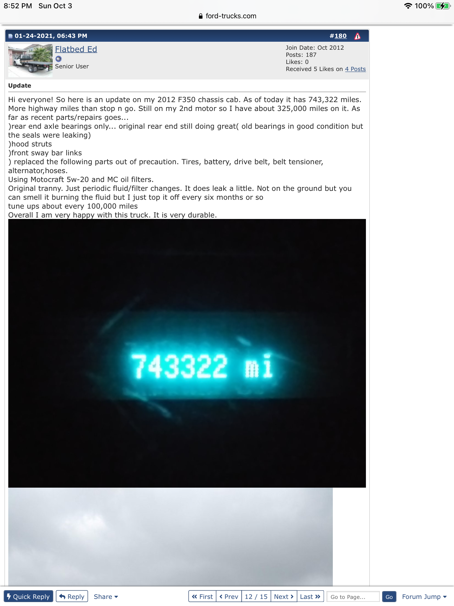

There are several Ford 6.2L commercial vehicles with over 300k miles on routine maintenance. “Flatbed Ed” got around 417k miles on his first 2012 F-350 6.2L engine. He reported over 300k, on his second engine, earlier this year. When he posted that, he had nearly 750k miles, on the chassis and original transmission. He is a hotshotter, from one of the Ford forums.
It also says using less than 93 octane will lead to reduced acceleration and fuel economy. Yes, you can use 87 octane and the engine will ****** timing, so it will run. However, it was not designed for optimal performance, at that octane and ignition timing, so it’s costing you, somewhere. In extreme cases, it can even cost you an engine.
I run 93 octane in my Yukon and my Dodge challenger because I am NOT cheapskate but thanks for that great advice.;)

Was not a big fan of the ford with 6.2 my 2012 was a turd for pulling power compared to my 2016 ram with the 6.4 hemi.Both had 3.73 gears.
