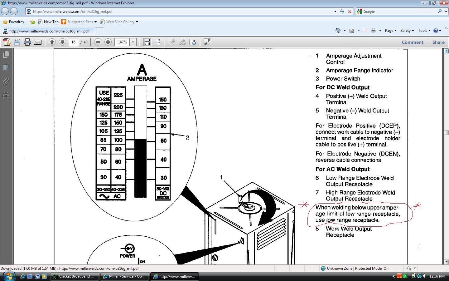

.... One thing I recently learned from an old welder buddy of mine. On your welder if you have multiple ranges select the highest range (highest voltage) then adjust your amperage to the desired level....
Well this is totally wrong advice in many cases so you may want to seek advice from a different buddy. The proper answer is that it depends on the welder that you have and how Volts to Amp curves are set-up between the ranges for operator choosing the proper range with the easiest initial arc strikes. There may be some welders that have higher OCV in the high range, but there are also many welders that have higher OCV in low range. The higher the OCV the easier the initial arc strikes will be.
Take a look at these excepts from the Miller Thunderbolt manual for example (Miller Thunderbolt is probably the best selling welder of all time that incorporates range type settings. Lincoln Tombstones outsold the Miller Thunderbolts, but the Lincoln buzzboxes do not use ranges as they used a simple selector switch which inherently picks the best range within transformer automatically for you).

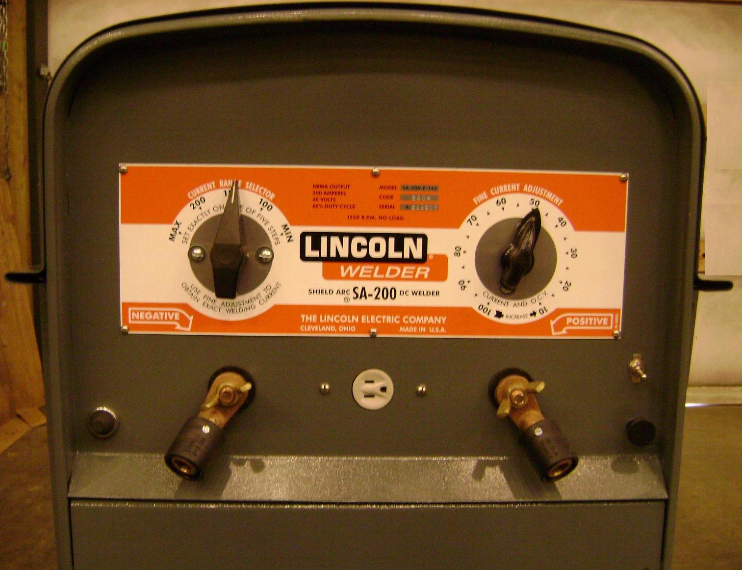

The majority of my welding experience has been with engine drives. Can't think of an engine drive I've ever run that this didn't apply. If you want high open circuit voltage which will give you easier arc starts and a wetter / buttery puddle, set the fine control knob, (right hand knob in picture) on the higher settings. If you want lower open circuit voltage for a drier / stiffer puddle set the fine control to a lower setting. Generally for vertical and over head you'll want a drier / stiffer puddle.
Right out of a Lincoln operator's manual.
