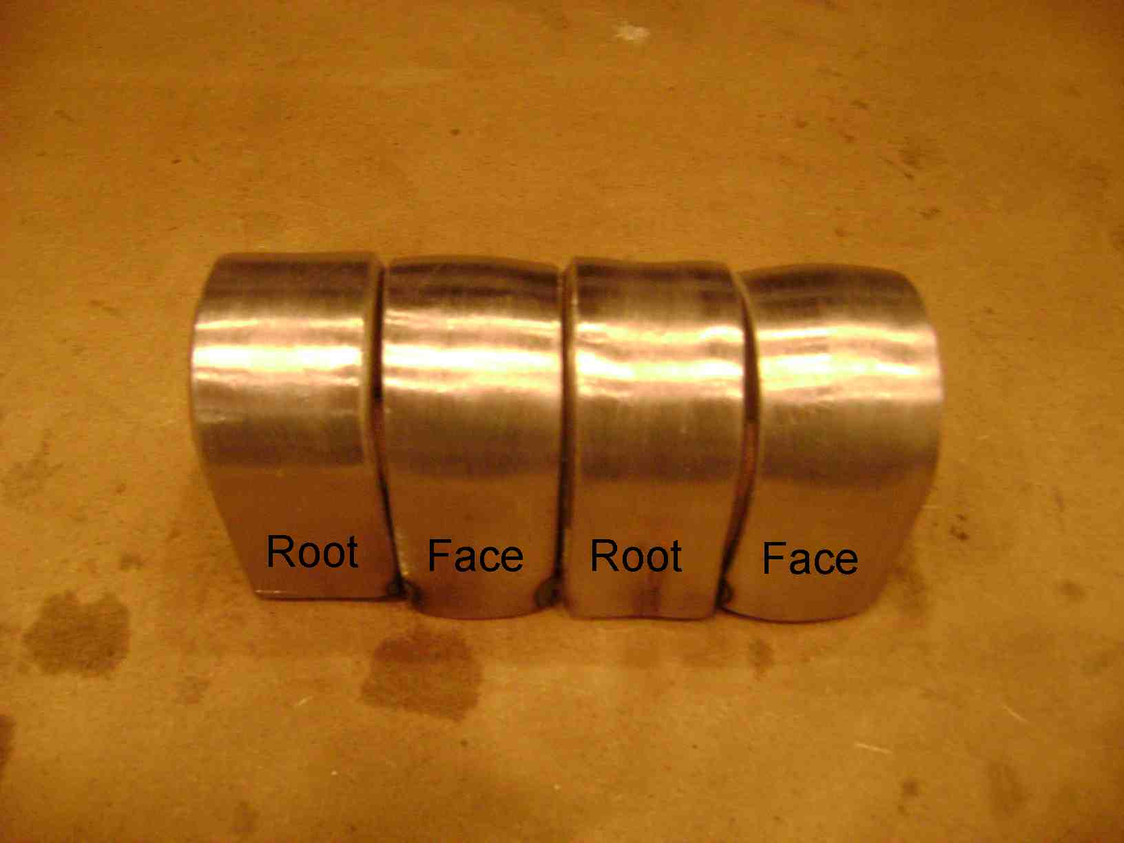

Big Wave D can I ask why you think you need more strength?
I'm always more impressed with yield strength than tensile. I just looked in the Lincoln pamphlet I have, the strongest 6011 has a yield of 73,000-psi, where as the weakest 7018 has a yield of 77,000-psi.
Here is a test I did for another site, I welded up a piece of pipe, (5-G) with 1/8-inch 6011, cut and preped the coupons / strips and bent them 170-degrees. Personally for us weekend warriors bending a weld like this and not seeing any flaws is good enough. Again what project do you have coming up that would need more strength than this?

I guess that if the steel we usually use fails at 30K something PSI, then I guess it is a moot point whether the metal will fail at an extra 10K psi lower than the weld do to the rod used, 60XX vs. 70XX.

Maybe I should clarify what I mean about being a weekend warrior. Just speaking for myself now, I don't do any critical welding anymore. Oh sure I'll build a trailer hitch, or a gooseneck trailer every once in awhile, and not give it a second thought.

Sorry I can't keep track of who's who, but are you ready to rebuild a trailer hitch? I always raise an eye brow when someone on these Internet forums wants to build or modify something that goes down the highway. Don't mean to insult you in anyway. I know if someone questioned me about building a hitch or trailer I'd be pizzed!
