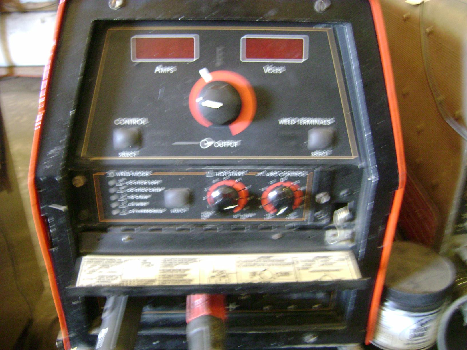

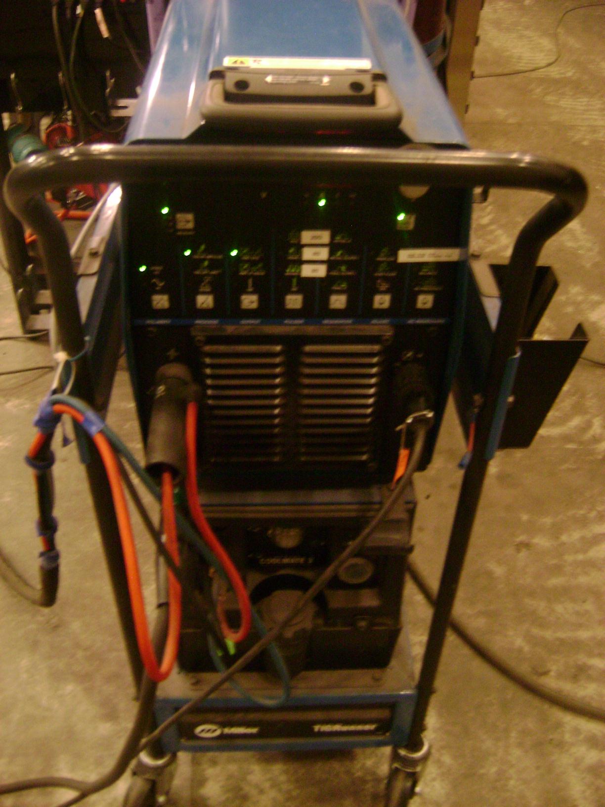

Well Shield Arc, now you've gone and done it. Here I was, dumb and happy with the free Lincoln AC-225 I'd been given for free. Now you have to show me that life gets MUCH better with 2 knobs. :D
It's totally unimaginable to remember ever machine I've run in my lifetime, but I'm confident I've never run a Tombstone or a Thunderbolt. I have seen them, just never had the opportunity to run one.
If you want more dials and knobs you could always buy one of these.;)

Shield Arc,
From your pictures, the 2nd set, are you welding or performing open heart surgery? :D:laughing::laughing:
M-a-y-b-e a step up from what I presently own. How many digits go in front of $___K to buy one of those??? :confused2:

Shield Arc,
Surgery?:laughing: No, but thank you for thinking that! I'm just a hack / hobbyist.;)
To replace that blue one, you'd need a 9, and 3-zeros +. The red one you'd need a 3, and a 5, and 2-zeros. :D
