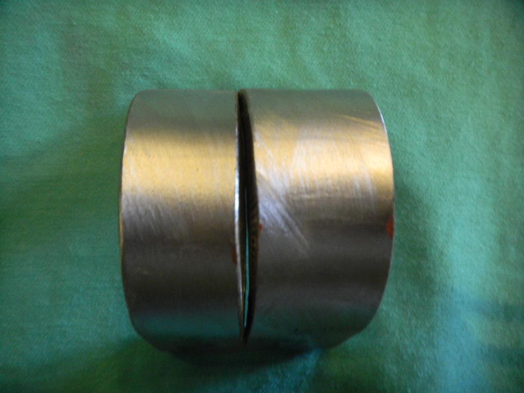

weldermike I know exactly what you're saying. Realistically the test doesn't prove a thing, too many variables, like the amount of force applied by my arm. I just thought it was strange that 6013 broke so easy! But passed a coupon bend test. My understanding of the fillet weld test was just a quick and easy way to see the inside of the weld. I know when Innershield wire came out we had a hard time learning where to set the machines. We used engine drives for power source, with a wire feed. We would adjust the machine to the best of our ability, then run a quick and dirty fillet weld test so we could see the inside of the weld just for a looks see.
Here's the 6013 bend coupons.
