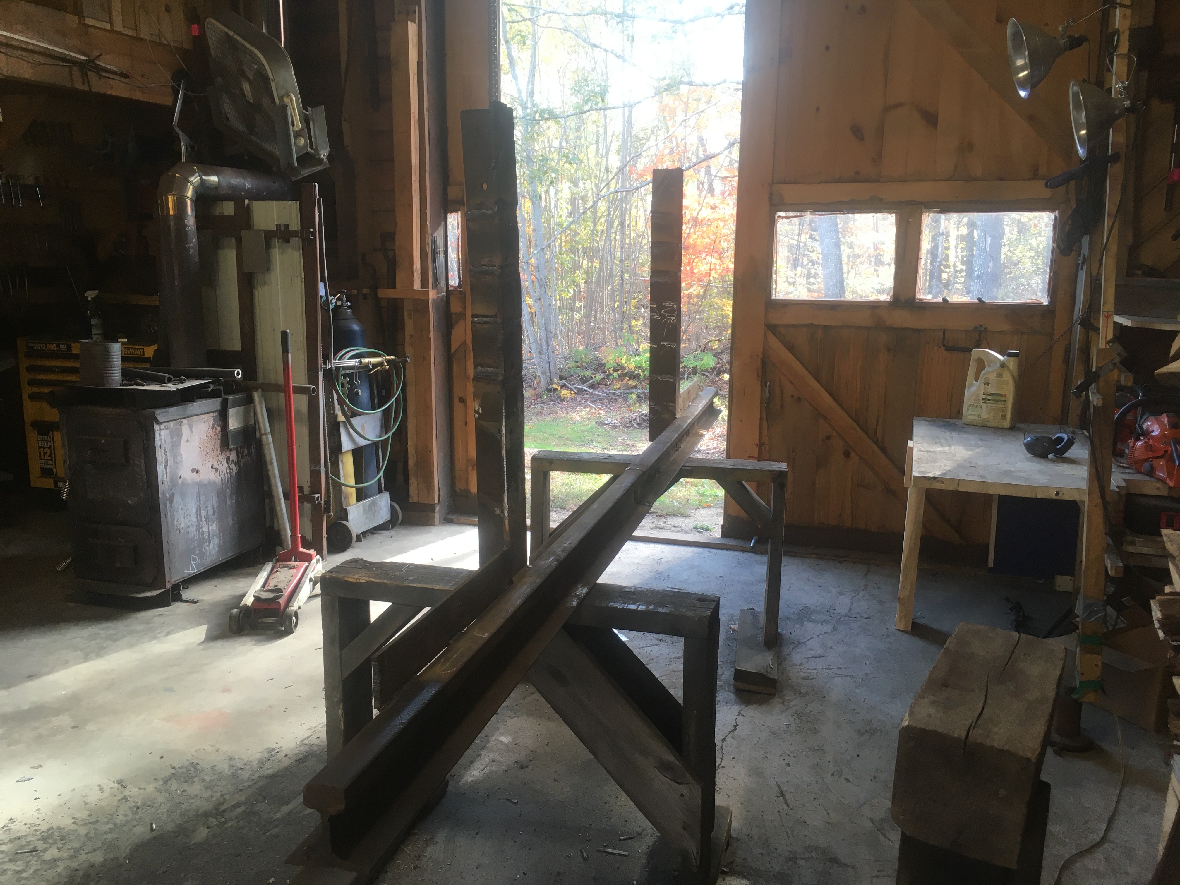

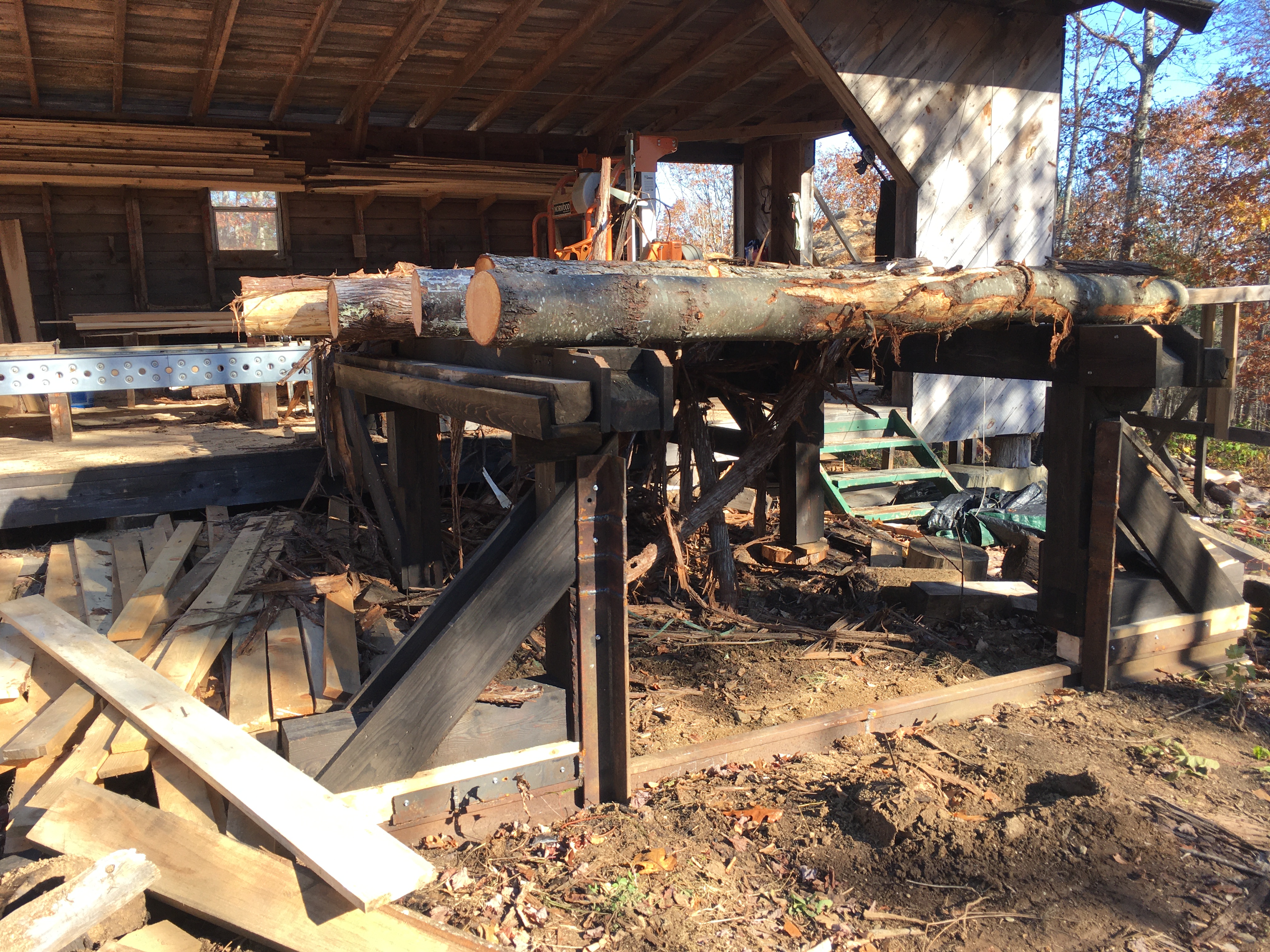

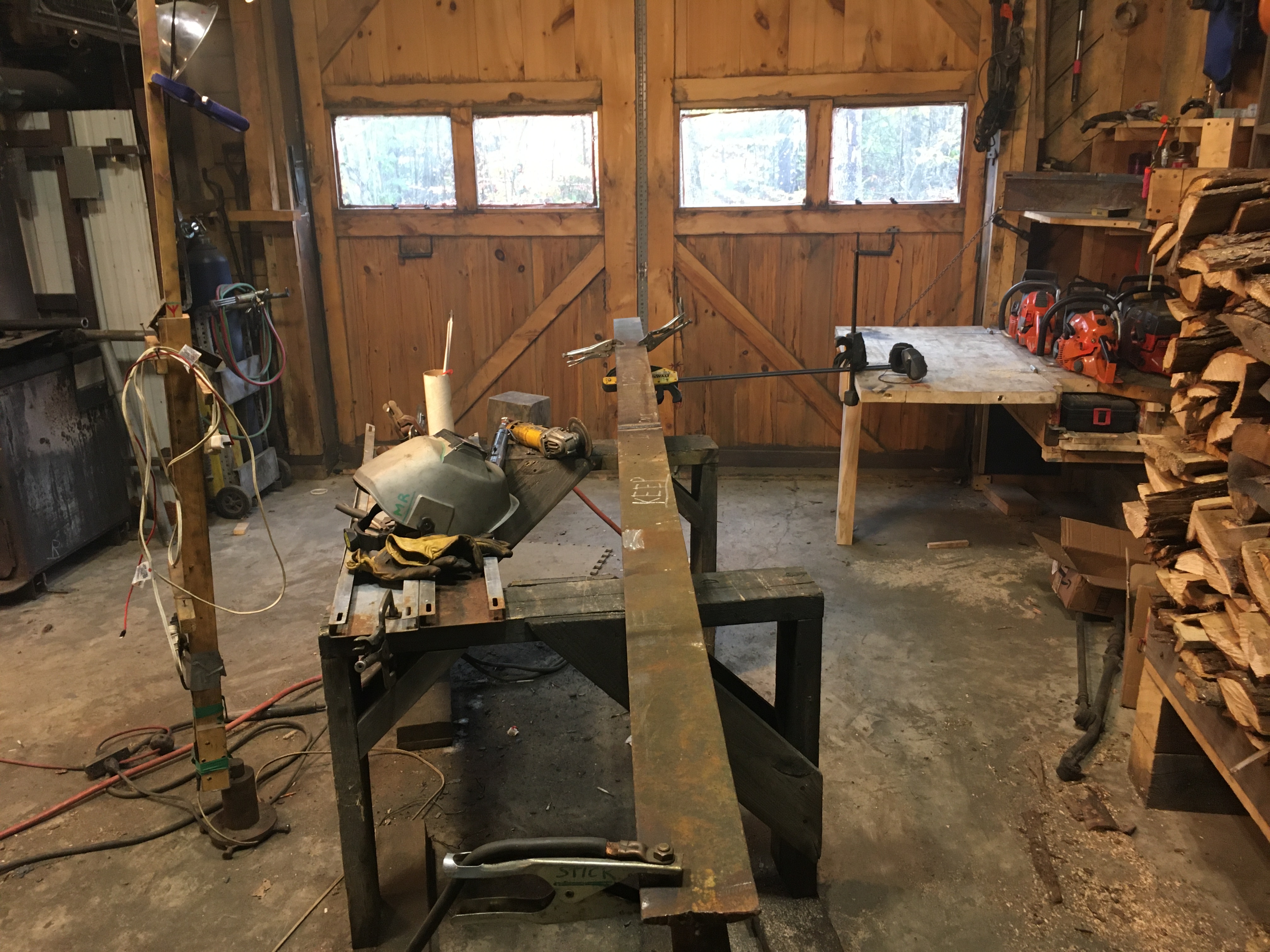

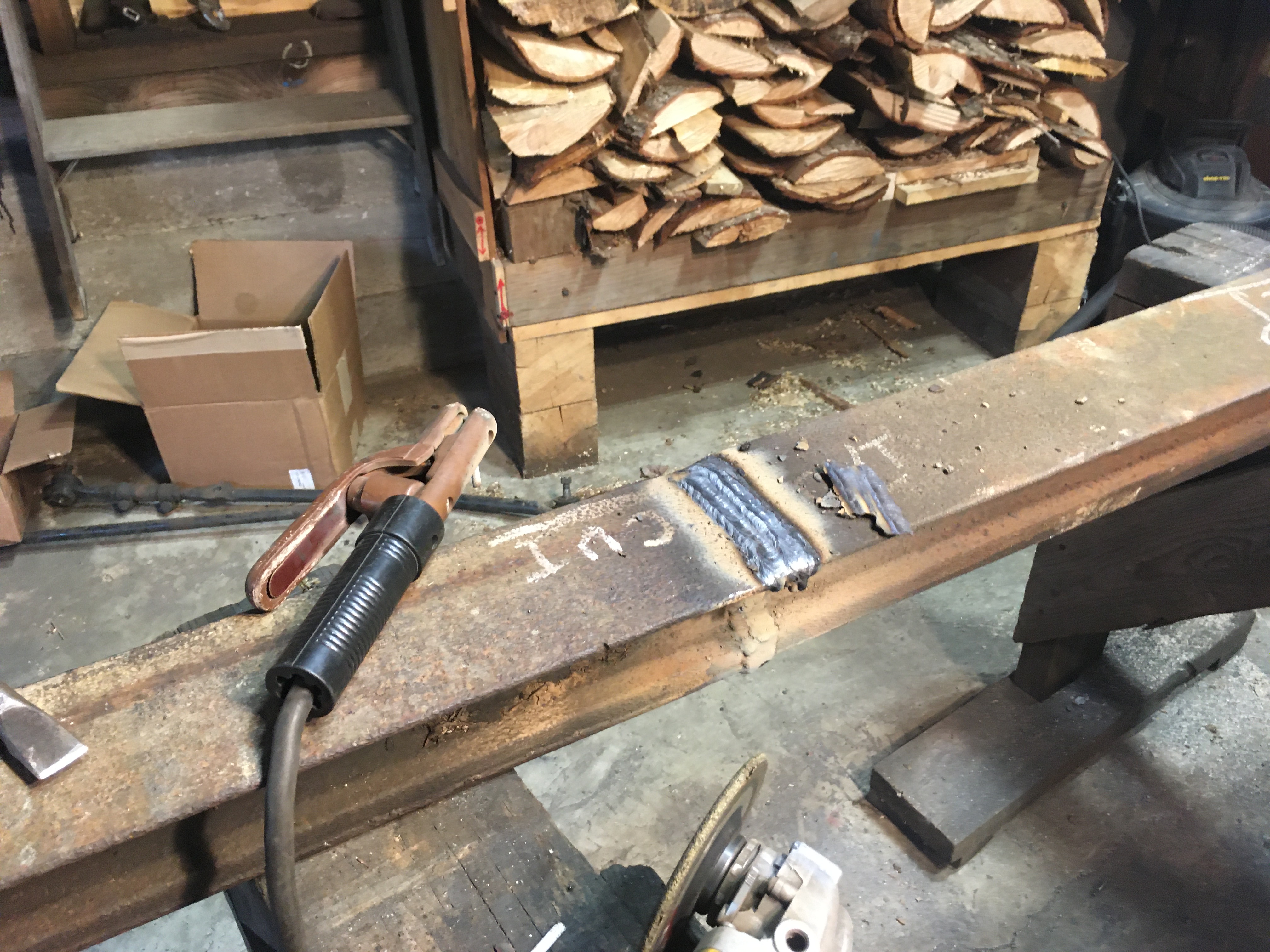

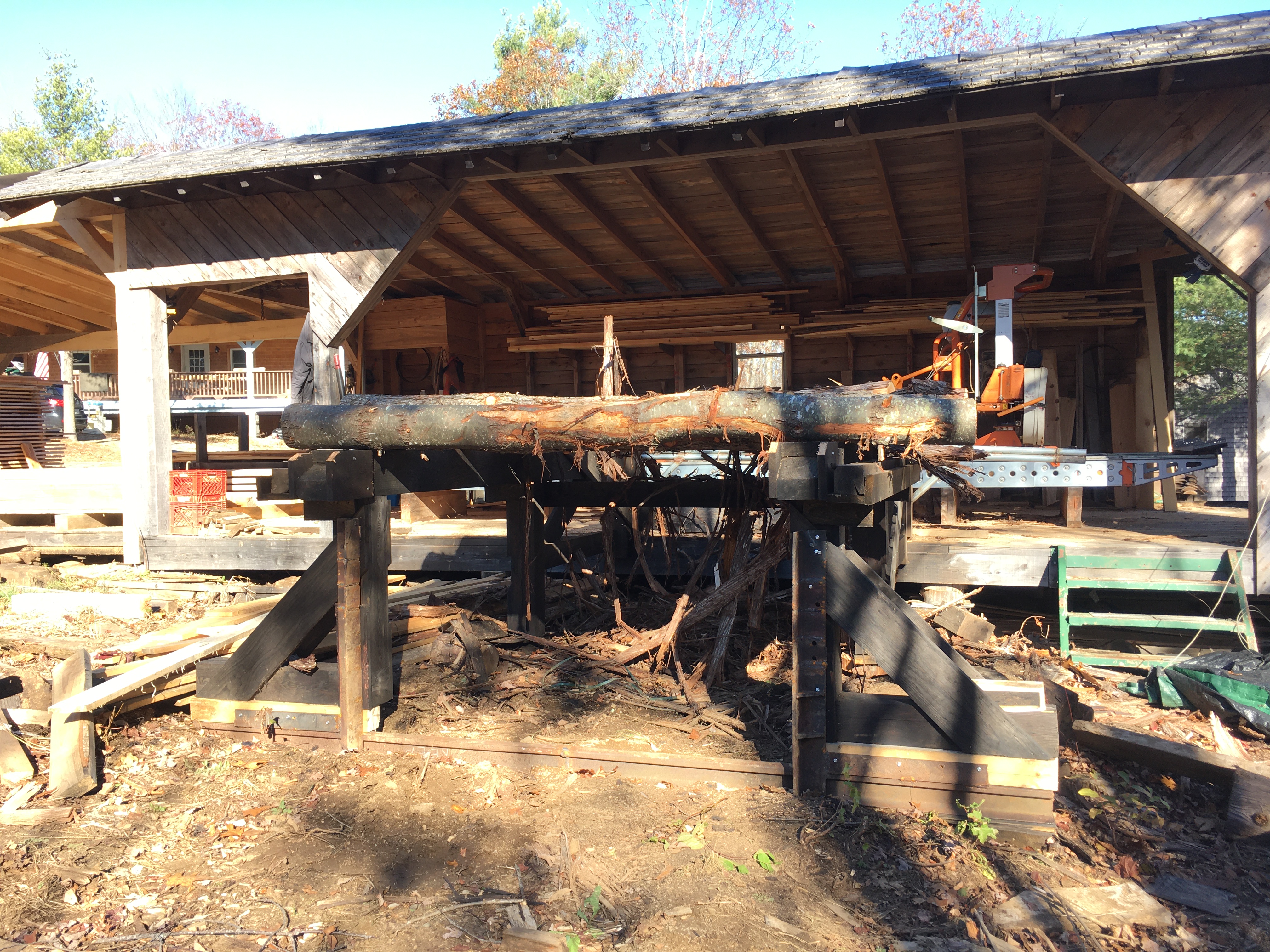

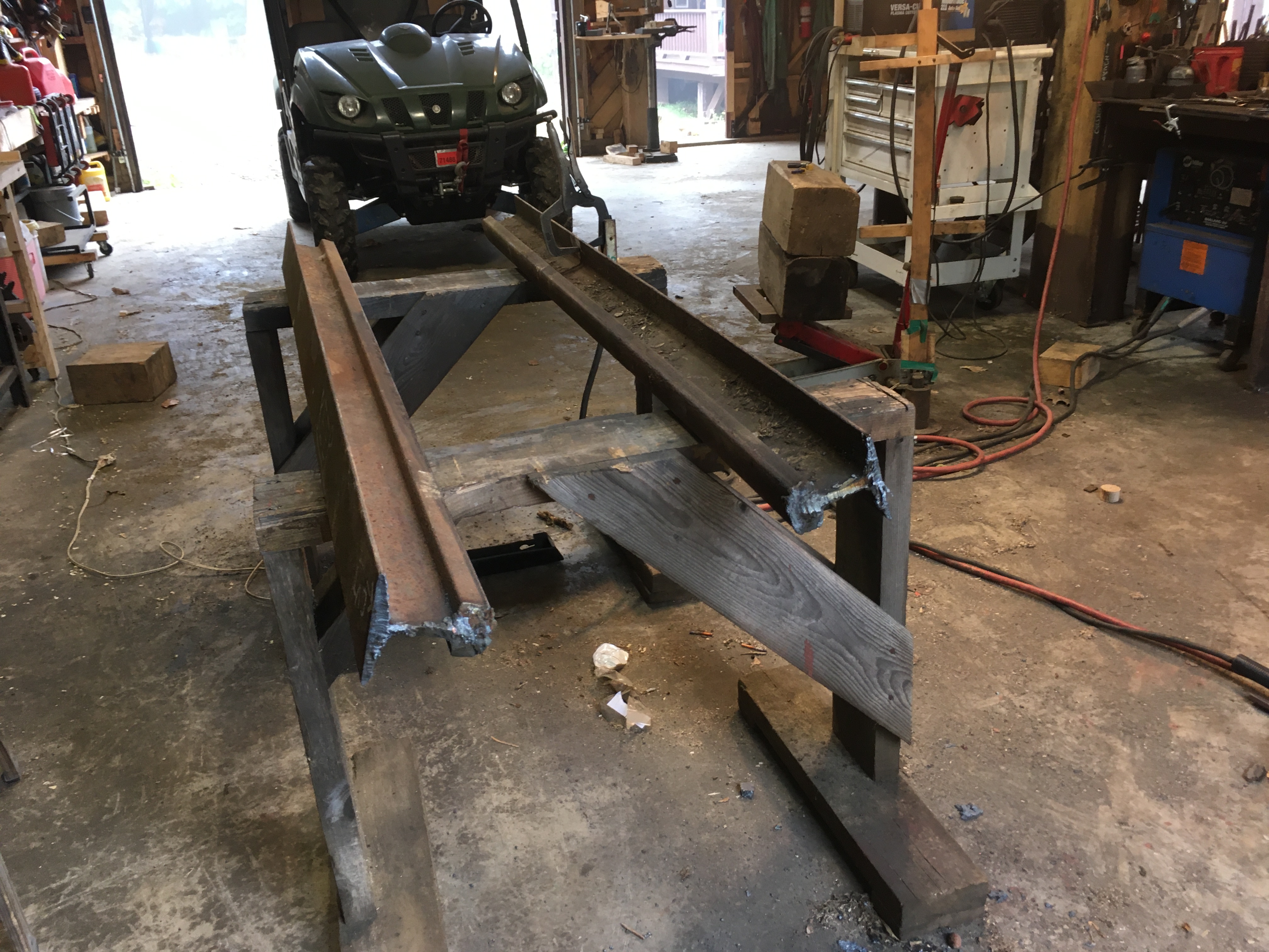

I forgot wear I posted this railroad iron brace welding job I did, but the brace was put in place two weeks ago and tested today.
Back gouging steel - YouTube
Gouging weld off - YouTube
L34OO moving big log - YouTube
