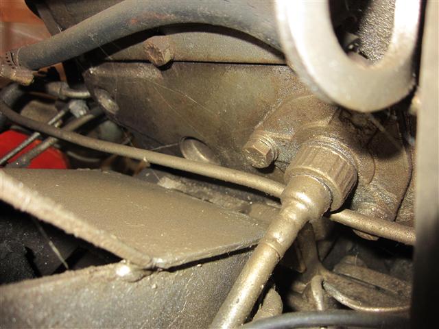

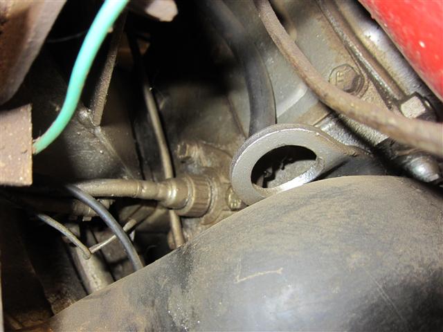

My 1964 MF135 diesel has had an alternator installed (Delco Remy 10si) in place of the original factory generator. The tach cable plugs into an adapter plate that's located on the top right rear end of the engine block.
None of my 135 manuals shows details of what the tach cable attaches to at this location. Flywheel ring gear maybe?

I've got a shop manual comming in the mail, till then I've been researching here and other places as to my alternatives. I'd only be guessing as to what that proofmeter is driven from on your engine block. Some tachs are driven off the oil pump gearing, but on a tractor I'd be guessing.

Most 3-152 and 4-203 used camshaft adapter for tach drive. All Continental used gen or alt gearbox tach drive, Perkins 4-212, 4-236 and 4-248 did too.
