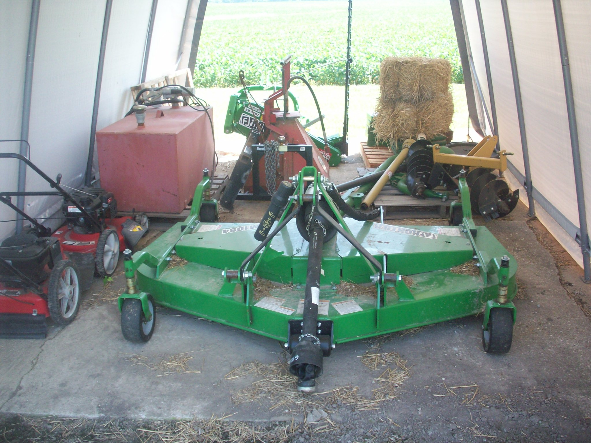

I have a 7 foot Frontier finish mower and it works very well.
They are avaliable thru your John Deere dealer.
www.buyfrontier.com
