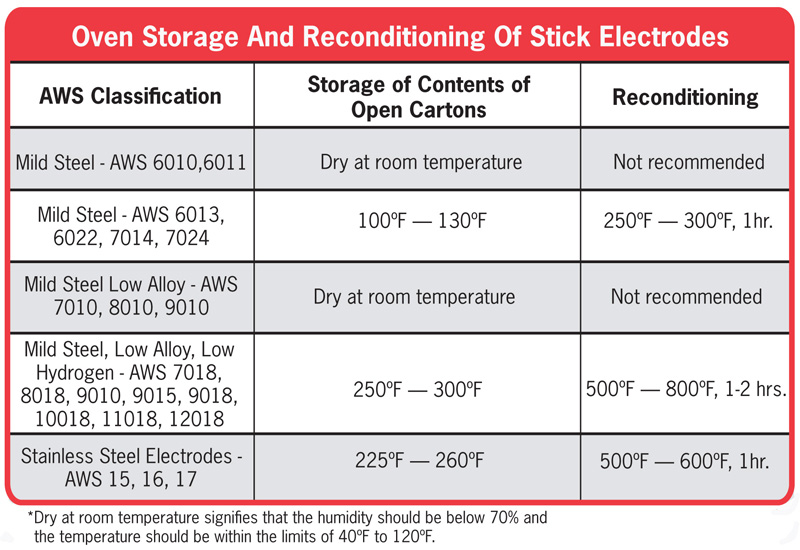

For probably 98%+ of the projects welded on here, hydrogen cracking won't be a concern and 7018 only needs to be in an oven when doing critical code welding. It has to be kept dry and away from moisture but you don't need to go out and buy a rod oven. It does burn nicer out of an oven though. As far as burning it colder and going slower to get better fusion, that's a contradictory statement. Burn it where it flows properly.
/ 7014 rod #24

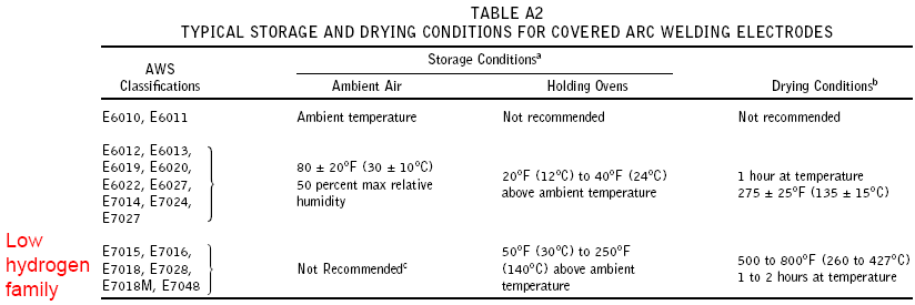

LH rods or any rod with a coating that contributes to the weld metal pool needs to be stored dry and preferably heated to above 250F.
I would respectfully disagree with part of this statement. All rods need not be stored in an oven. 6010, 6011 are specifically not to be stored in an oven.
Storage temp for several rods is well under 250F.
Clearly you are correct that LH rods should be stored in an oven - but I contend for normal home use it's not critical.
Here is a couple sample tables on the topic of temperature (for those that have not seen them).
/ 7014 rod #25
Well, this is interesting.
Everyone knows, or at least should know, that LH rod like 7018 need to be heated in an oven to be code compliant.
But, I had no idea that non-LH rod with a coating that adds to the weld metal, could cause hydrogen embrittlement. And the fact that they would need to be kept dry, preferably heated to above 250F for an hour, is very seldom complied with.
For some non-LH rod to cause hydrogen embrittlement to the point of failure, must be pretty rare.
I can understand it more with 7014 & 7024. But that 6013 might need conditioning, is really a shocker. I'll bet there's been many an old farmer that have repaired their implements with their old buzzboxes and damp 6013's. :)
/ 7014 rod #26
That's not what Gary said, he said low hydrogen or any electrode where the coating is incorporated into the weld metal (like 7024, 8024 etc). Gary's post would exempt 6010 and 6011 from going in the oven
