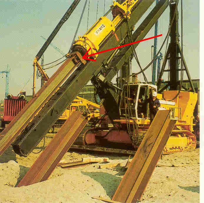

I use to run a lot of Super-Missile rod repairing cast steel pile driving equipment. 312 Stainless steel rod is basically the same thing, but cheaper. This piece of equipment that the red arrow is pointing to, takes a beating. We have driving pile all day, and I would stay late into the night repairing these.

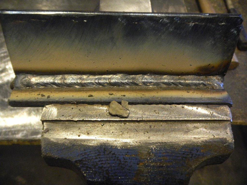

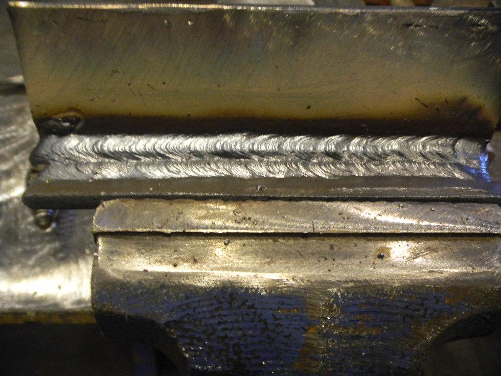

The pictures I posted in post #8 are DC 7018 rod run on an AC buzz box. What I found running DC 7018 on an AC buss box is it doesn't wet out like on DC.

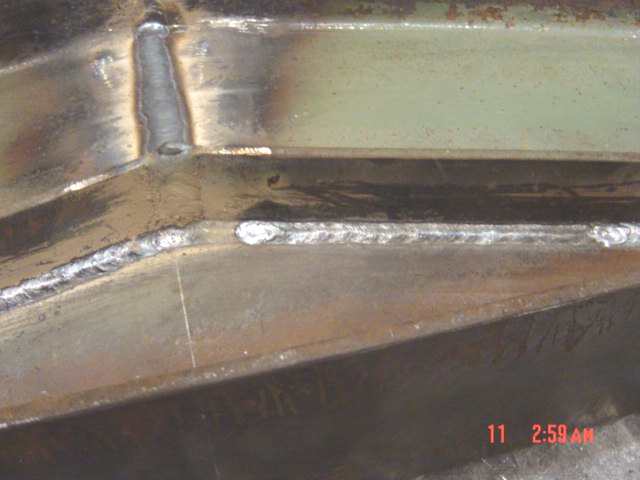

These are DC 7018 run on a DC welder.

First picture is 7018 run on a AC buzz box. The second pictures is 7018 run on a DC welding machine.
See how the DC weld is much smoother, and more flowing lines to the weld? See how the AC weld is choppy, raged? That what I mean by wetting out.
