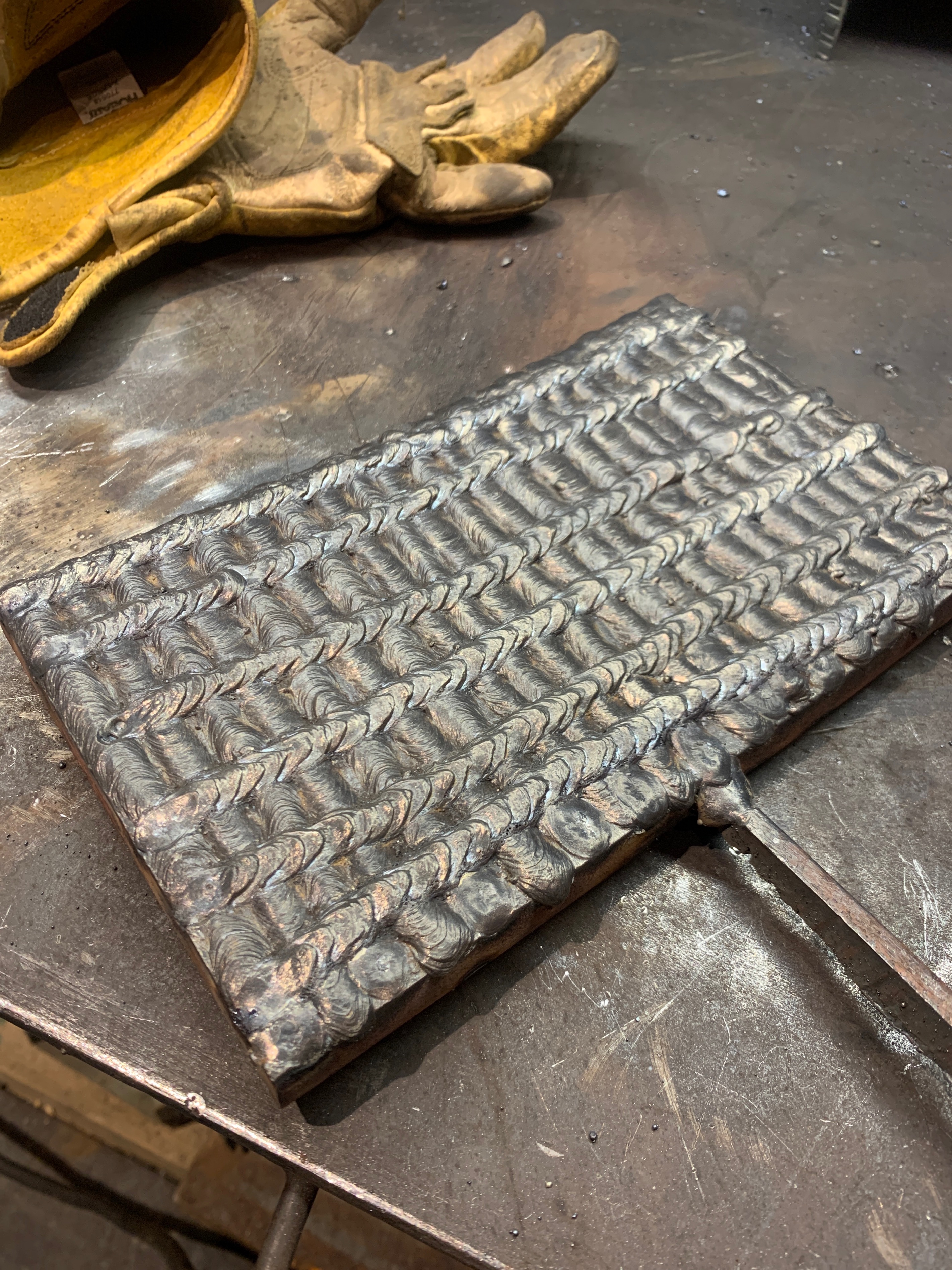

With 7018, you can just about run the bead with the stick touching the part. You can give yourself a little bit more arc length than that, but you want to keep it pretty tight. Also, if you manipulate the stick just a little, that will flatten out the profile a bit. Just don’t go too wide with the manipulation, or you could get slag inclusions in your weld. “Weave” the bead the width of your rod core, and see how that looks. Just a simple back-n-forth with a brief pause on each side. 7018 isn’t really meant for manipulation (hence the small movement), but I had to do it in class to drop that crown some. Your rod angle for that flat plate should be about 15 degrees from straight up.

Just stacking coins on top of 7018 with 6011.
Preparing for test(joking lol)

When practicing, one tip I picked up from youtube is to run beads in opposite directions, as in run a bead left to right, next one practice doing right to left, flip the coupon 90 deg and run beads back to front and then front to back. Pretty good practice.
   / 7018 weld advise. Pics. #51
That seems like a good practice even overall. As you are growing your welding skills, keep up with out of position welding too. Do it often enough to stay in the groove so to speak. For me, I can mostly flip things around to keep the technique simple for 3/4 of the year. Then of course, I find yourself needing to do vertical up or overhead, switch to a different process, etc. - and I have to re-learn it over again.

Lookin at contraption seem to me man is inventin some kind of new textured crepe cooker. Might just try gettin nice & hot, brush on some peanut oil and dip in batter and see what you get. Patterned crepes to hold more jam might be a whole new taste sensation. You make millions on sellin ORIGINAL official cooker.
