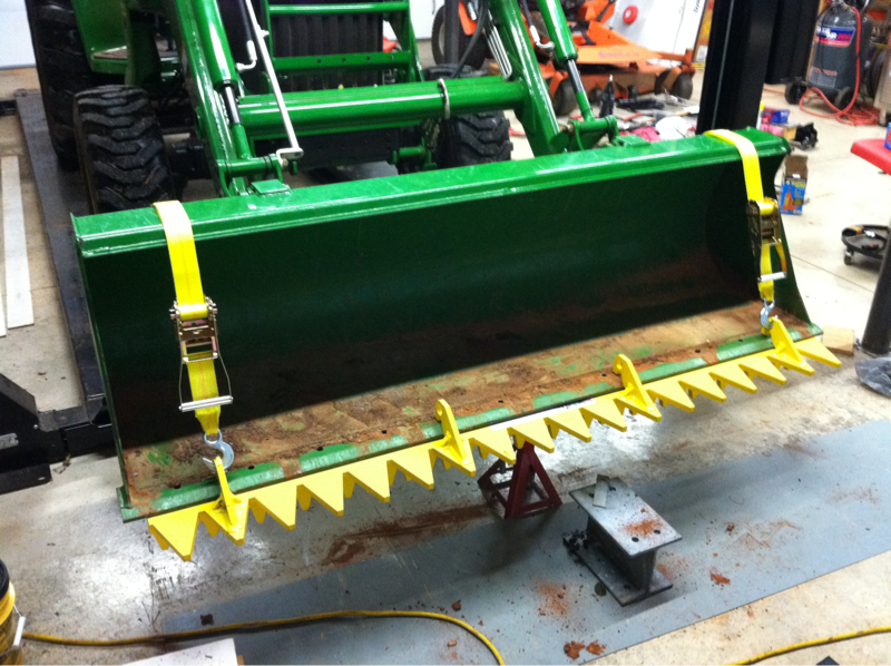

You'll have to weld another bottom tab to attach the strap to. You can grind it off the end one...
Teg is right. The 72" model does not have the corresponding bottom brackets for the 2nd and 3rd upper tabs. Cutting a length off of the end of the 72 would leave you with only one bottom bracket and therefore only one strap could be used.
Looking at the installation instructions on their website, it appears that the 52 inch model does have all 4 of the bottom brackets. I don't know why the longer version has just two.

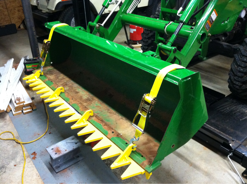

I just finish cutting, grinding and drilling 3 extra tabs... If I have time I'll post a photo of them before mounting them.
Thanks, somehow I missed that...
I saw that, & I think that's why I didn't notice they were missing on the inners of the 72".
I would guess that's because the 52" is made to also fit narrower buckets, & the 72 does not. That would seem to imply that the other brackets on the 72 are there for support only.

Well, I'm now part of the ratchet rake feeding frenzy. I bought one of the two left at the Athens, GA store. It's on and ready for a test when it dries up a little.

It will be a couple weeks before I get back up to the farm to weld it... May only use one or two...
   / 72 inch Rachet Rake on sale at TSC $199 #206
Nice brackets! :thumbsup:
I would use all 3 now you have them fabricated. Welding to 5/8" steel will be a breeze.:drink:
