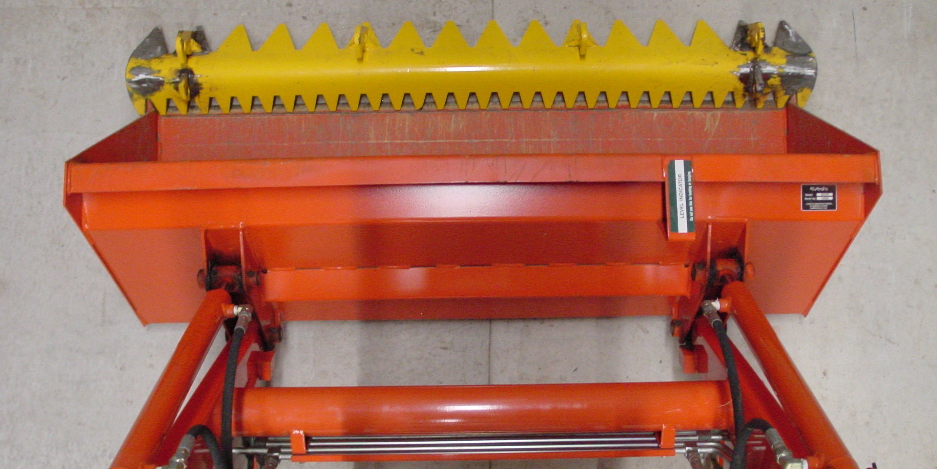

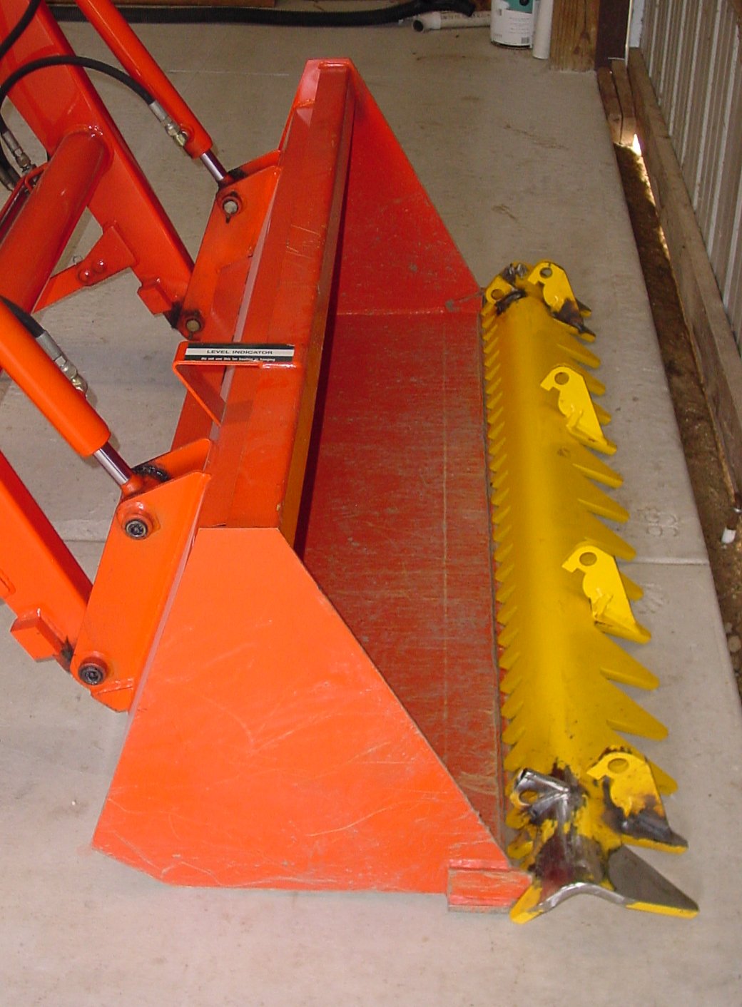

I snapped more pics of my own RR today, so figured why not share. Overall I am a little bummed about the fit of the 72" model on my 60" bucket. This is the strategy I settled on today for my test fit, but I'm not sold yet and will likely play around with it some more.
I chose to hang it off the driver's left side of the bucket, dunno why. But the offset of the RR brackets vs. my loader bucket width forces one mount to sit outside of the bucket (just barely). When you fit the strap hooks in the mounts, it forces the offset of the RR just a little further, if you want to keep the RR mounts all snugly grabbing the loader bucket.
But man, this thing is heavy duty! Hard to lift into position by yourself, I can see why they recommend you to keep it on the ground and use the loader to pick it up. Since it was in my truck bed I just lifted it myself vs. bending over to place it down on the ground first. I like the agressive look. The yellow almost matches my paint...
Ready to shred some dirt and annihilate some invasive bushes and saplings!

Here's how mine turned out after modifications by a neighbor/welder. One big tooth / two little teeth were removed from each end and the upper and lower brackets were moved inward by 4 inches. I have not attached it to the bucket yet as the FEL is removed for the winter but it appears to be a perfect fit for the 60 inch bucket. Perhaps a little paint, at least on the portions that will not contact the ground, and I will be the proud owner of a custom 64 inch RR.
Many thanks to the starter of this thread for the timely info about the TSC closeout. Thanks, too, to my neighbor Bob for providing the skilled labor:drink:
That seems like the ideal way to fix it for your bucket width. I think I have decided I am definitely going to chop mine short (one big tooth per side, like yours) but am not sure if I have the motivation to move the mounting points yet.
