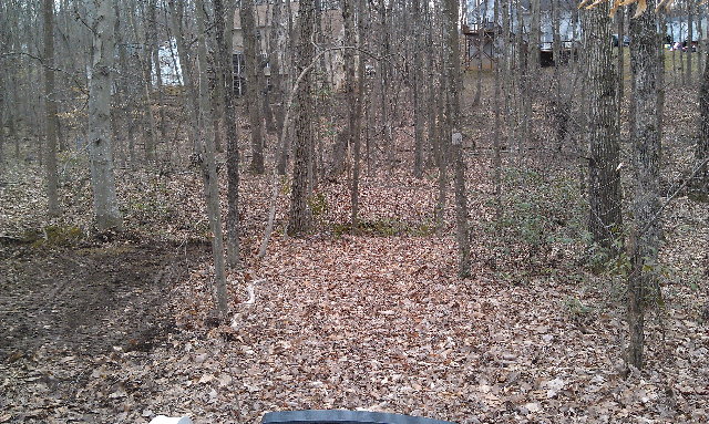

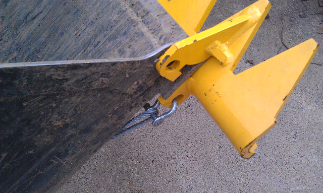

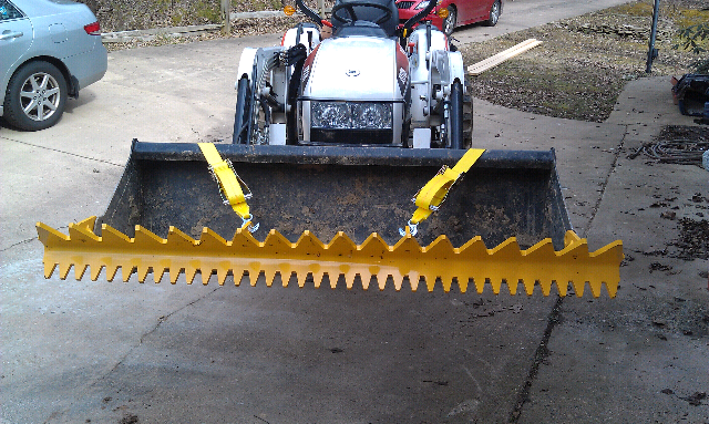

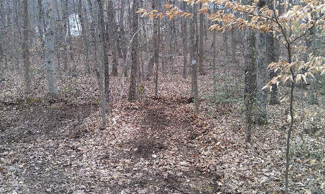

Tried out the RR today. It does pretty good. I have a Bobcat CT230 with a 60" bucket. The 72" rake fits right close to the edge of the bucket. One tab outside and the other tab wad inside the bucket.
It does better on loosed stuff and not so good on making new contour. It does not replace the box blade for this task. It does really good on stuff that allows the rake to sit with even pressure across the whole rake. Example would be in the woods I was clearing a trail and it was wide enough and all on the same grade so the rake was able to push all the leaves and sticks with no problem. As long as you want to go in one direction it works good, in order to keep pressure on the rake, it keeps the front wheels off the ground.
Here are some pictures showing the rake and some trails. There is one picture that shows the trail after two passes.
mine looks exactly like this on our 60"...one tab just in, and one just out..
