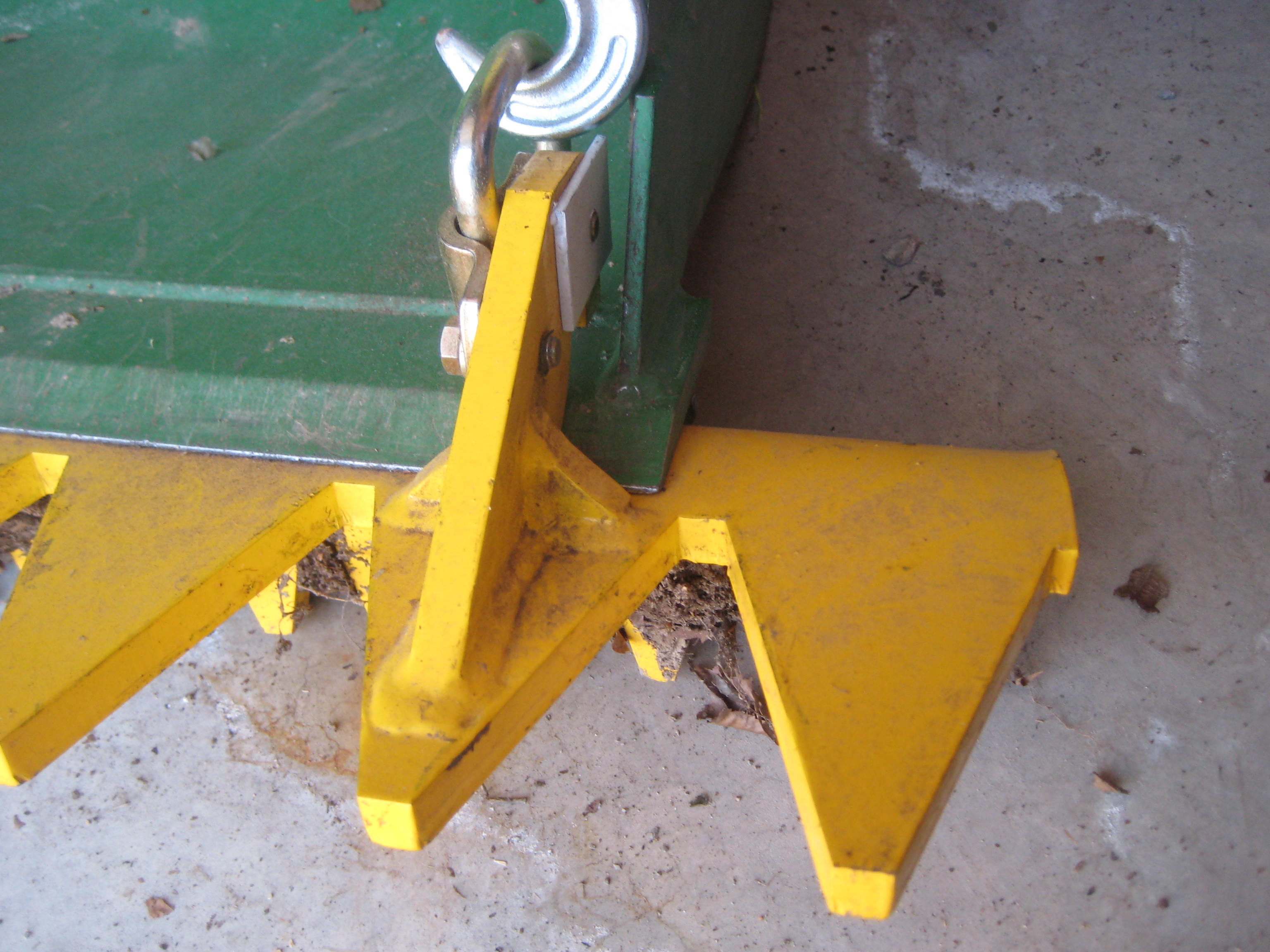

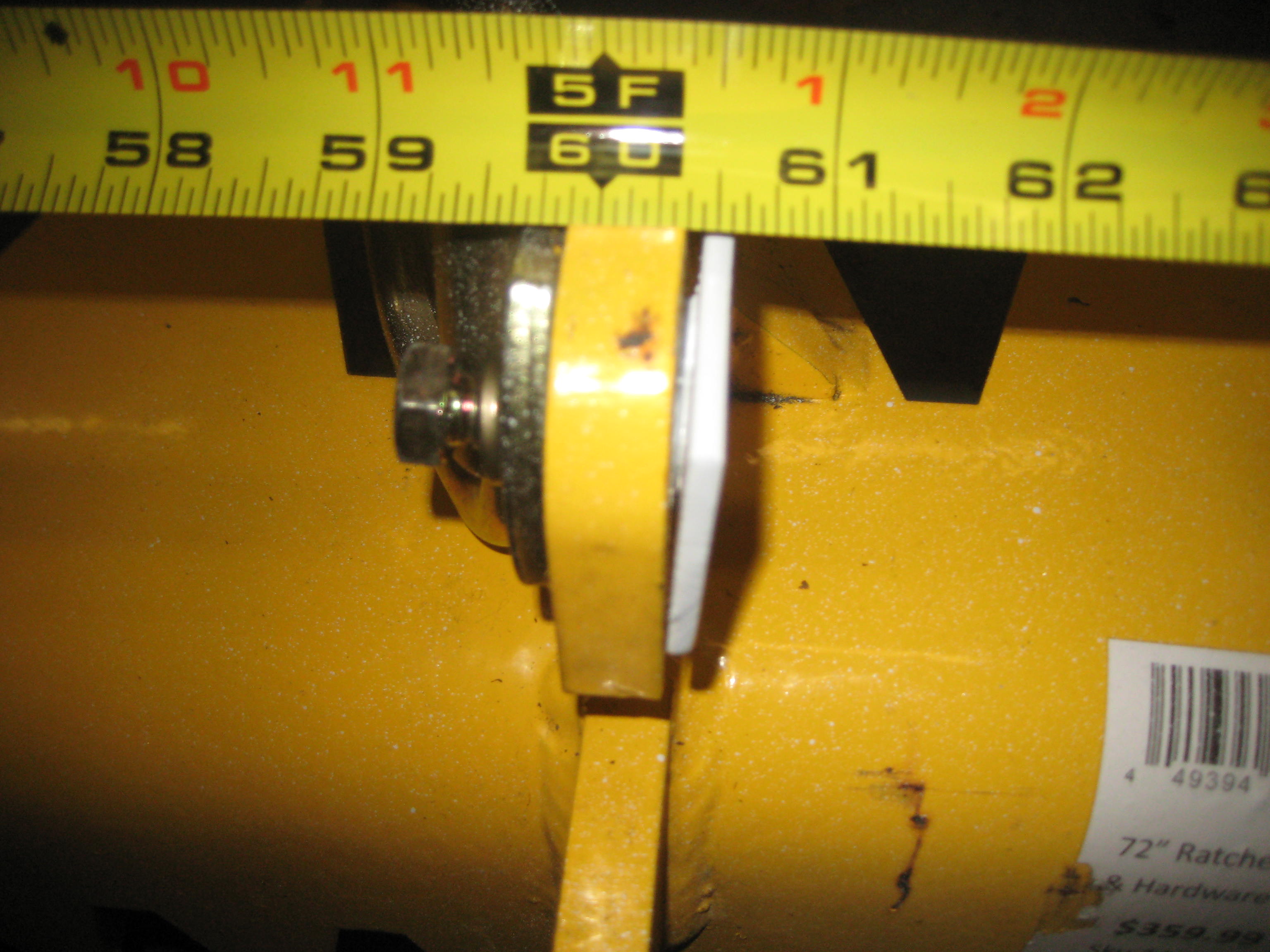

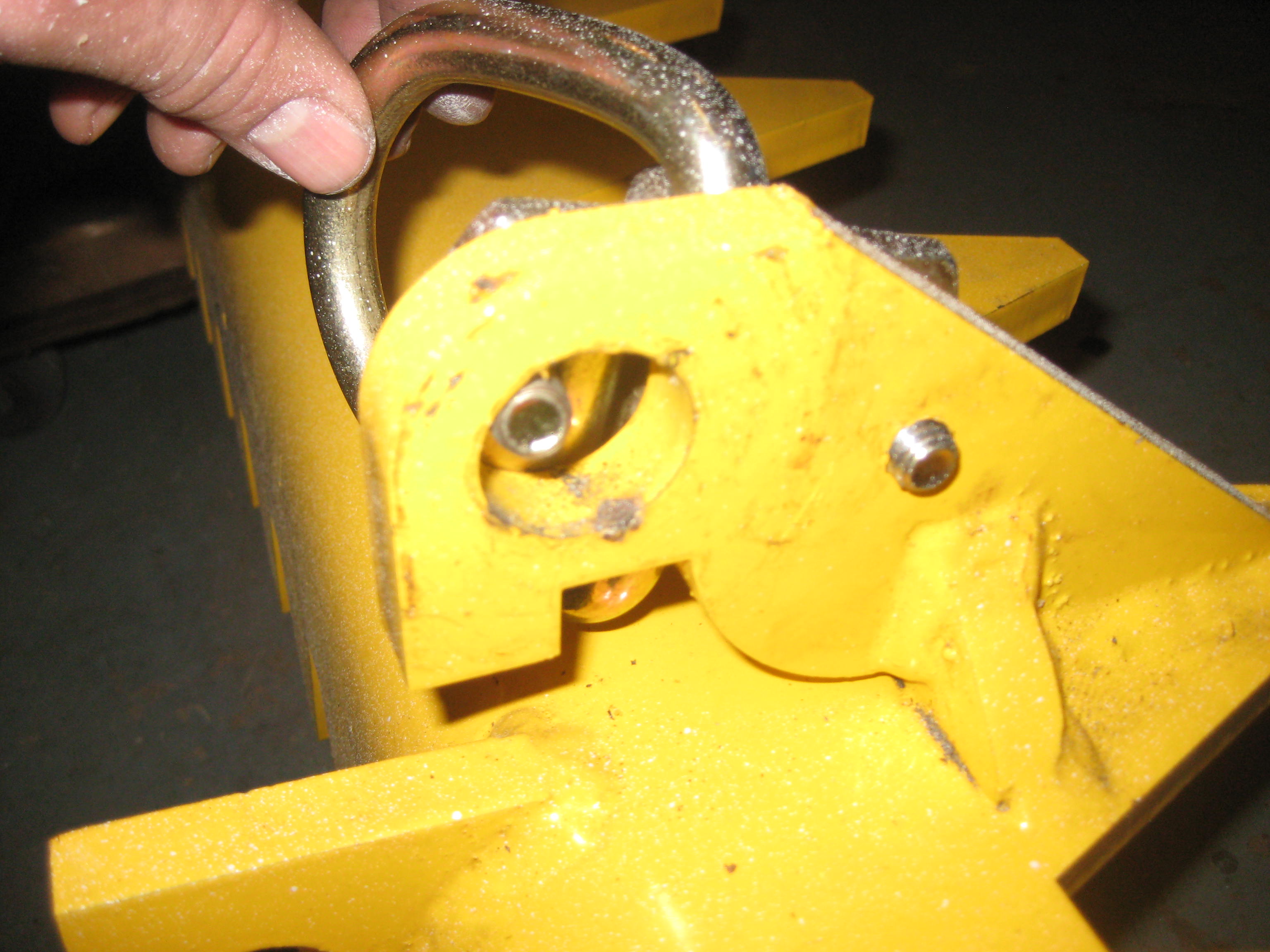

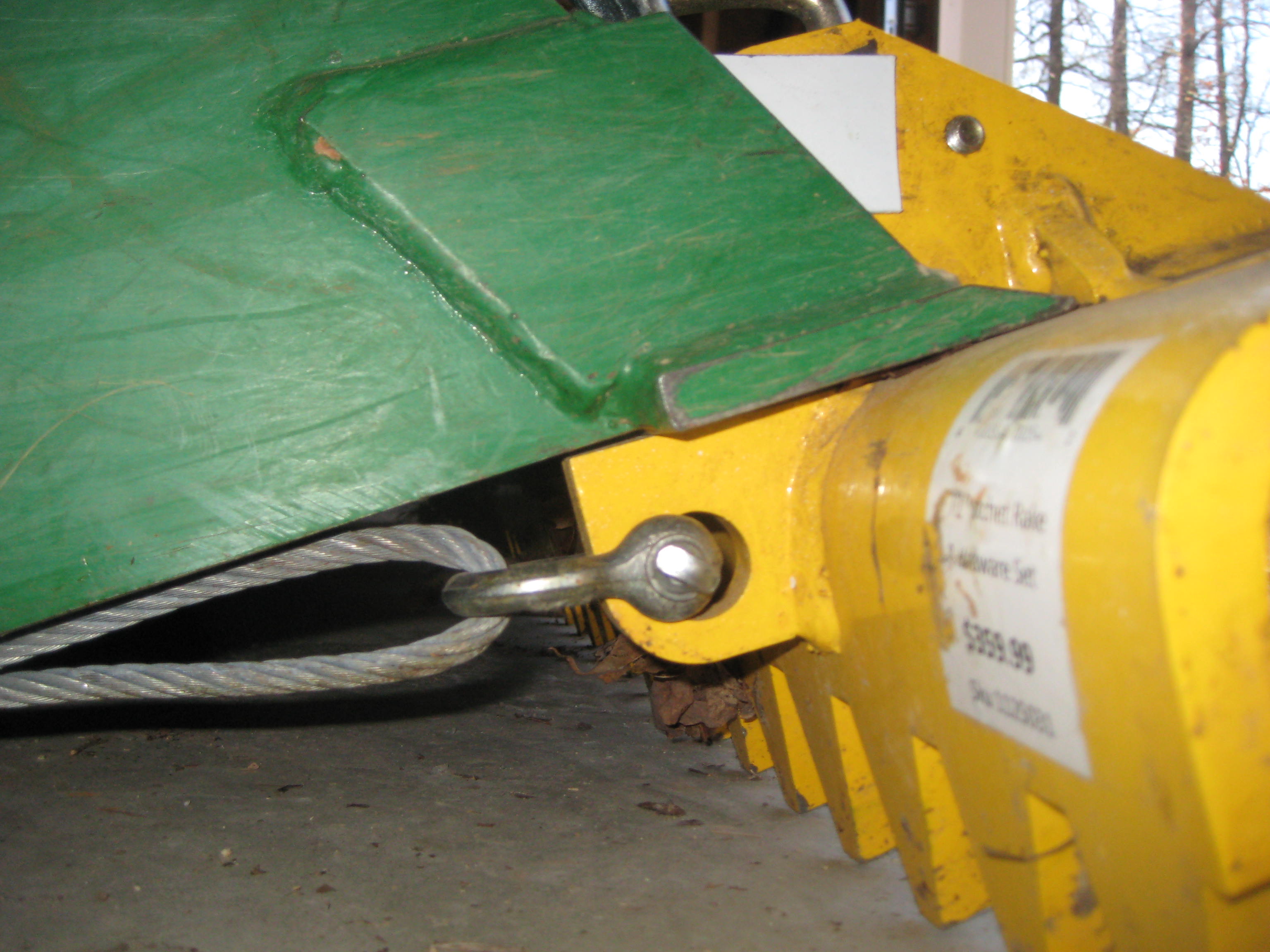

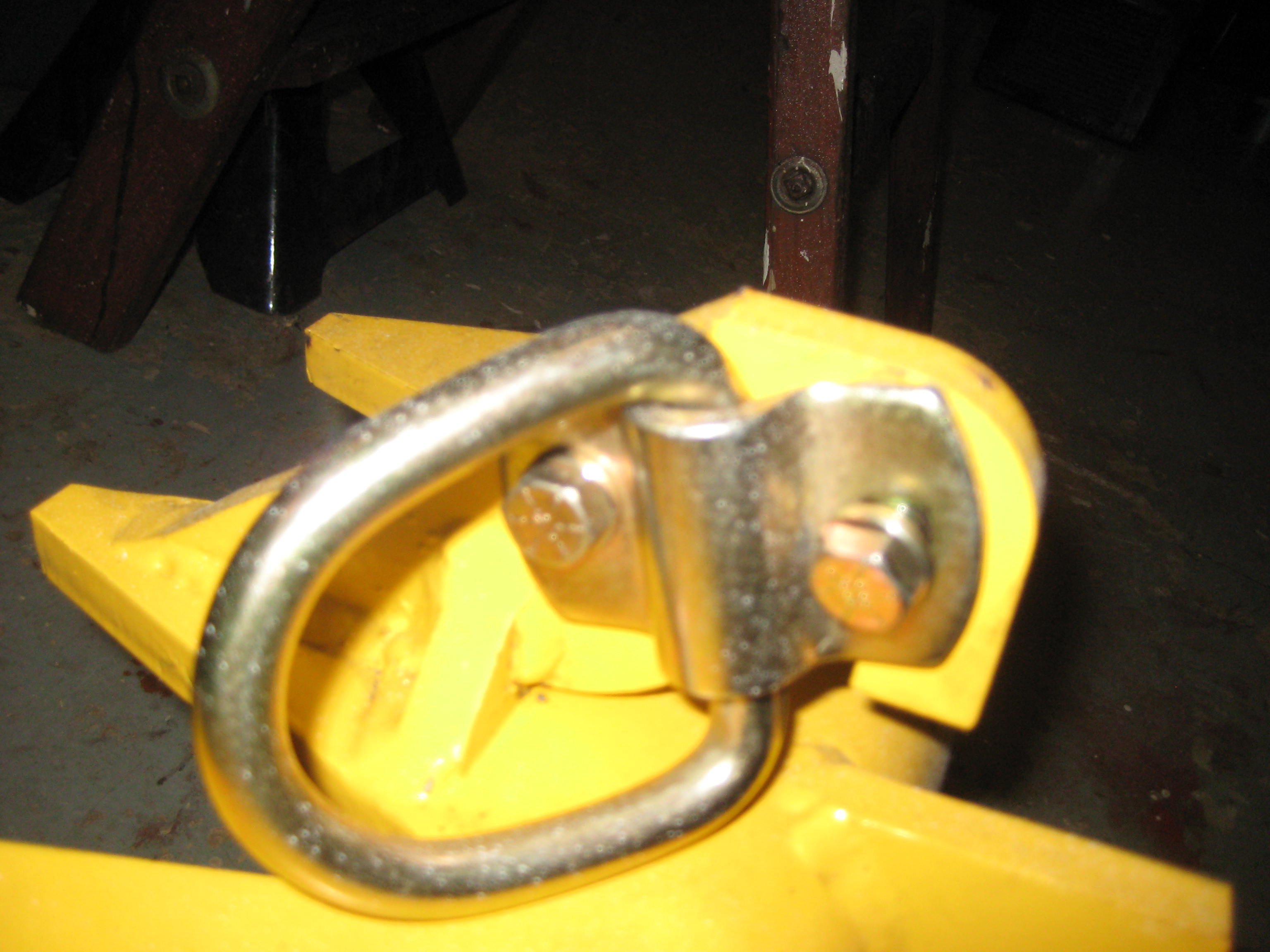

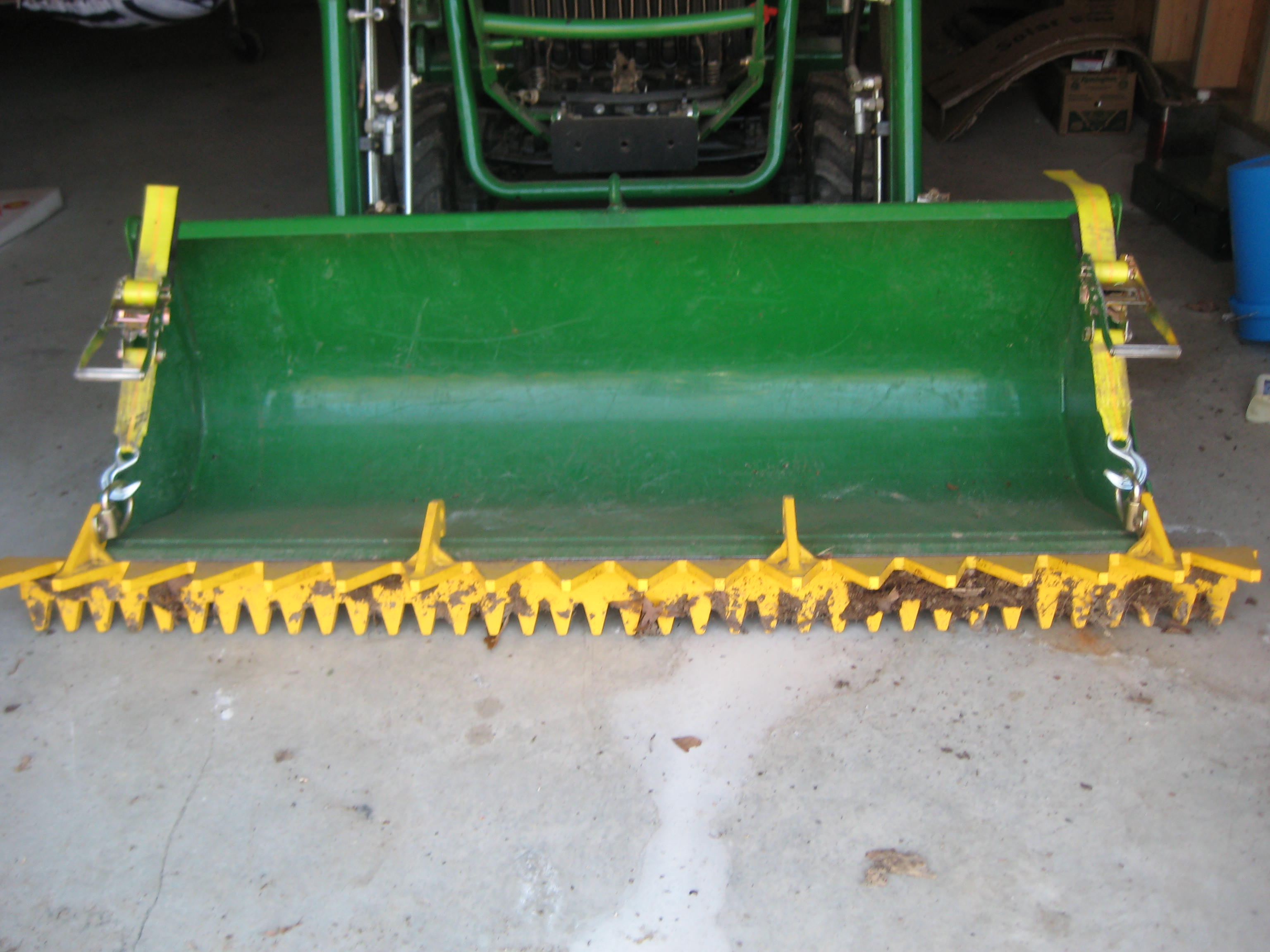

I grabbed one in Valparaiso, In last week - last one there too. Since my tractor is 400 miles away, I could not try it on my bucket. I did call my dealer and he was kind enough to measure the inside dimension of the 200CX 61" bucket. He said that the inside measured 61". Given this I figured that I had enough room for the RR to fit, but not enough for the straps. So, I added D-rings for attaching the straps
I drilled and tapped a 3/8" hole and for the larger hole, I welder a nut to a piece of 1/8" flat stock. If I have enough room, I will flip the flat stock or get me a 1/4" piece and drill and tap it. I'll post pics of it attached once I get down to where the tractor is located.
wanted to follow-up with the pictures of how my mods fit. This is a 200cx 61 inch bucket. BTW, this things does a very good job clearing brush!
I like the mods, only if I had one more inch I could do the same.

No seriously, same for me. My bucket is exactly the wrong width - bucket edges are an exact match for the width of the ratchet rake brackets.
Turned out great, ac2520!

Nice Job! Creative plate nut! Bolts are in shear with strap pull, nice and strong.:thumbsup:
