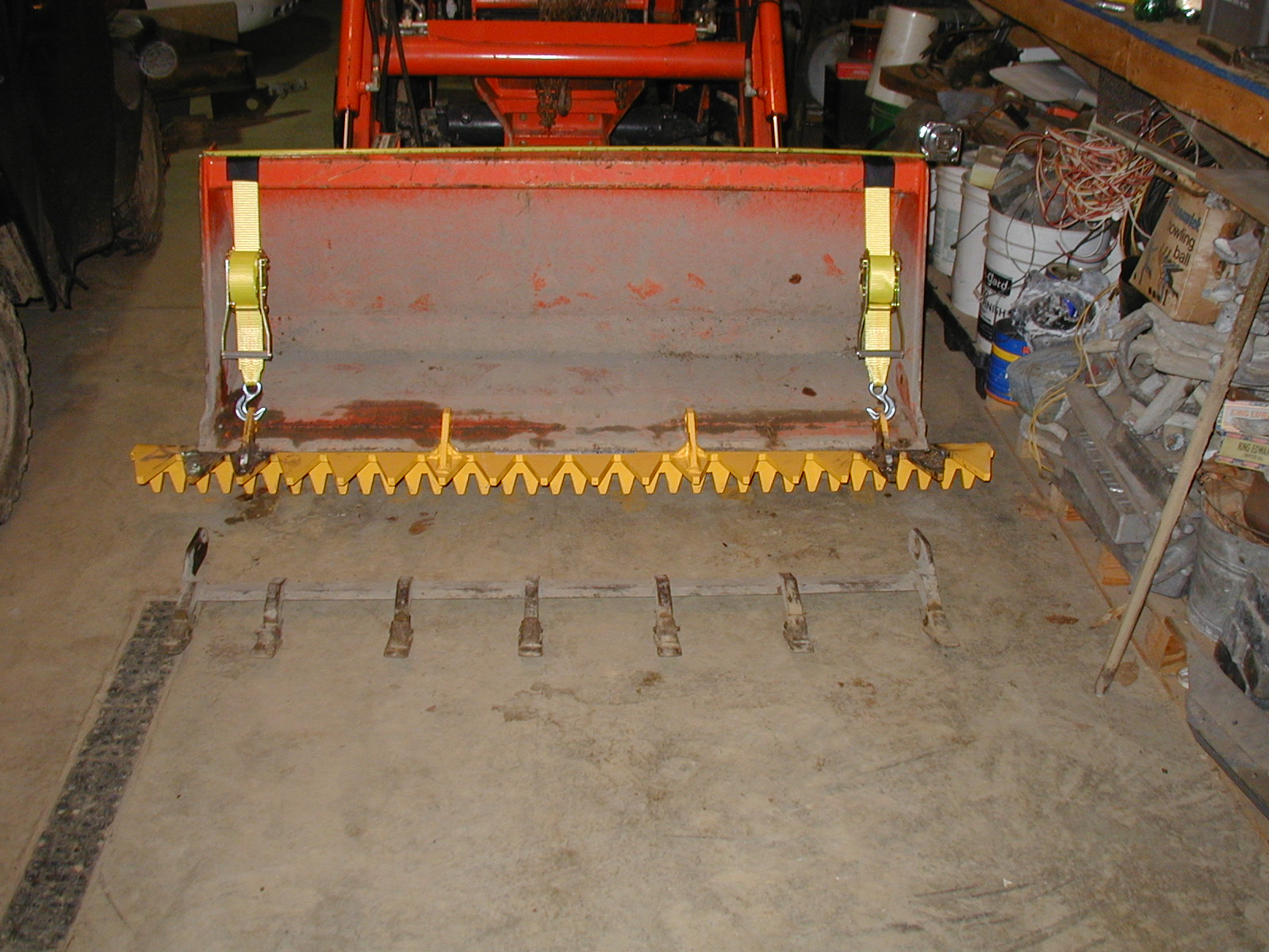

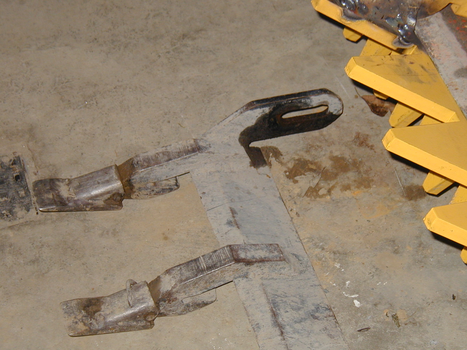

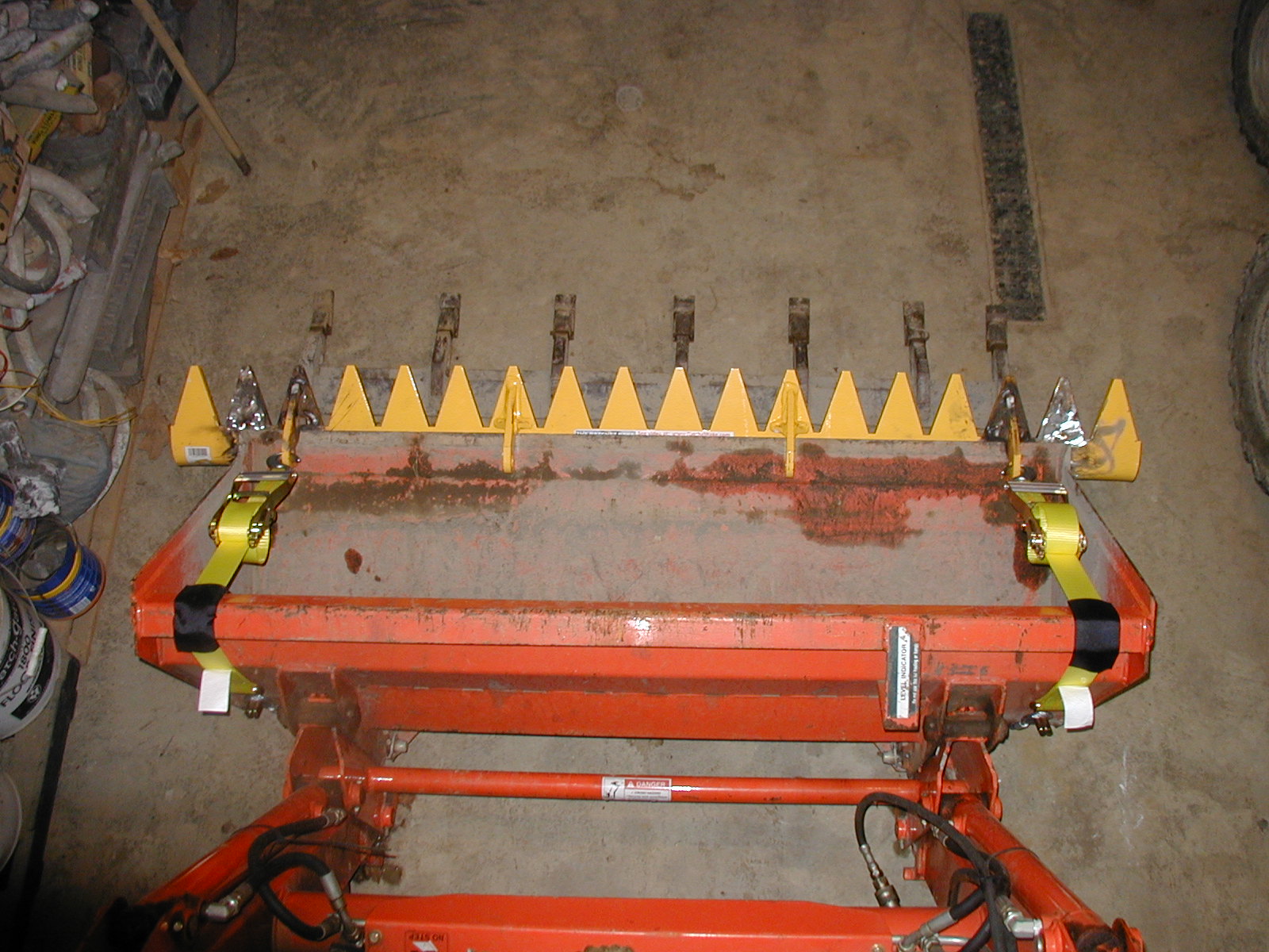

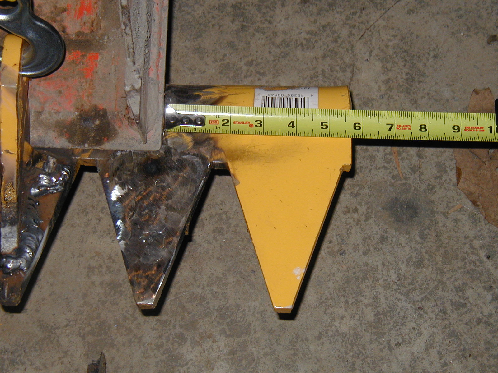

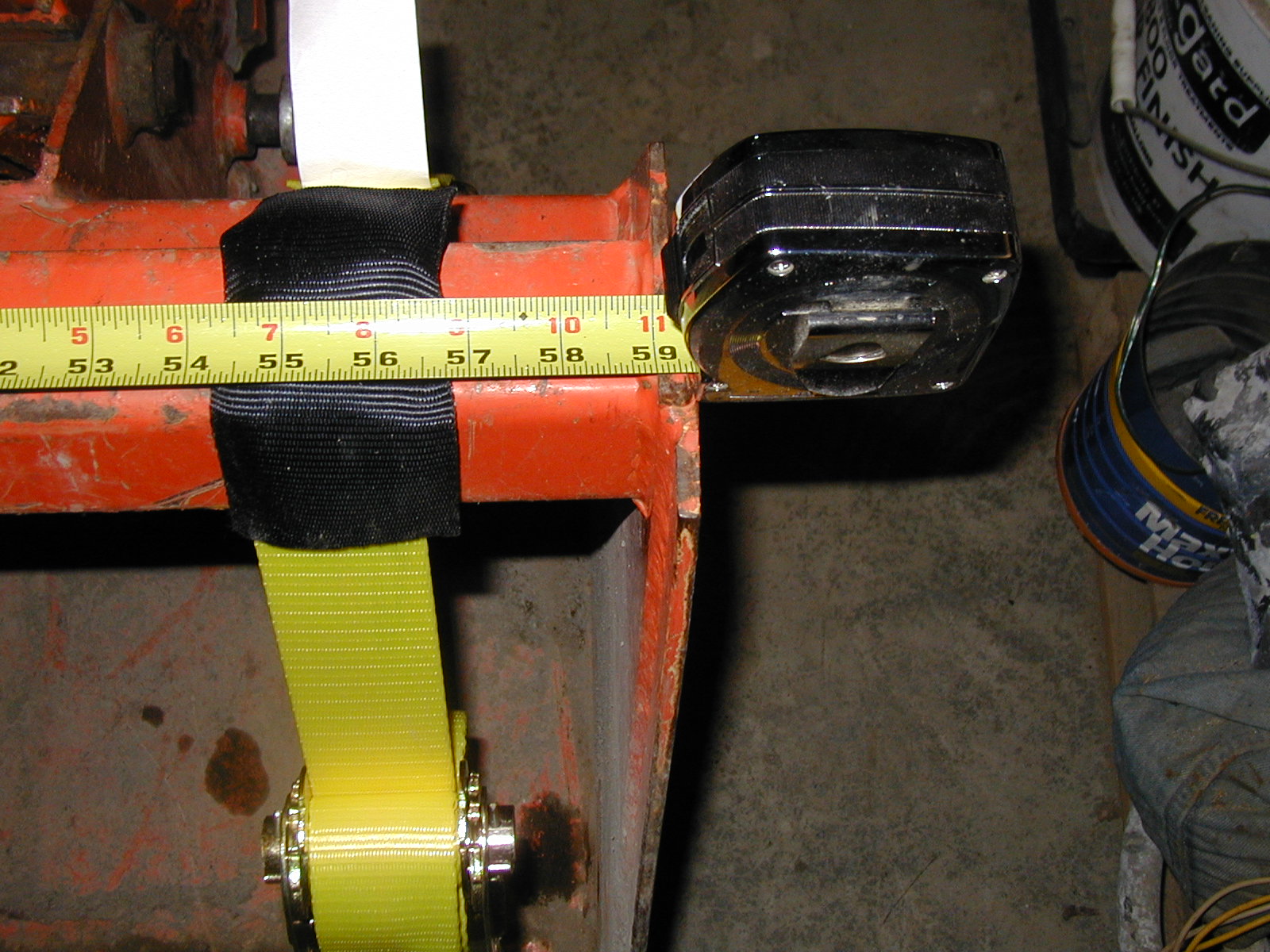

Well got the mod's done to make the Ratchet Rake fit my Kubota LA 463 loader bucket.
The pics are with my tooth bar removed, it has enlongated holes on the mounting bracket,
and if you drill your holes for it correctly, simply loosen the bolts, slide the tooth bar forward and flip it back into the bucket.
With the 5 1/2" extension each side, this will be wider than the wheel base of the Kubota L3400.
Enjoy the pics, I will post more tomorrow using it to remove the ice in my drive way.
Also have some ideas on using it for hooking chains etc. for lifting.
JW5875
