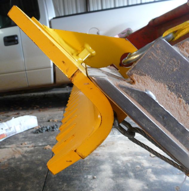

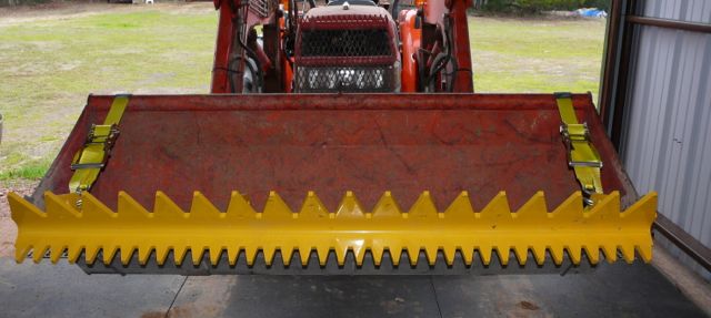

I installed mine and worked it hard. Works great. The straps are not a problem and the rake did not move while popping out 15' youpons. I like the fact that it has 2 rakes at 90 degrees, it's useful pushing and pulling. It does a quicker, cleaner job than my tooth bar.
FYI: If your looking to put it on a smaller bucket the upper brackets that have the hook in it, the outer measurement is 60 1/2". The hook going through the hole will add an inch on each side =62 1/2" inside bucket.
Probably in the future I will add a bar to the sides to make it fit in the side holes where the tooth bar connects to make it bolt on/off.

Thanks Bdavis for the heads up! Just grabbed mine this afternoon. If any one in the very most NW corner of Pa is interested there are still some available in Corry and Warren. Erie was out of the 72" and I grabbed the last one from Meadville. txdon you are right about putting it on a smaller bucket, I have a 62" which I was planning on adding tabs to use same bolt holes from the tooth bar. I stuck it on this evening and it does work, probably will still fab it so I can bolt it on though.
Can't wait till spring to use it now, shucks!
