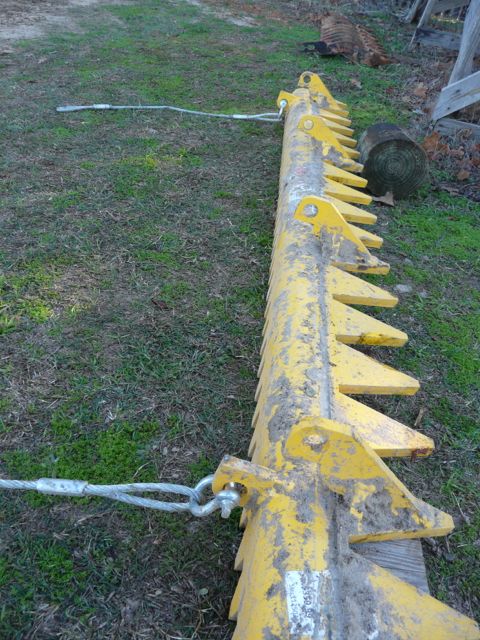

On the 72" rake:
The one thing that would be close is the upper brackets. If you don't have 60 1/2" on the INSIDE of the bucket you will have to figure something out.
   / 72 inch Rachet Rake on sale at TSC $199 #79
If you look there are four mount brackets. All are 20" center to center to the closest one. The outer two are 60" center to center. The inner pair are 20" center to center. For overall width add 1/2" since they are 1/2" stock.
So your bucket is less than 60" wide try using the the center two hookup points. If you are right at the 60-62" width, just offset and use an end and center mount point.
I wondered if they thought four straps might be required to keep the largest rake on the bucket. Then testing only required two, since that all the mount kit contains.
   / 72 inch Rachet Rake on sale at TSC $199 #80
The inner top brackets do not have corresponding under brackets to hold the cable, only the outers. If you use the inner top brackets then you will have to make something on the lower side to connect the cables to.
