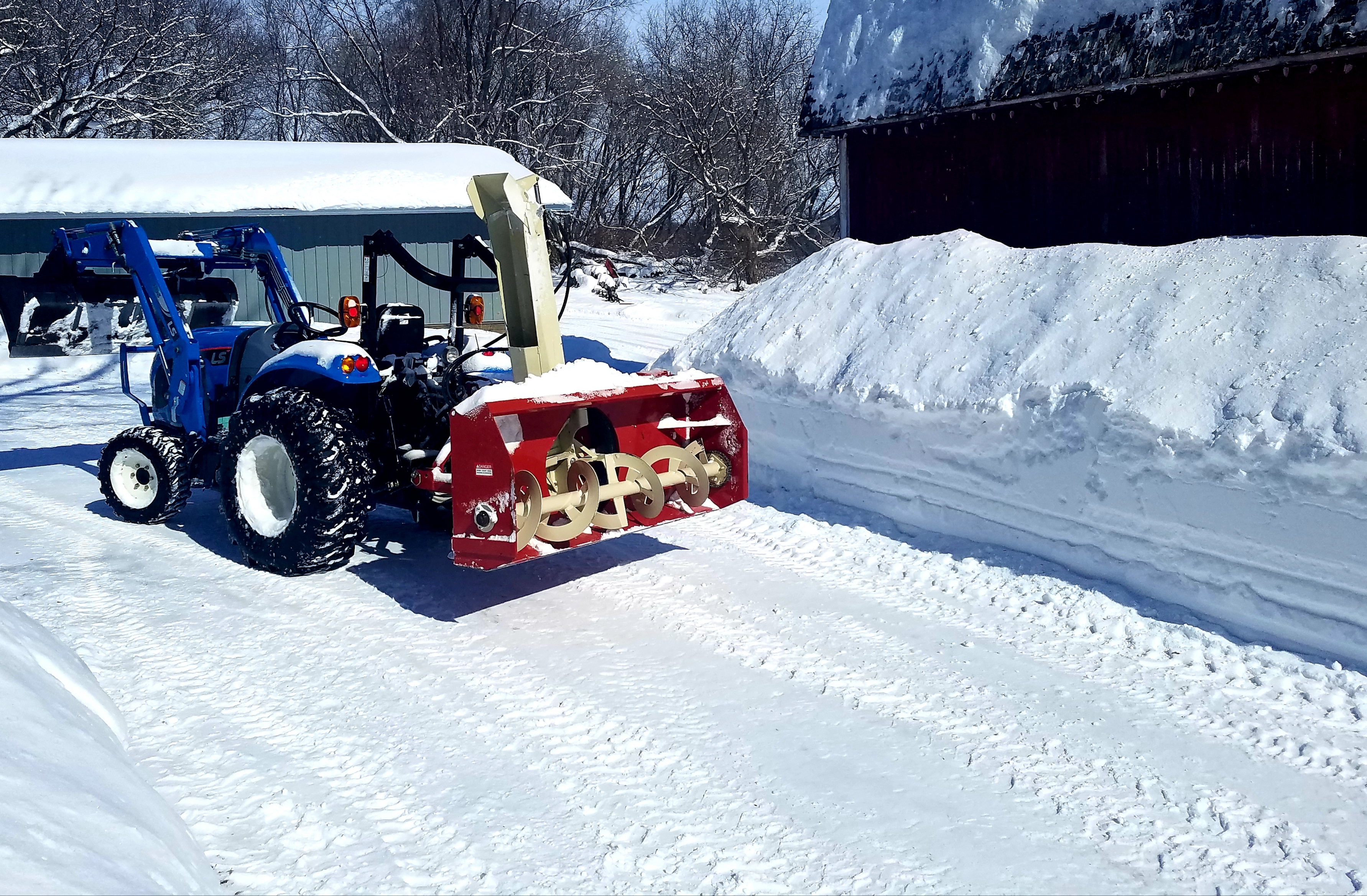

I had a Kioti DK35 w/a 72” blower and it did very well on the light stuff but was not the rig for heavy deep snow. I moved larger piles by pushing them back with the plow. I needed to keep ahead of it during heavy snow with the blower or it would get out of hand. Here it is:
Now with 88 hp the 1000 rpm 96” blower works on everything so far. I can even fill the neighbors driveway 200’ away. When I back into a big heavy pile I need to use the creeper gear, so a smaller tractor may not have the gearing to move slow enough without stalling.

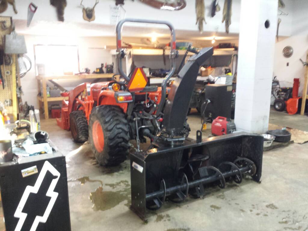

I run a 72 inch 3 pt blower with 30 hp at the pto. It's been a good setup especially this year, one of the worst winters in northern MN I've seen in years. Speed is definitely key though, you have to creep through the really deep packed stuff. I use it on my 1/5 mile driveway doing half to 3/4 swipes at a time so I don't have to go as slow. Mine is a agriease brand, very simple setup, no bells and whistles, less stuff to break or go wrong. It's worth it's weight in gold for all the snow it's thrown this year alone. Between the blower and FEL it's a great snow removal tool20181110_142553.jpeg
