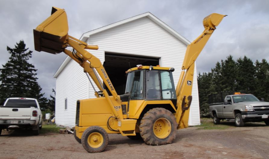

About 6 years ago I bought an old John Deere 510B backhoe to use on my property for hauling shale, topsoil, digging out stumps, ditching, septic tanks, putting in culverts, etc... They are probably the most useful toy you can get if you have lots of work to do. Actually, one of the first jobs I had to do was dig a grave for my neighbours horse. That was the first time I realized that after digging the large grave and putting a horse in it, there still wasn't any soil left over. You can really compact the soil. I dig up allot of stumps and always bury them in the same hole they come out of. I will say that most of them are fir trees that don't have a large root system but are still large. An excavator can do the same thing. A backhoe is smaller if you don't have the room to get around. It would probably be more cost effective to have someone come in and do the job for you. But you would also have fun playing with a rental.
