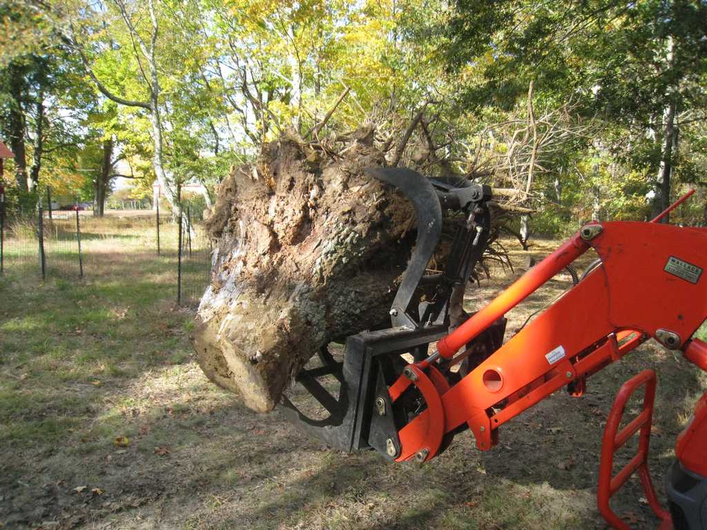

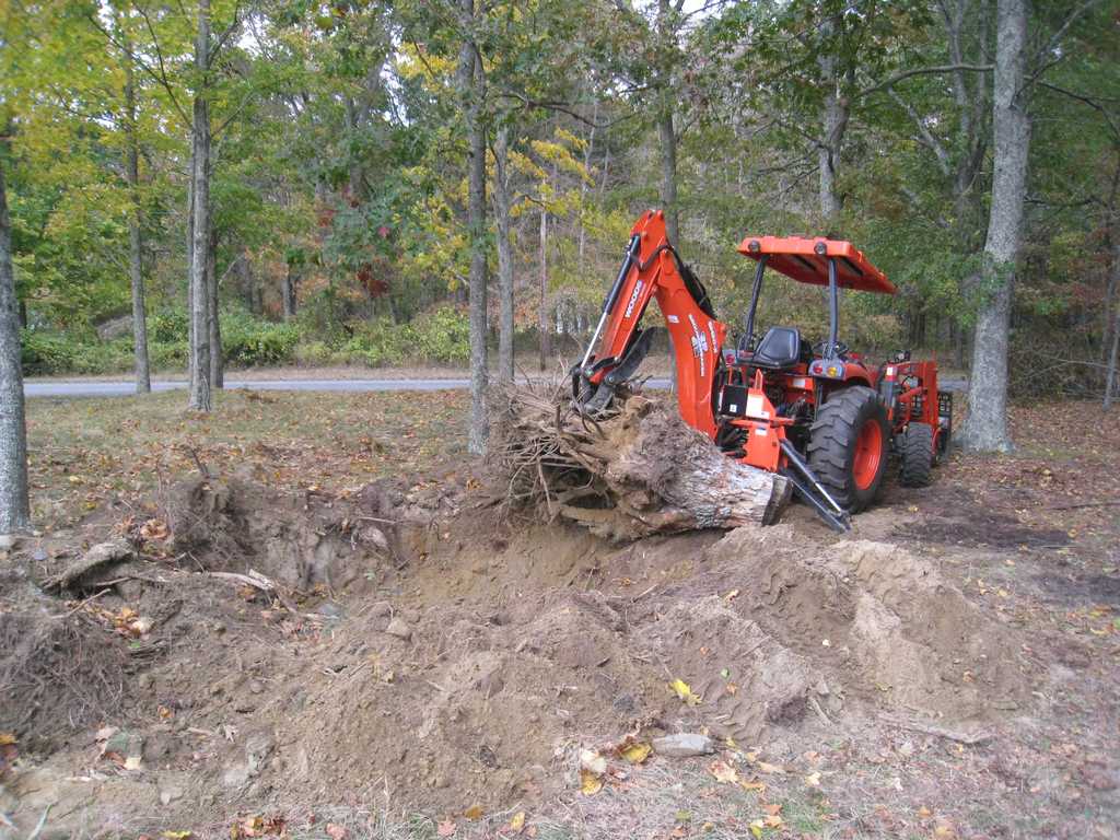

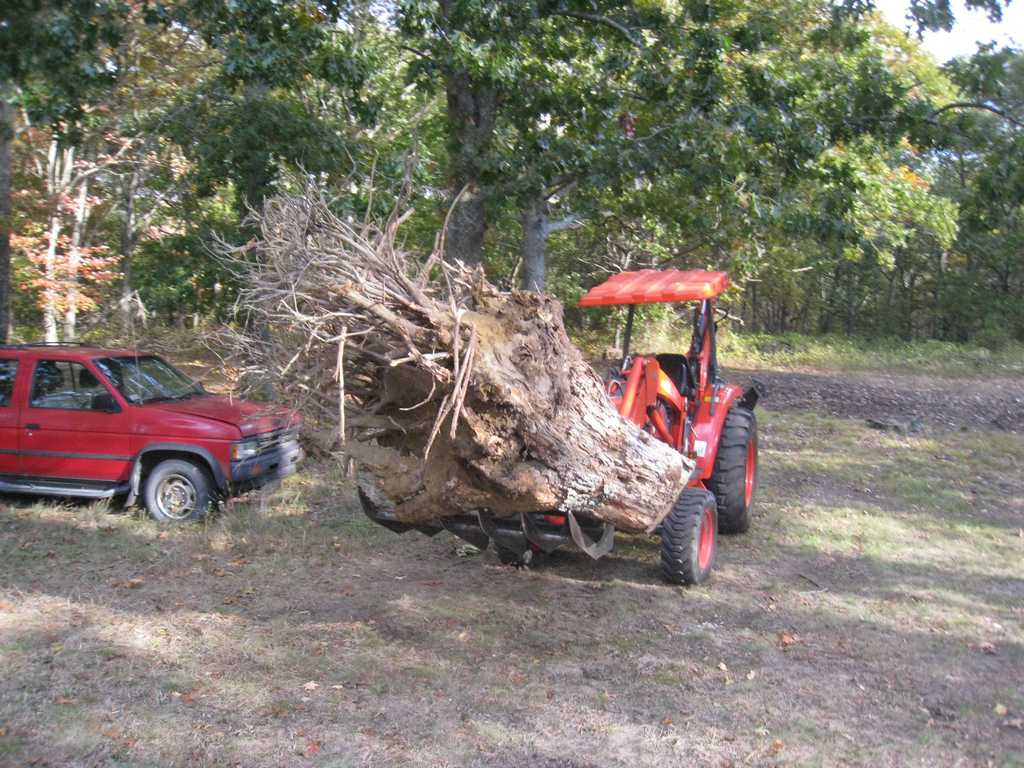

If your main task will be stumping, you really might want to investigate getting a ripper to replace the bucket. A ripper makes much faster work of stumps for the simple reason that it applies all the power to a 1 or 2 inch blade rather than a 24 or 36 inch bucket. A ripper also allows you to remove stumps with far less disturbance of the surrounding soil. I had a ripper fabricated for my Woods BH90x from a design I developed based on excavator rippers. Cost me about $500. I'd imagine you could get one built for an excavator for about double that which would make the work go a lot faster. Michigan Iron and Equipment built mine (and others) and they are a pleasure to work with. Ask for Bob or Tony and see what they think.
that is a lot of stump that you took on there. how did you get it out of there?
   / 75hp or 85hp Backhoe or 9 ton Excavator #42
I couldn't lift it out of the hole with my grapple even though the tractor will lift 2760lbs at pivot points. Instead I dragged it up the hole with the backhoe and finally, with the stump hooked on the ripper, pulled the last bit using the tractor drive train. Once it was out of the hole I picked it up with the grapple and drove it to it's final resting/rotting place in the woods.
