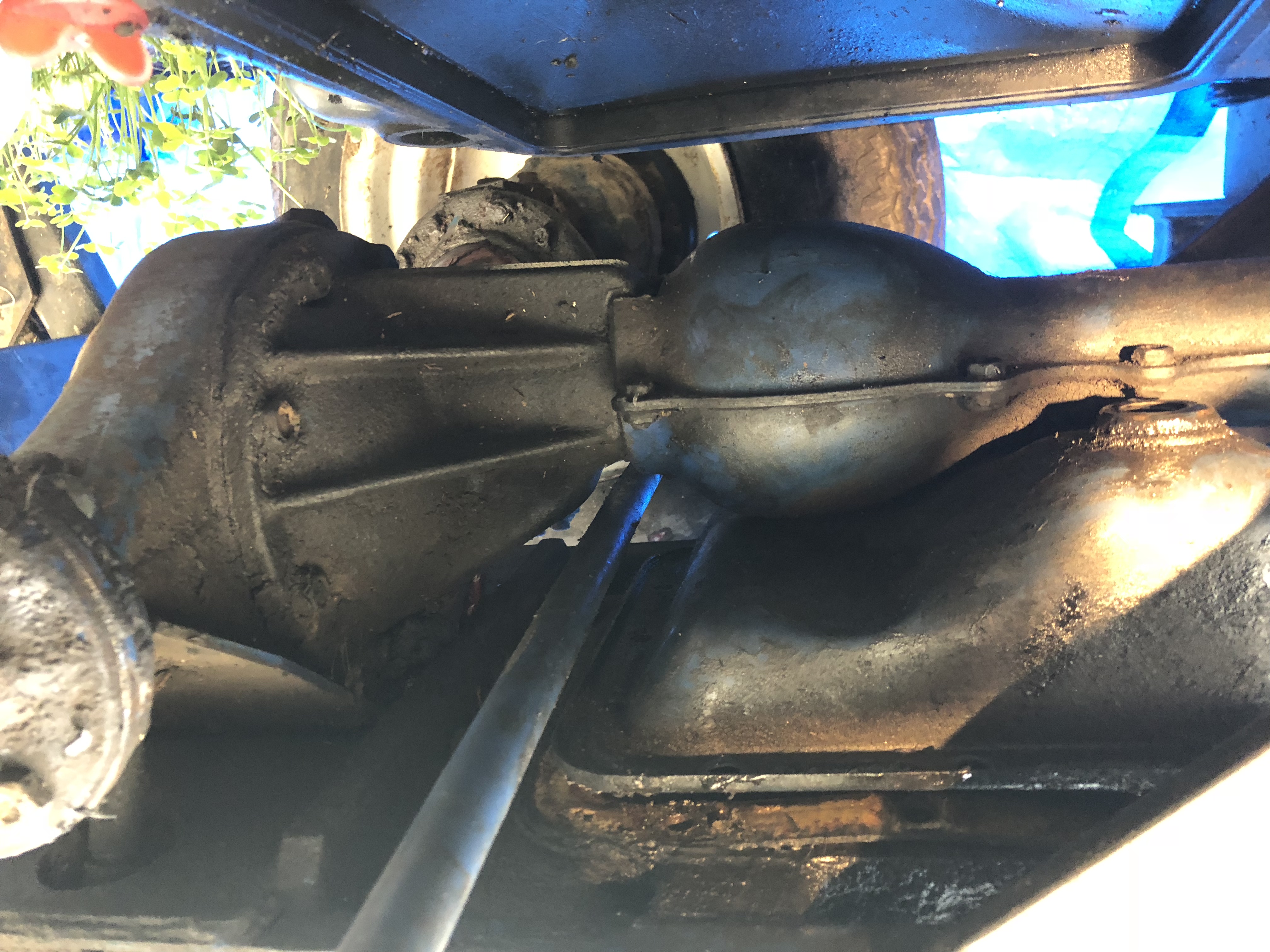

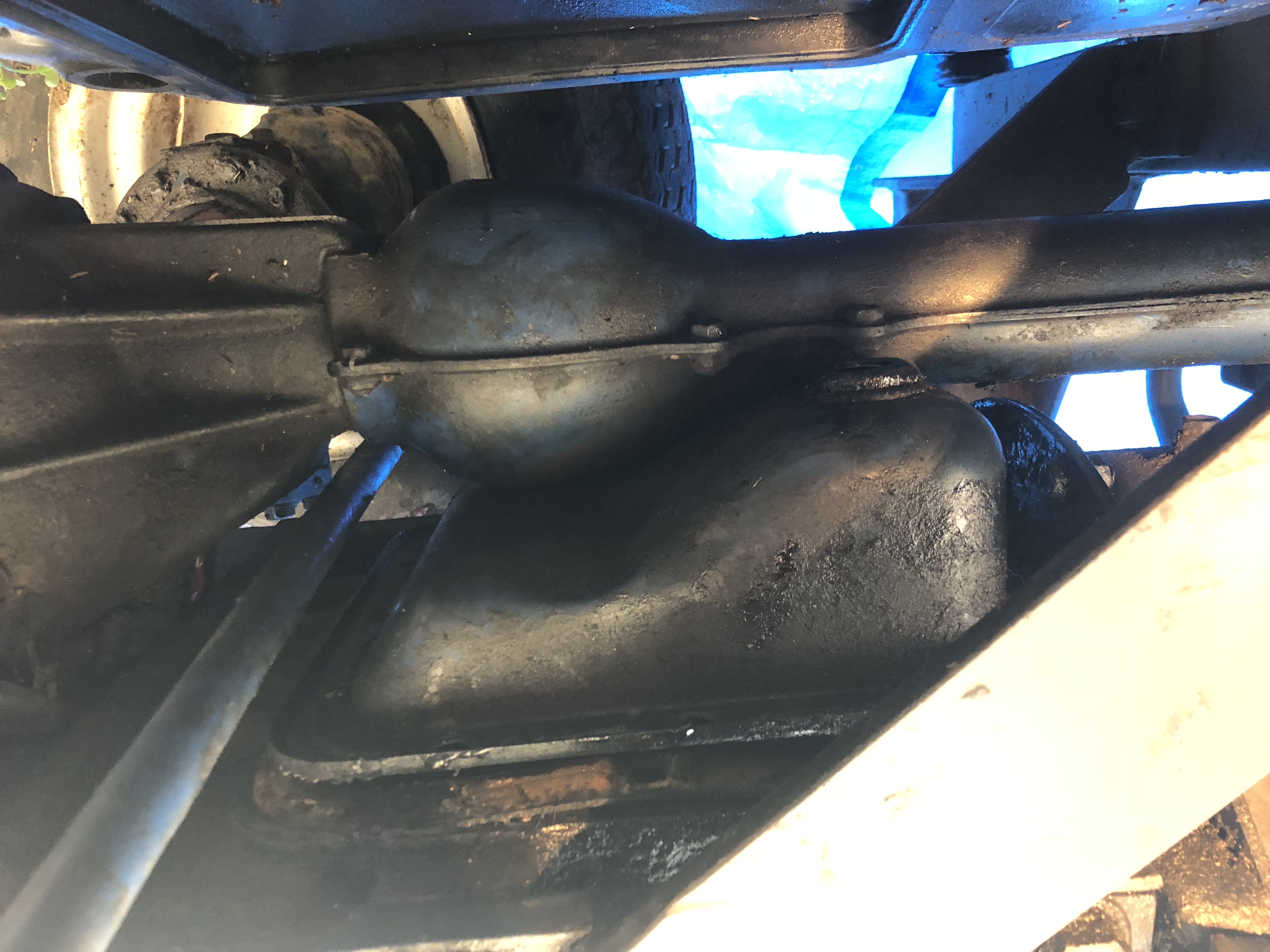

Heres a picture of my oil pan/drive shaft predicament looks like theres an outer shield to the drive shaft, maybe I just need to pull that to get to the rods?
   / 77 Satoh Beaver S370D wont start, low compression #54
In order to drop the oil pan you normally need to drop at least the front half of the drive shaft. You might be able to pull the pan out with just taking off the drive shaft guard but you'll want the drive shaft out of the way anyway when you start working on the connecting rod caps. Each piston ideally would be around TDC when you set the valves for their corresponding cylinder but that can be inconvenient to get to without being able to see the crankshaft pulley timing marks. That's why I generally just spin the engine and watch the valves. After the intake valve closes for the particular cylinder being adjusted, just turn the crankshaft somewhere between 90 and 180 degrees clockwise (looking towards the rear of the tractor facing the crankshaft pulley) and that will be close enough. These engines aren't really that sensitive to valve adjustment or timing. The biggest concern is making sure the valves are able to close fully to prevent compression losses through them so you want to ensure you're at least have some gap. More isn't as bad as less but a ton of gap won't allow it to breath either.

Ill have to read over the manual for a while, I skimmed through and didnt really see anything about driveshaft removal. Im worried if I split that case I wont get it back in there the way its supposed to go.

Bill Rodgers of Valley Power is the man...no pumpkin splitting required. Remove driveshaft covers, unbolt 4 bolts on the yoke and slide it out the back. Ill be getting back into it after work today and take some pictures and probably a video. After figuring out the youtubes, its actually easier to post videos than pictures using a phone. And if a picture is worth 1000 words, it seems a video should be worth 1000 pictures, right?

.....didnt really see anything about driveshaft removal. Im worried if I split that case I wont get it back in there the way its supposed to go.
Your driveshaft case/shield looks similar to the one on my tractor. Simple 2 piece design, it's dry ( no oil,grease, fluid). Remove the perimeter bolts and there are probably 2-4 bolts that hold the shield to the differential and trans cases. Pop the shield's 2 pieces apart and you can get to the front drive shaft and yoke.
