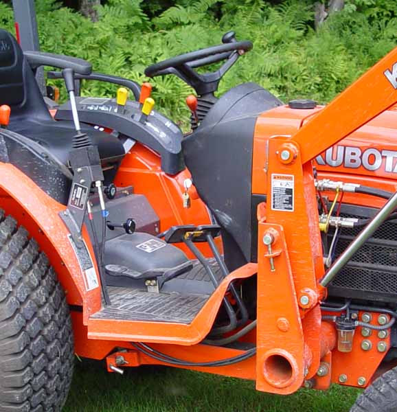

I asked the salesman about mounting an FEL on the B3030 w/cab, and he wasn't sure how it was done. I went to the Kubota website and also looked at the brochure, and they don't show any of those units with the FEL structure mounted on the tractor. I did see in one of the pictures where they had the FEL hydraulics mounted in front of the cab, but there was no framework for the FEL. Do you know how they mount the joystick? Do they remove the lower window and mount it similar to the B2910, or is it mounted differently? Also will the joystick restrict exiting the cab on the right side? Thanks for doing the research. /forums/images/graemlins/smile.gif

The valve is not the same. In fact, it's the same but it's upside down with a remote joystick. The cables pass beneath the deck and through a hole near the right fender in the deck. I asked my dealer for a remote valve when I bought my B3030. I was a bit jealous about the joystick on a JD. Here are two pics showing the thing.
I forgot to say that what I like the most about that kind of joystick is the possibility to position the joystick as you want (inclination and rotation) to be comfortable.

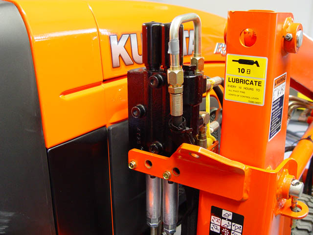

Close up of the valve. As you can see there's no obstruction for the cab with a valve mounted like that.
