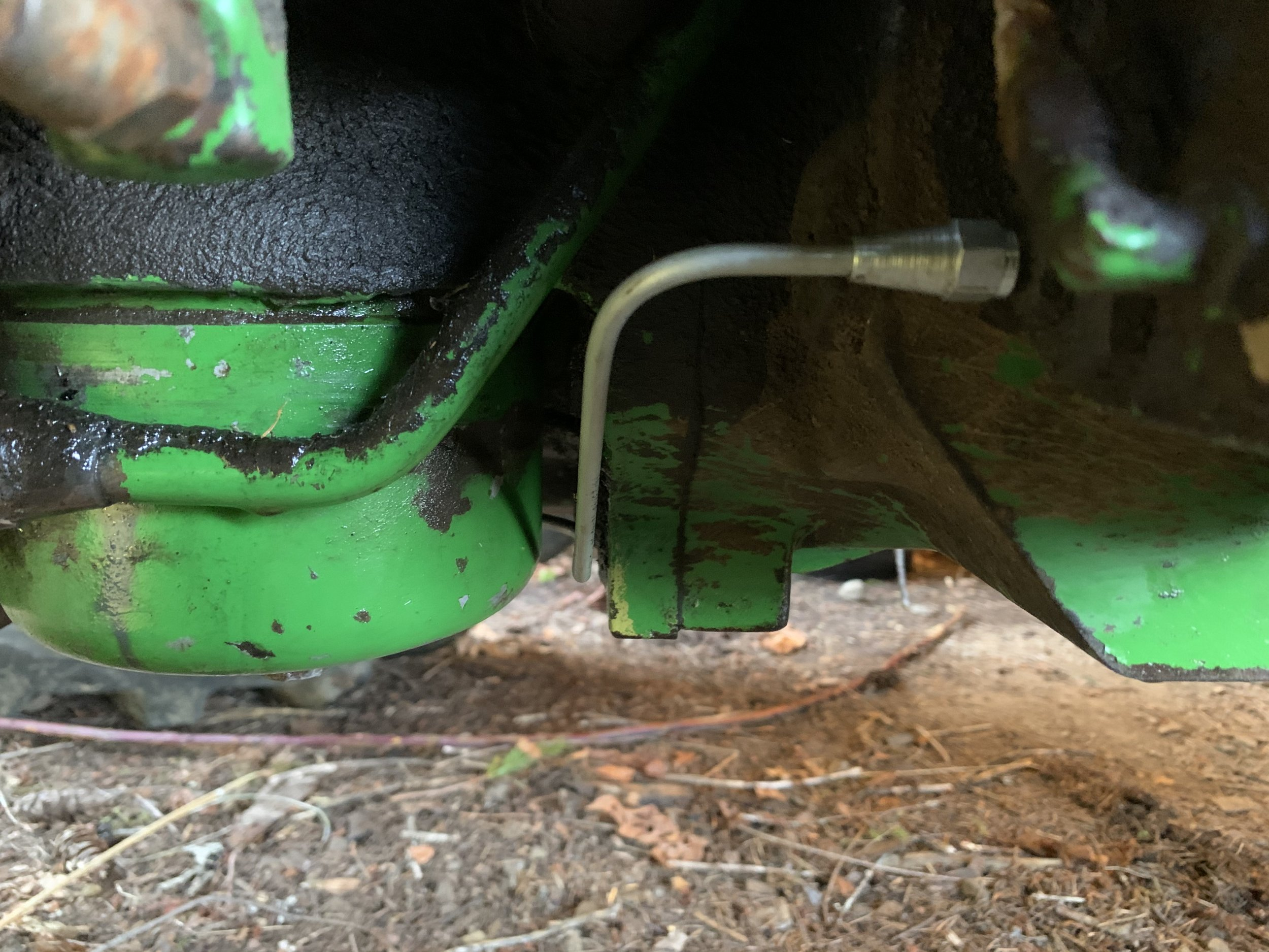

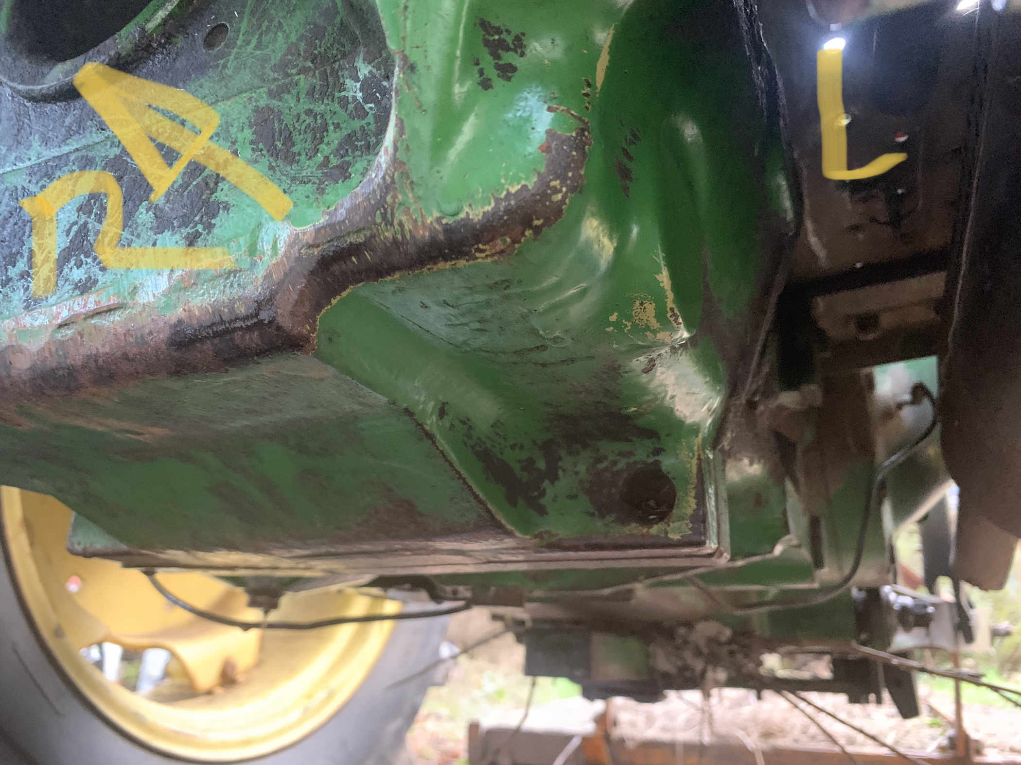

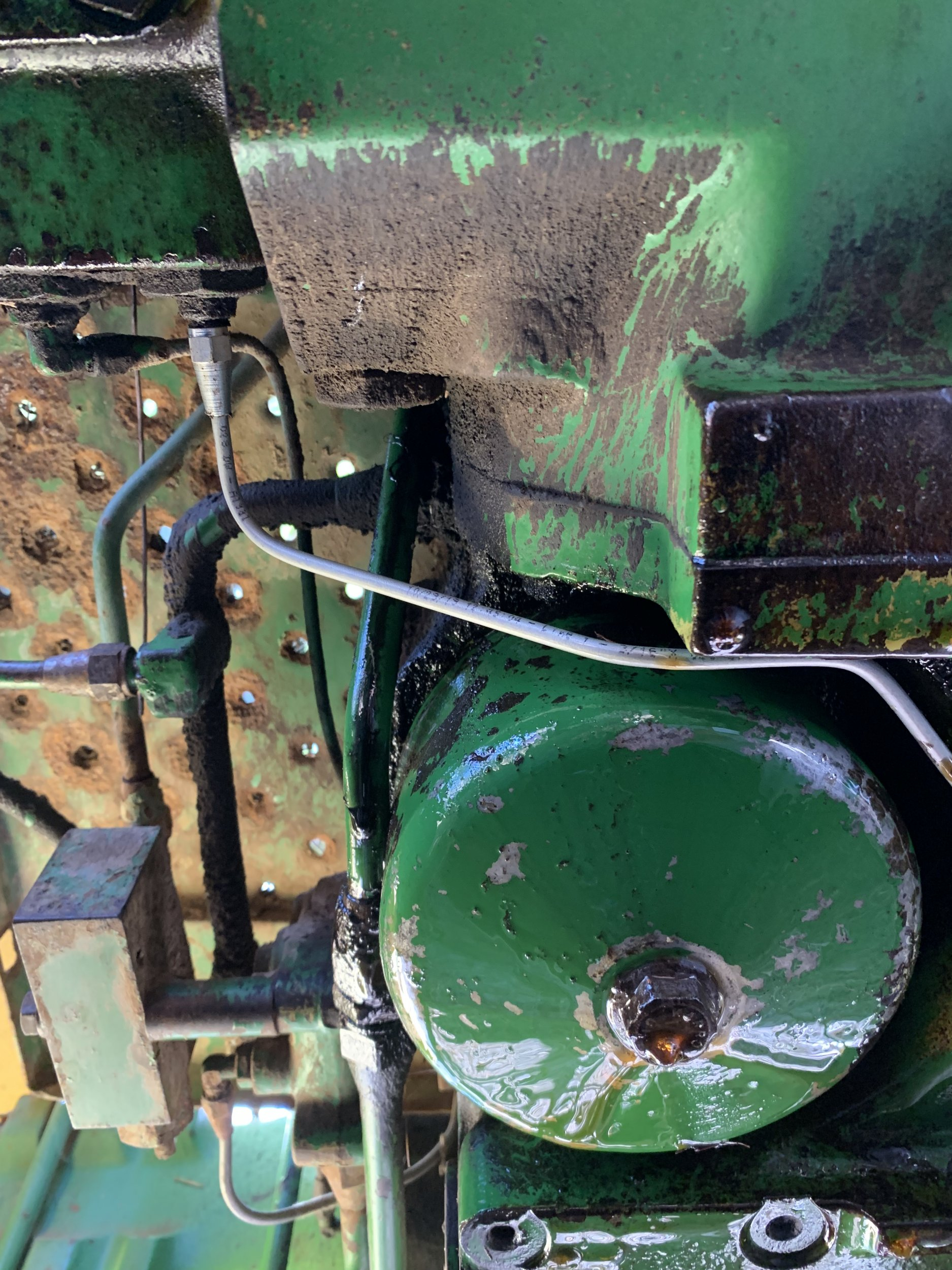

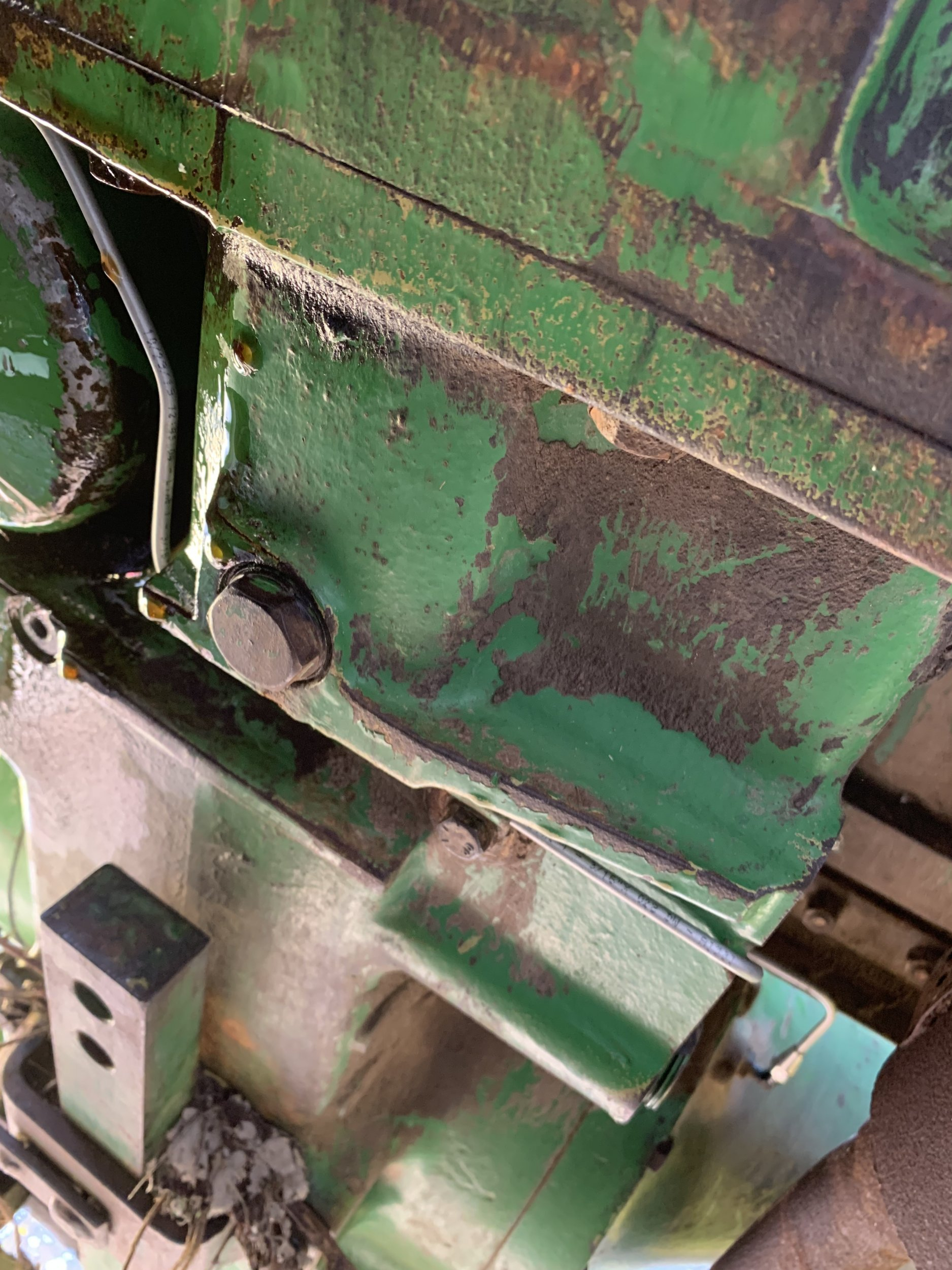

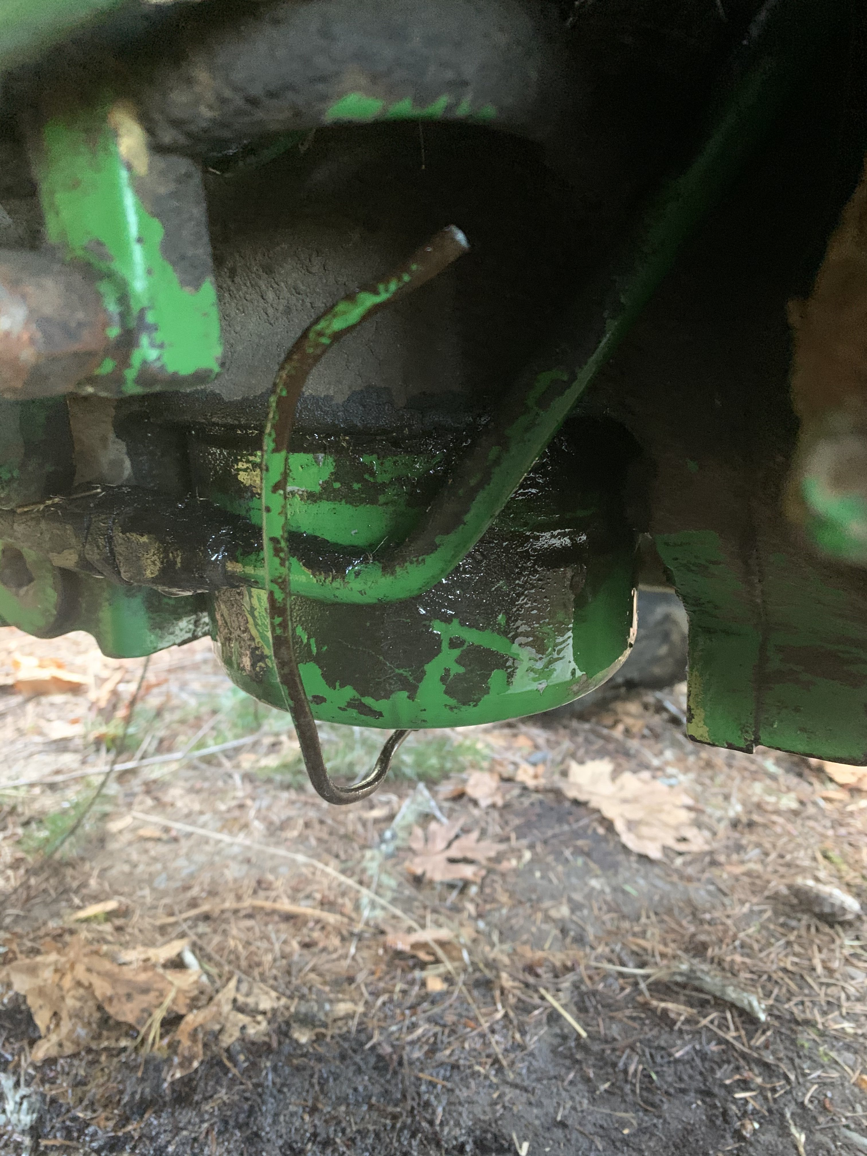

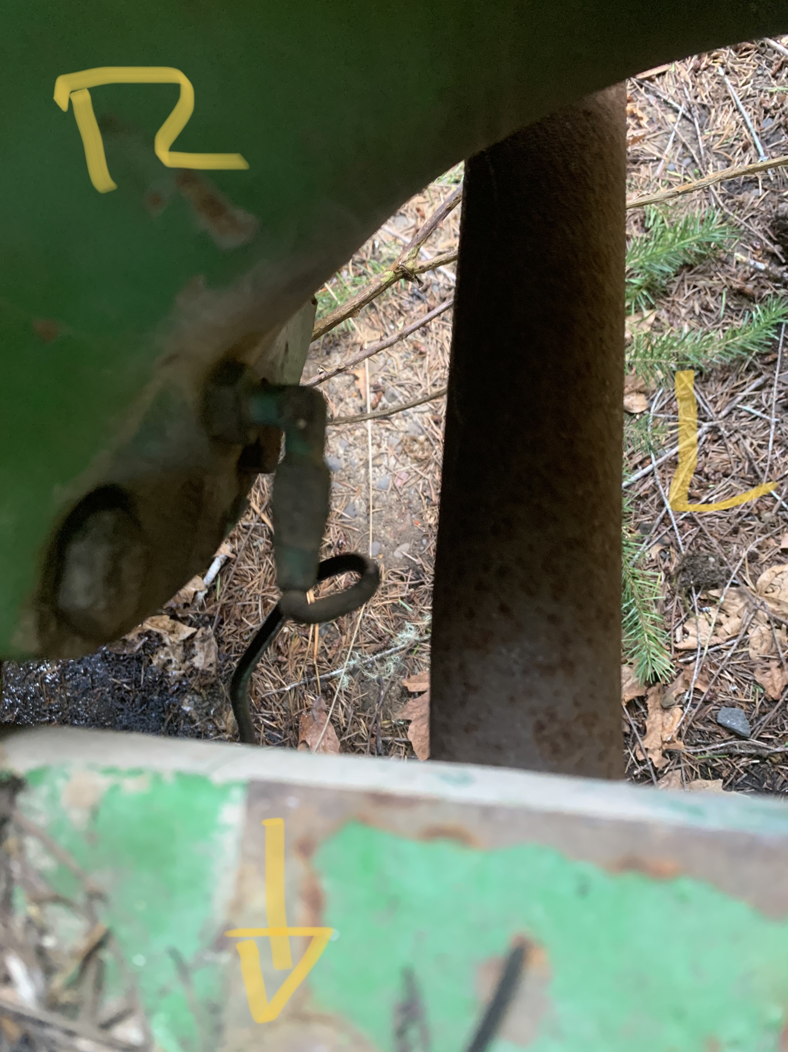

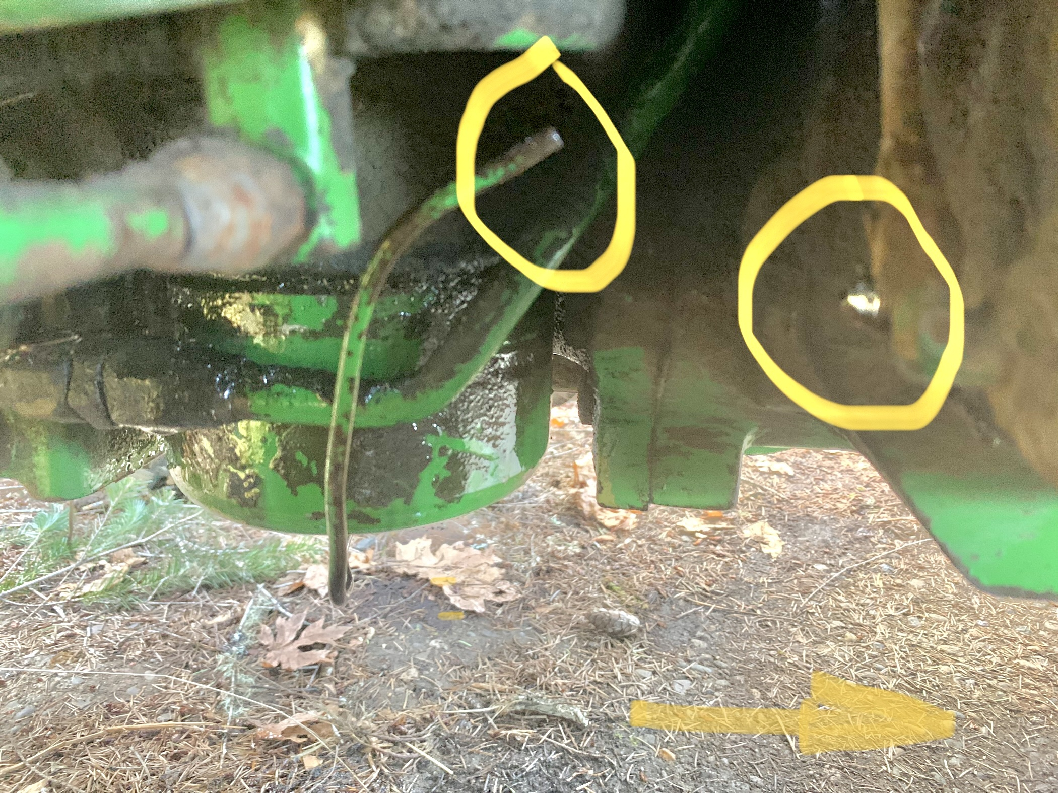

In the process of changing the hydraulic filter I broke the left brake line. I have a replacement in order AR65686.
Any tricks to bleeding the lines. Is this more difficult on an open hydraulic system?
thanks again,
Joe

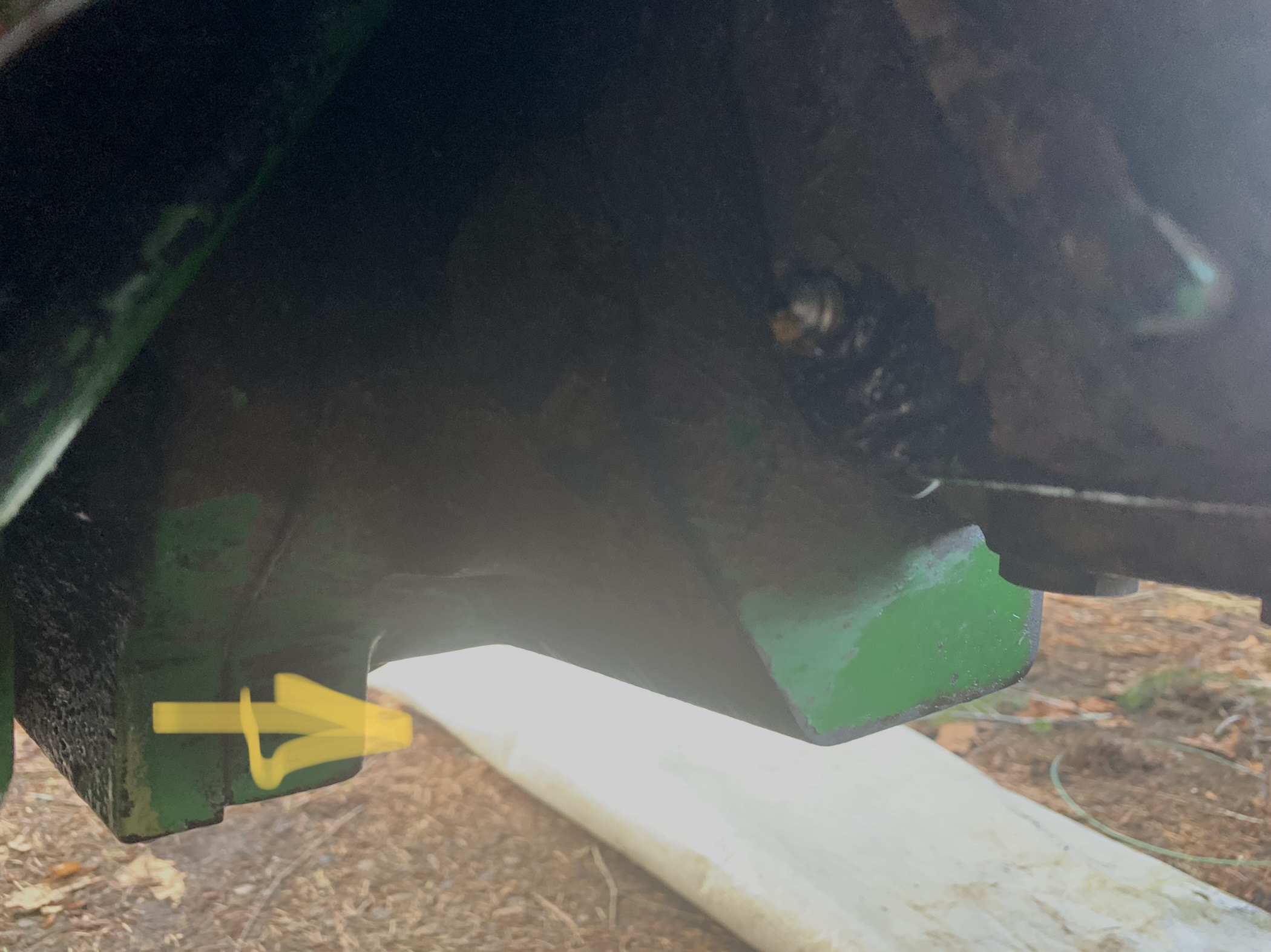

arrow points forward

Bleeding brakes is similar on open & closed center hyd systems. Both types require engine to be idling so trans pump can replenish brake valve reservoir with hyd oil.

When I bleed the 2030's brakes, I use clear tubing, run to the transmission filler.
I had to replace a left brake line. It was kinked (guess a stick hit it?) I was surprised the replacement came prebent and fit very well.

Thanks for the help! The line from JD fit perfectly. I bleed it with a loose fit of the nut, 4 or 5 partial brake pumps, then tightened. It works great!
I had a little trouble with the hydraulic filter (as you can see) and kept trying to seat the rubber gasket on top of the housing bowl. I tore up 2 and lost a lot of fluid before I realized it needs to be seated on the tractor side... or at least that was what worked for me.
