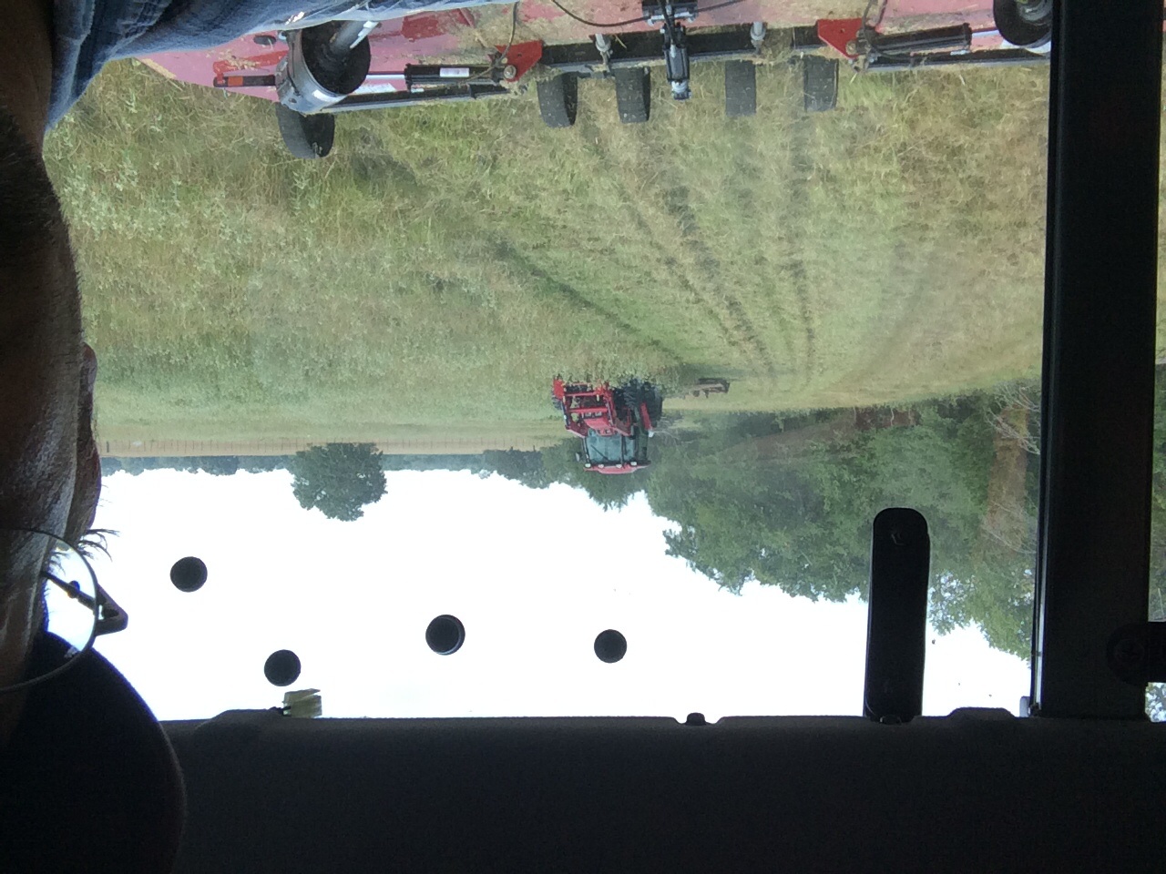

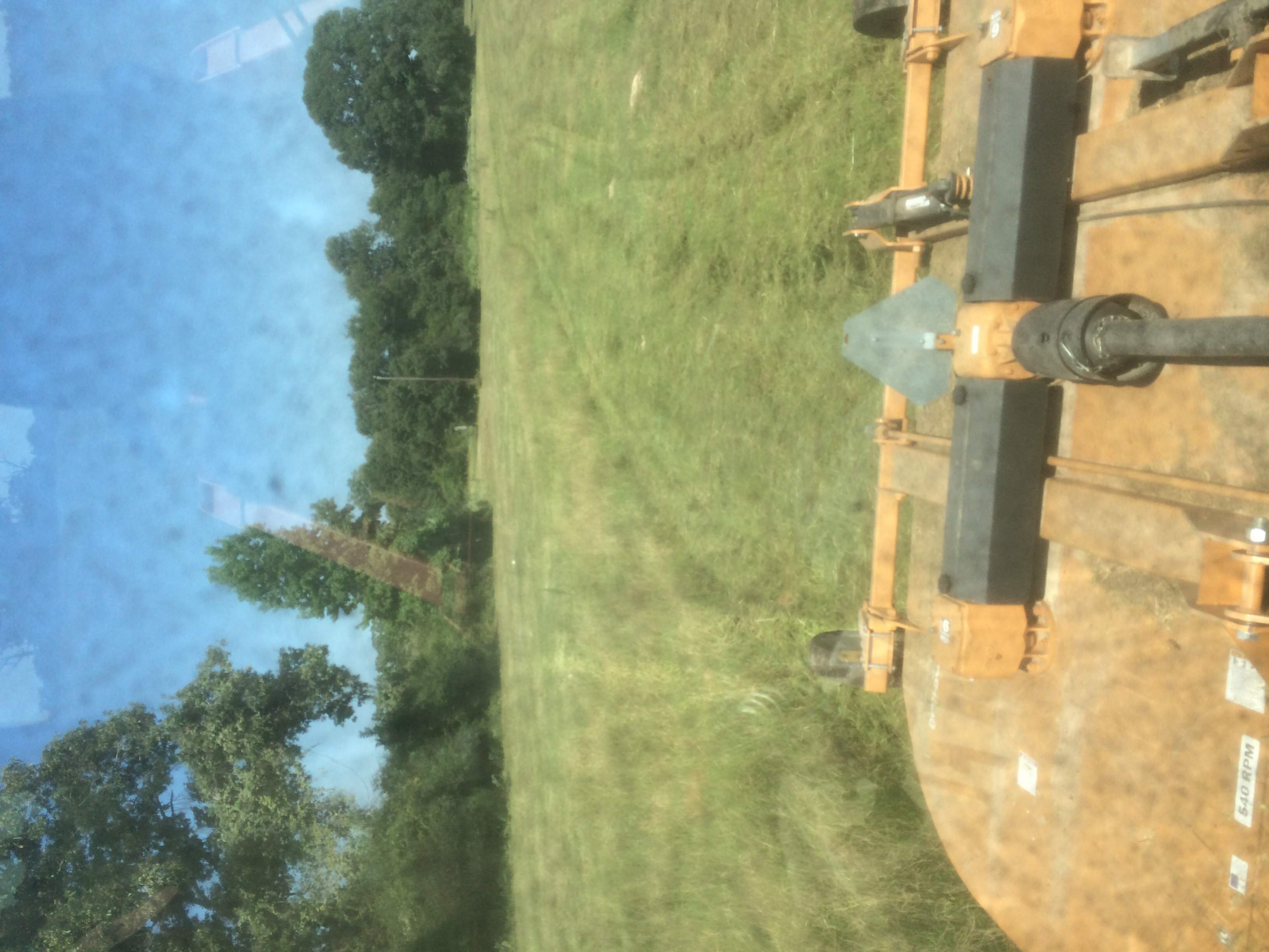

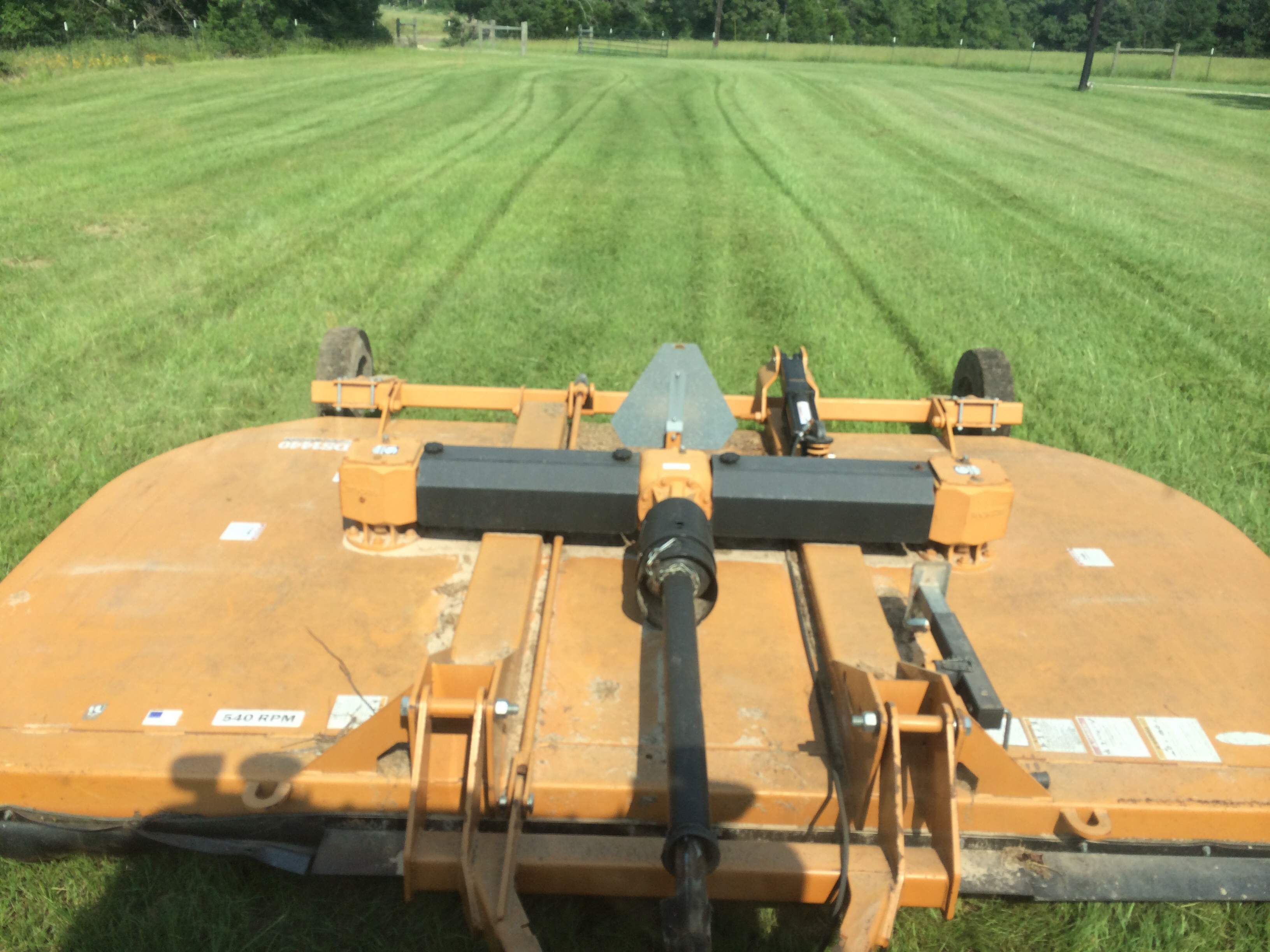

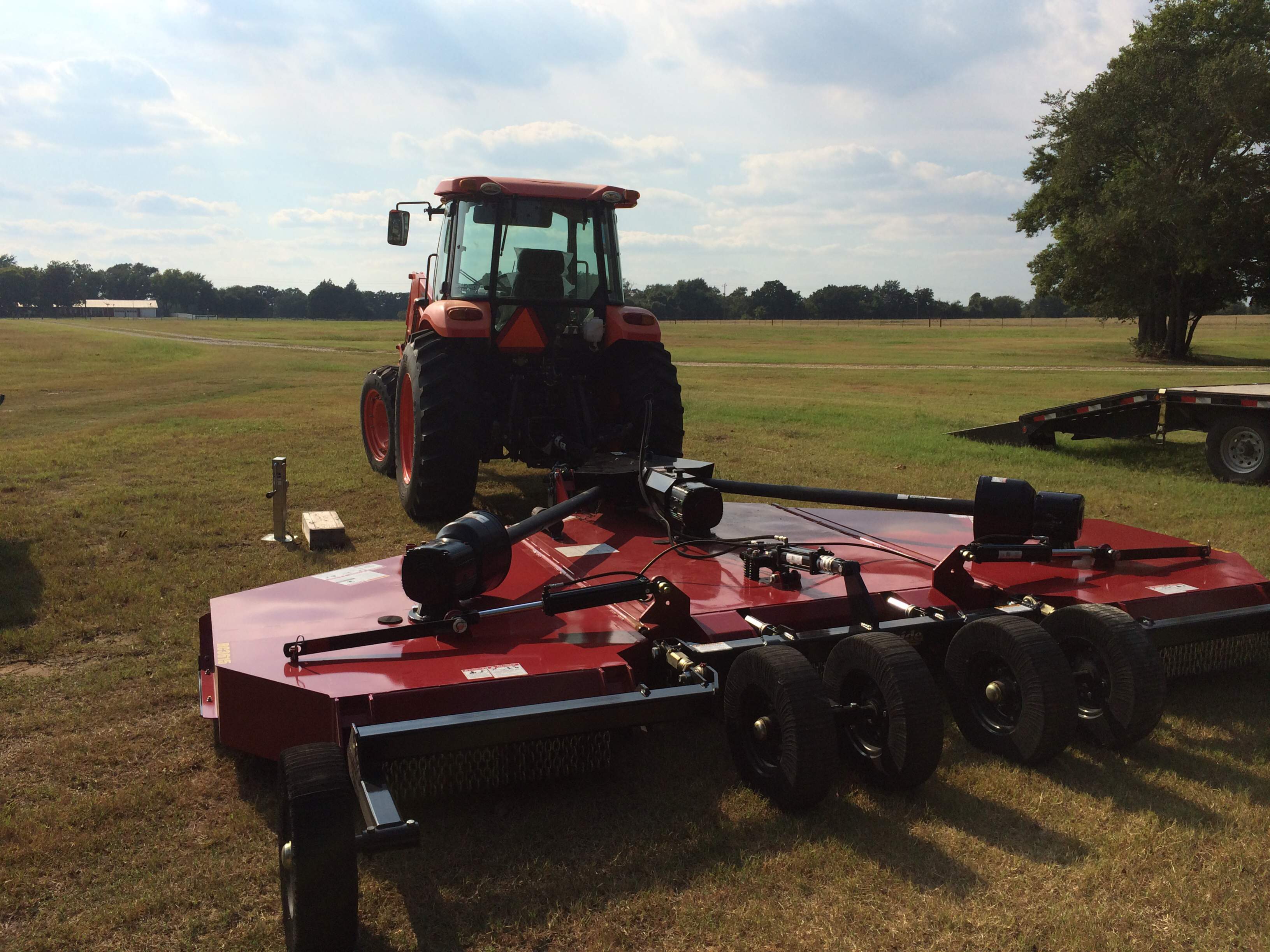

I just sold my 8ft and bought a 15ft batwing,both LandPride purchased the Plainsman for 11,600. I have it set at 6in.cutting height and with 64pto HP i was running 4low at 4.2mph,without any problem. I also have a 12ft straight deck Woods brand shredder,good for level pastures only but the cut quality on all three are the same,all do a great job. Have you looked at the 12ft batwings also,they are alittle better $, I have also seen some of the lighter duty 15ft for around 9,000.
/ 8FT VS 10 MX #24
Sorry about pictures being sideways and upside down,it's me and this new phone. I have it figured out now,some what...
