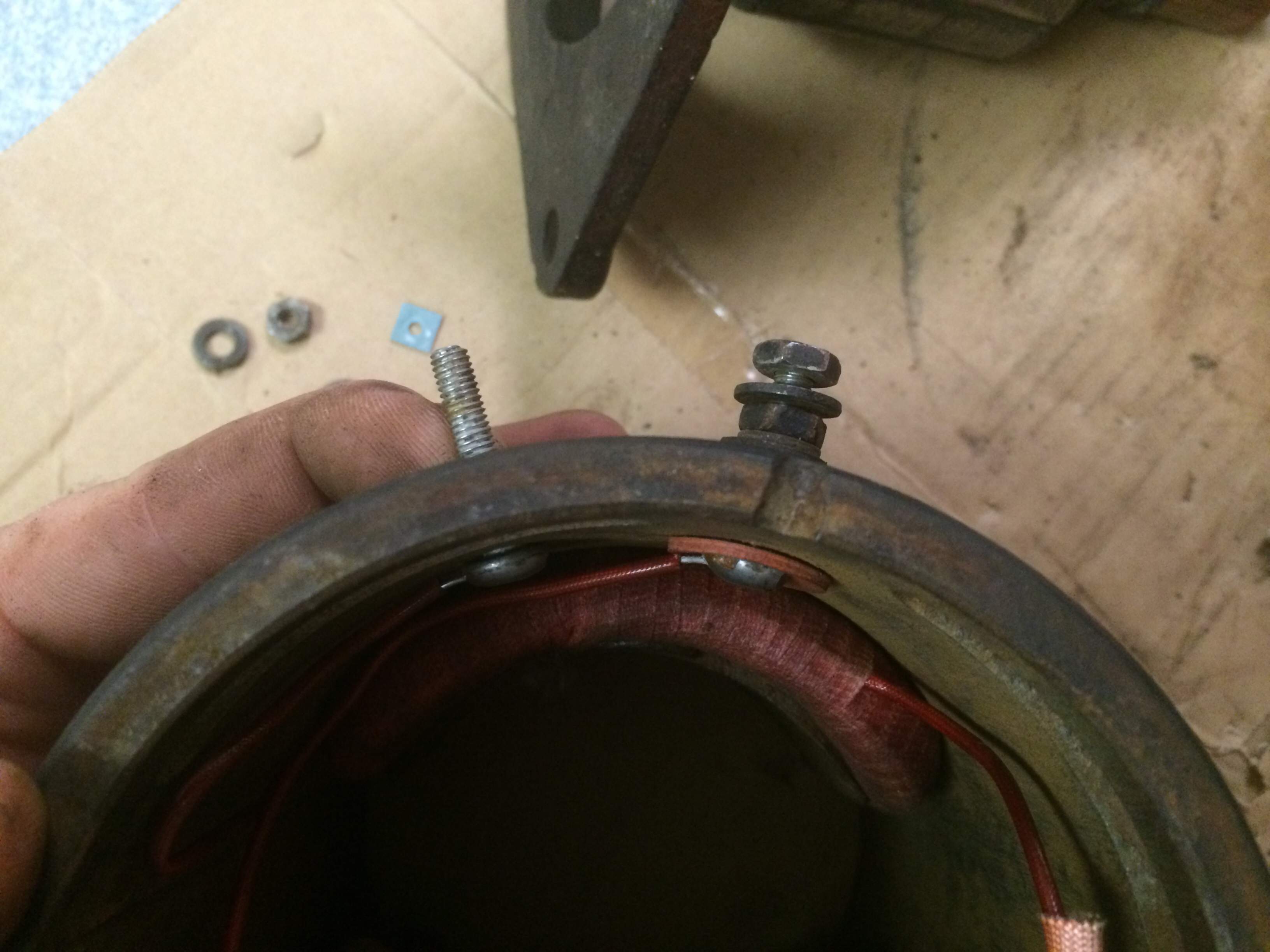

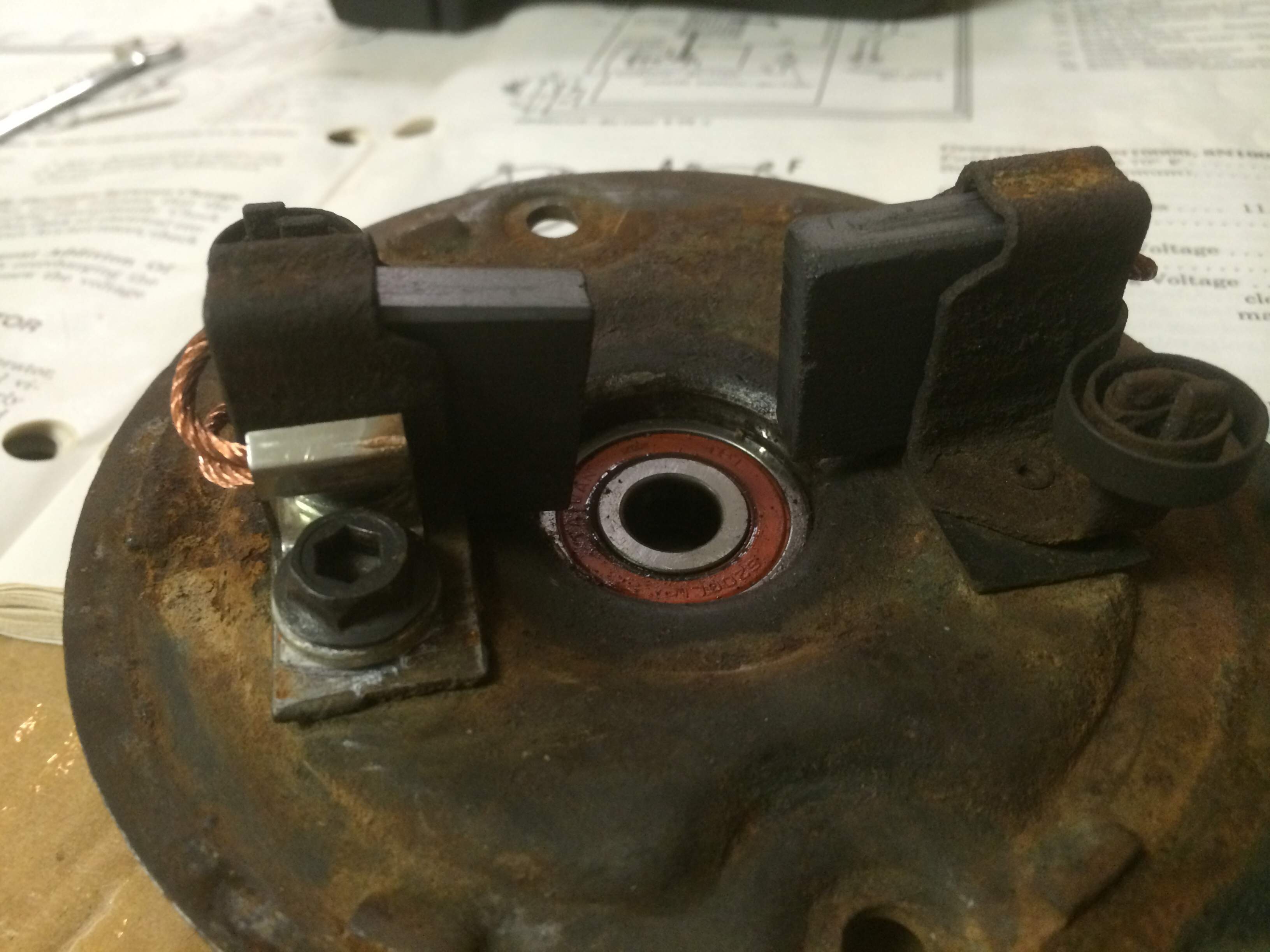

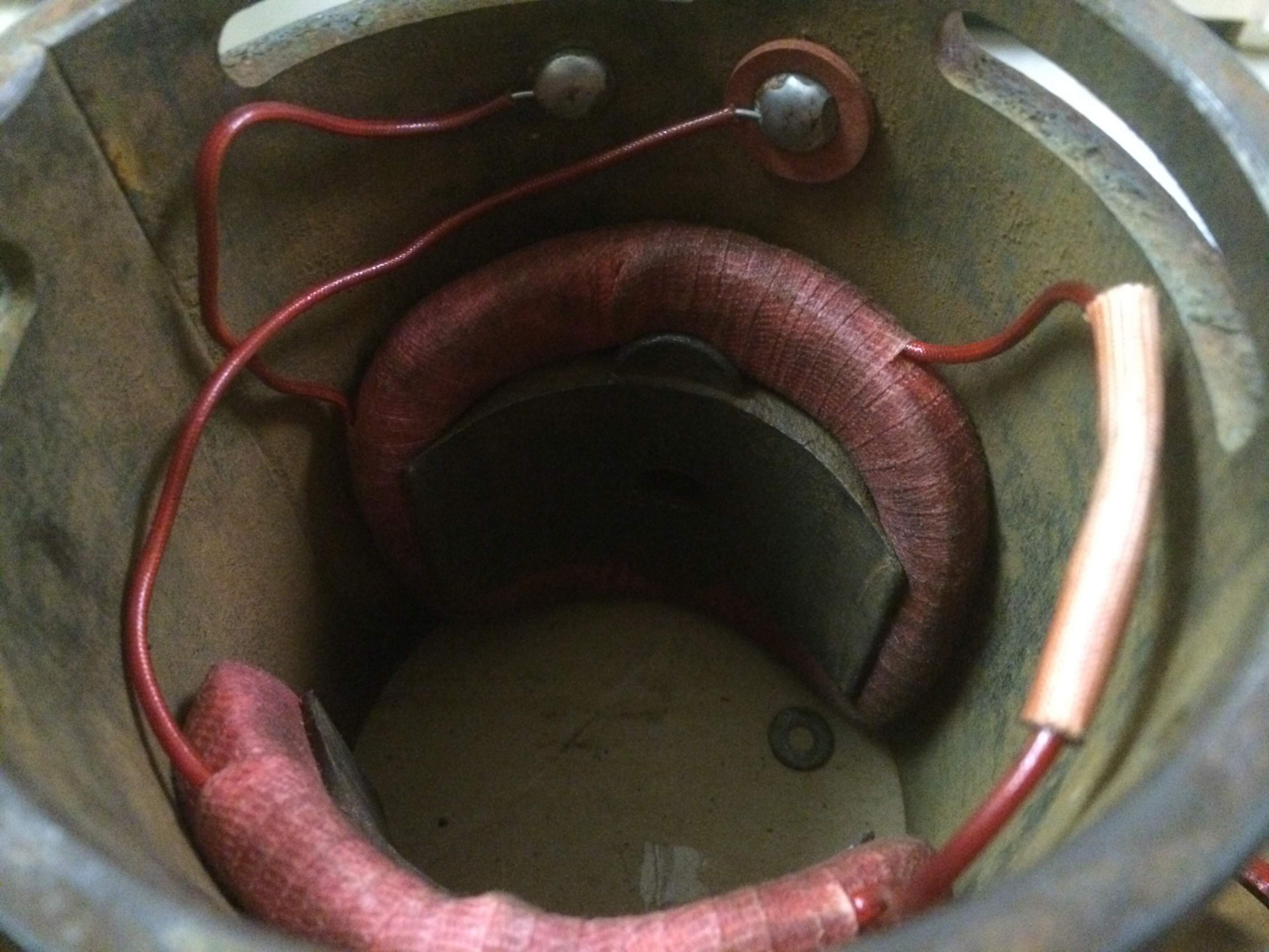

ok, I have the genny off the tractor and pulled apart. The fields (brand new) ohm out at 3.2-3.3 ohms, exactly what the fo4 manual states. The brushes are new , and the armature has been tested and had the comm turned down by an auto electric shop who said it was good. Am I putting this thing back together correctly? I reassembled it the way i took it apart, but that is assuming that it was put together correctly to begin with.... One wire from the field is connected to the insulated field stud, and the other is connected to what i was assuming is the ground stud since the two were marked F and G respectively.
Then on the back plate, one of the brushes is grounded directly to the case, and the other is connected to an insulated stud (armature correct?)
This looks to be consistent with an internally grounded type B generator..... Where do i go from here? (will update with pics shortly)

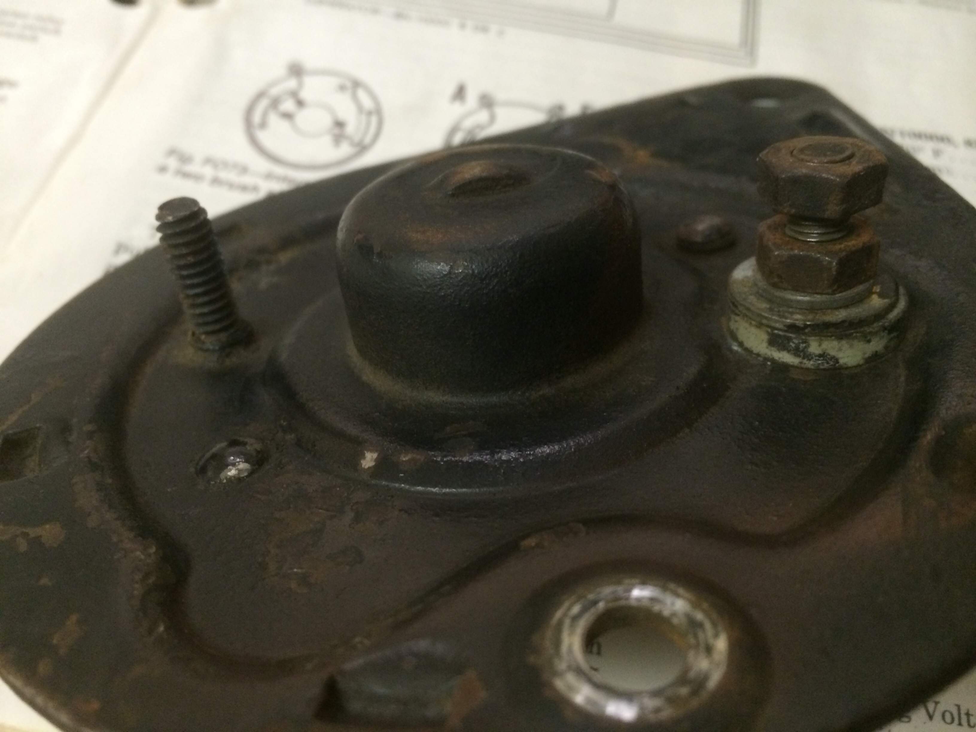

I believe a previous owner may have put a newer style generator here then, and may explain why the diagrams in the fo4 don't quite match up with what I have been looking at for the last month!! This is the way the fields are connected

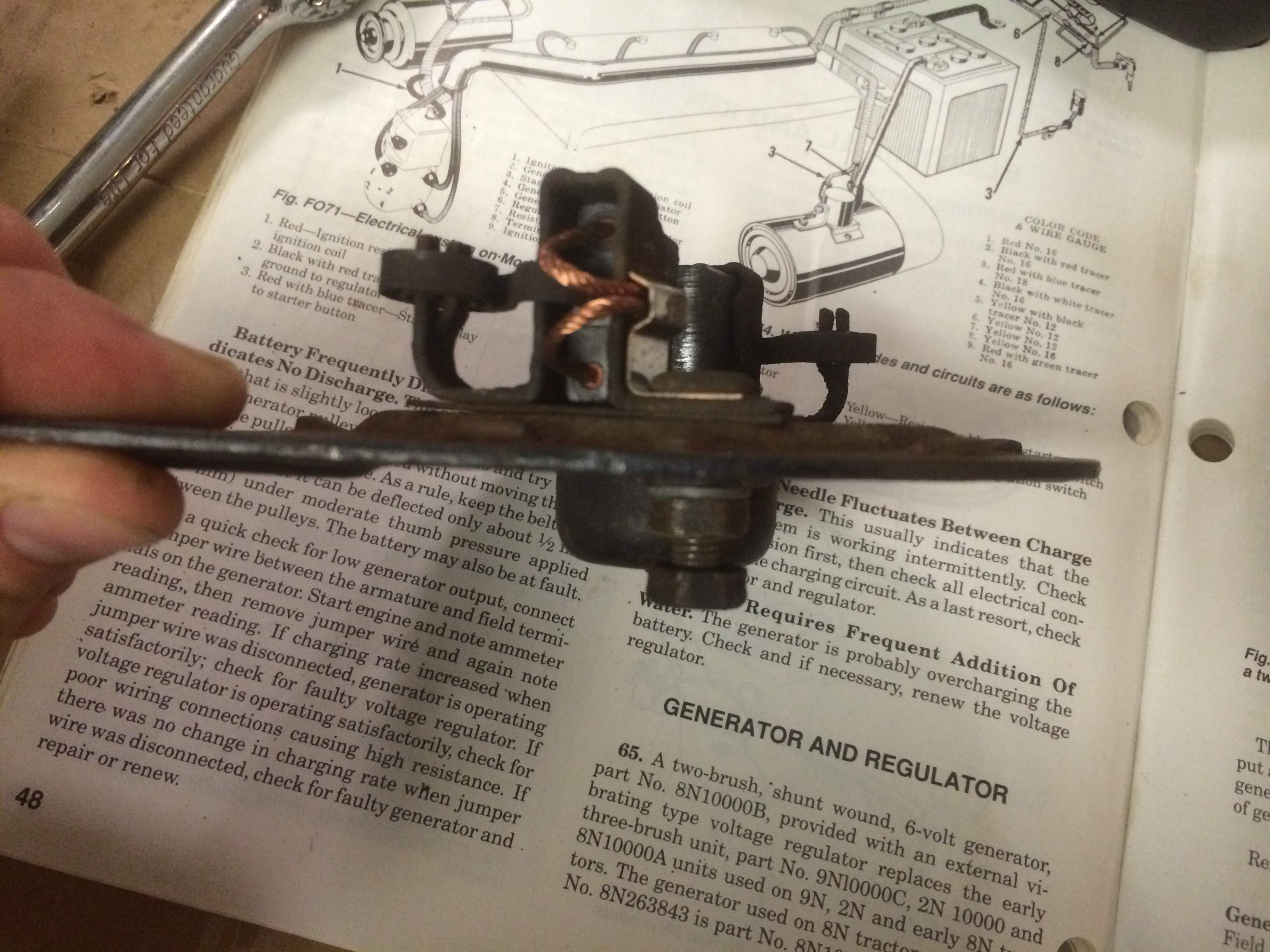

image.jpg one on right is insulated, one on left is uninsulated to case. Then the brushes, image.jpgimage.jpg
again the one on the right is insulated to a large stud, while the one on the left is uninsulated to the case. Is this a 53+ model, or am I just not seeing this correctly? If you need me to take different pictures let me know what you need to see.....

The more I look, the more I am thinking this is my problem. I believe I have a newer type B generator with a type A regulator.
