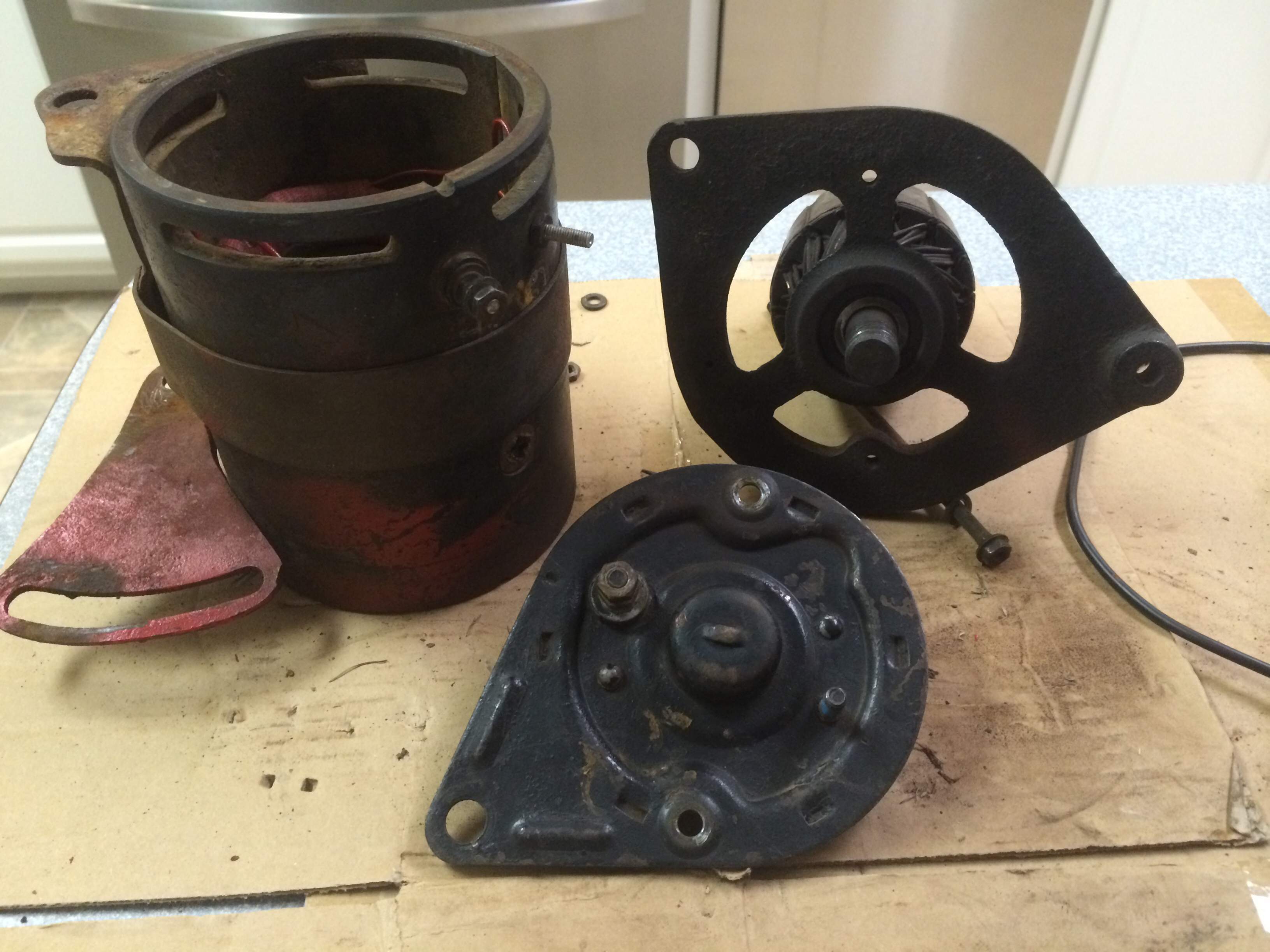

I'd need to see a pic if it to see if it was a 53+ with 2 Integra brackets, or a late 8n with no brackets, or a from n with front bracket.
Neither matter, as circuit type is defined by how fields are connected, you can rebuild an A like a B... Just need the correct reg to match circuit type. If u have an A reg, wire the Genny as A

entire case really.
   / 8N 6v Generator rebuild? #34
no brackets = late 8n
front bracket = front mount n
front and rear full barrel size = 53+
but if yours fits.. whatever it has for a bracket.. just wire it to match your reg.
heck.. could be a falcon gen or some other application on there... etc. who knows what someone bolted up 50 ys ago. :)

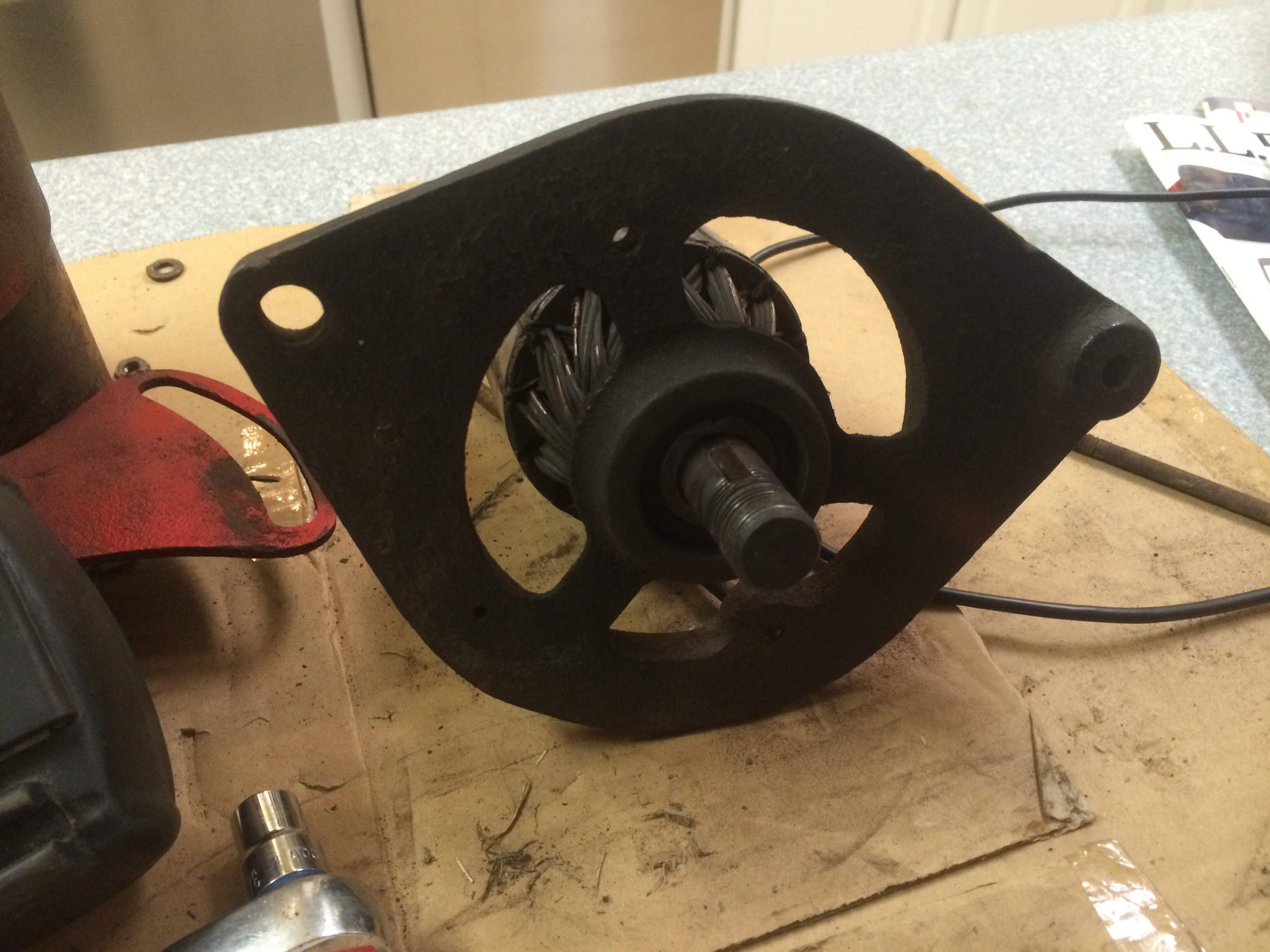

wow. to me, on my phone screen.. looks like a 53+ gen with front and rear brackets.. which aren't used.. and it is setting in a saddle mount for a late 8n.
is that correct?

That's kinda what I was thinking, but you word put it in words :D
#38
And no, none of the brackets on the genny case are used to mount, only the saddle with band clamp
   / 8N 6v Generator rebuild? #39
that answers it then.. someone took whatever gen he had and put it into the late 8n band clamp bracket.
that gen body could even have been from a later diesel model, then rebuilt as 6v, as the later diesel were 12 and had cooling slots.
in any event. i'd rebuild it as A if you have an A reg..
