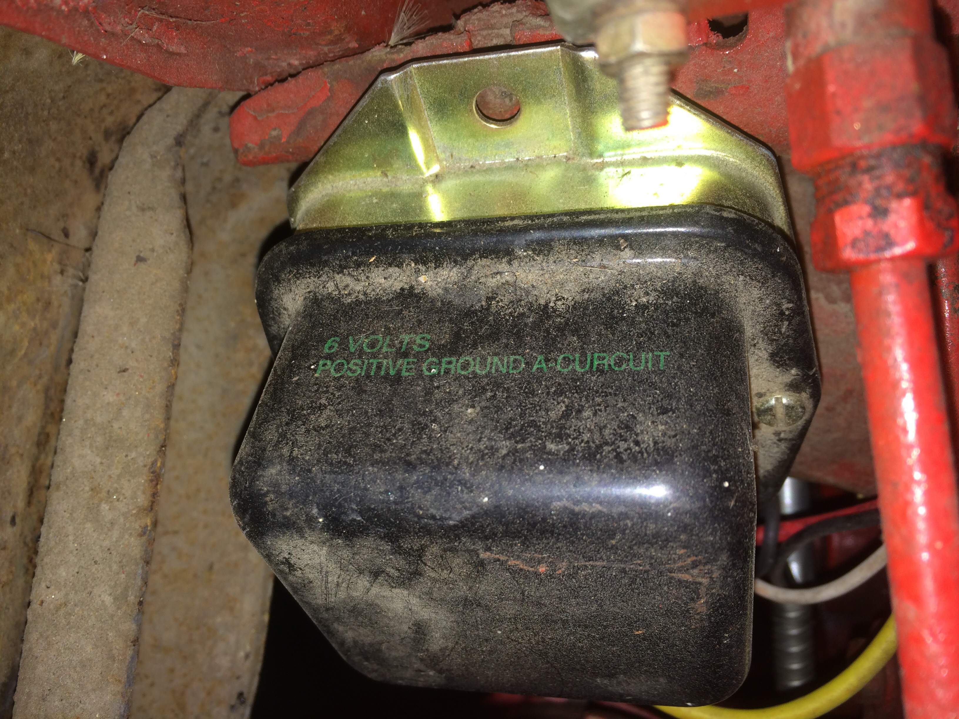

rebuilding as A correct?
did you check the reg to make sure it is A?
   / 8N 6v Generator rebuild?
#42
I was actually just looking around the internet at pictures of A vs B regulators to 100% confirm it is an A type before rebuilding it that way.
#43
I think this should confirm it, don't think I had noticed the writing before now!
