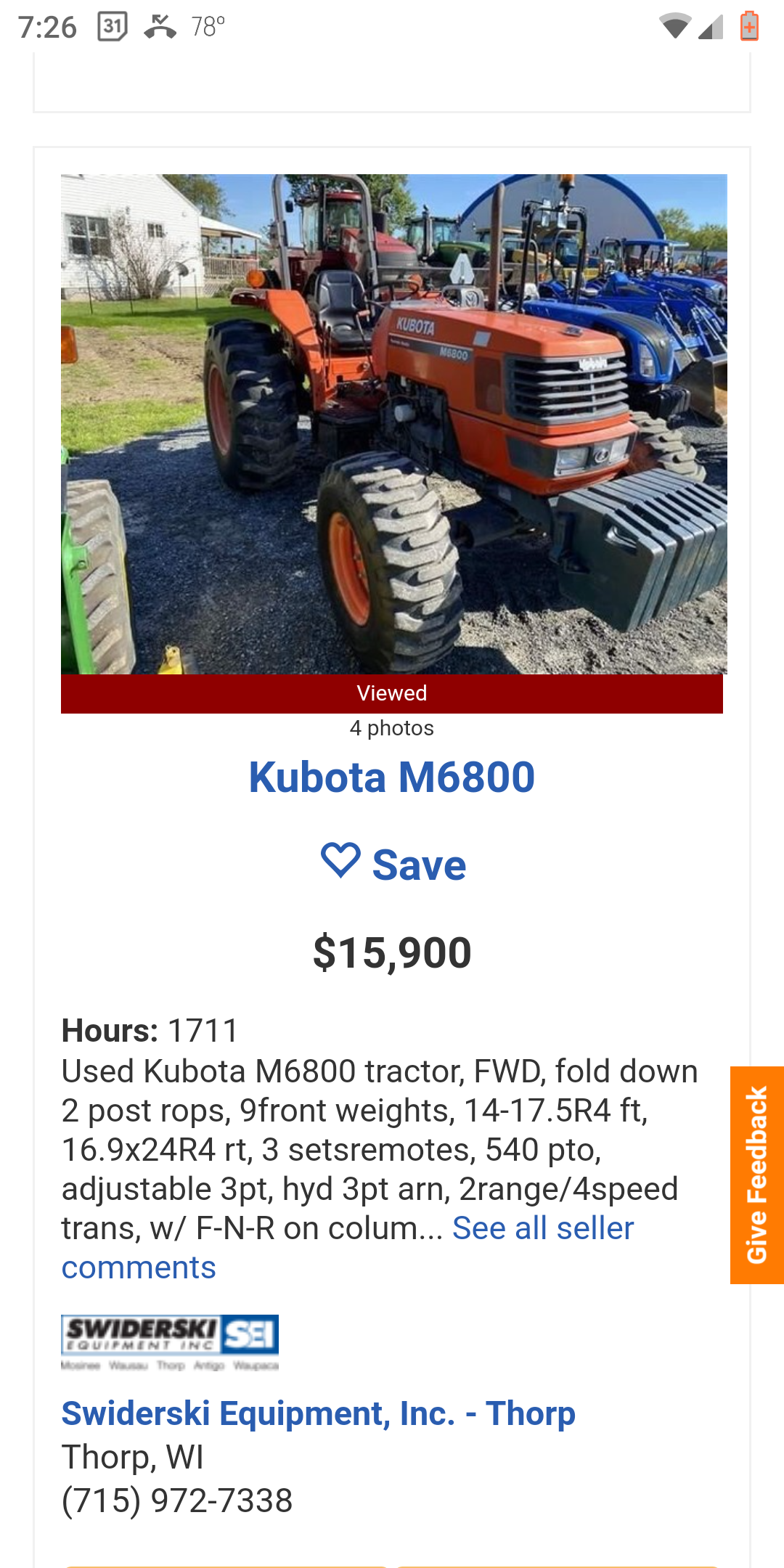

Just found this one, it's a ways away but. ..
   / 90's era kubotas better built? Also parts prices question #24
no FEL? wouldn't consider if looking at utility work, i'd pass. patience, you'll find what you're looking for, they're scarce, but people always need cash

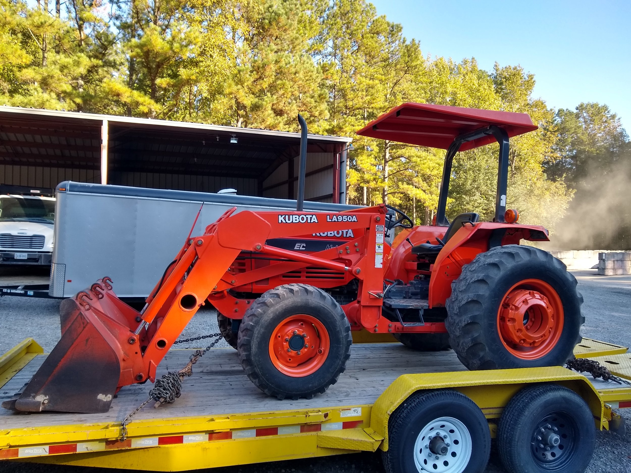

Thanks everyone for your input. This thread helped me to choose a really nice, well maintained '97 L4850 Everclutch, FEL, with under 2000 hrs on it.

Congratulations! That one really sounds like a winner.
Next you'll be telling us it was owned by a retired mechanic who stored it inside and only took it out on sunny days.... :)
If it were mine I'd want to find an OEM parts and workshop manual set, add an over-running clutch to protect the dry plate PTO, and then look around for some sort of canopy. The best canopy's are insulated and are 4 post type. The front posts make it easy to get on & off.
But if you do none of the above, it won't make a bit of difference because so far it sounds like you found a good one. The loaders on those old LXX50 series were awsome.
The "ever-clutch" was one of those better ideas that (IMHO) got dropped because of the expense of making it. Same goes for 5 cylinder engines.
