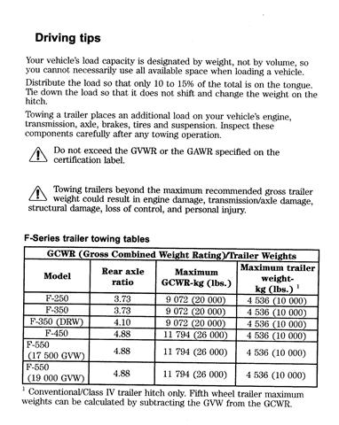

Here's the relevant info from the 1999 F-450 diesel supplement
Looks like that 99 F450 has a 26,000 lb GCWR

Here's one more--it's part of the 1999 Ford RV and Trailer Towing Guide
http://changingears.com/Ford-1999-Towing-Guide-Partial.pdf
At the end of this excerpt you'll find info on the towing capacity of the 1999 Ford F450 chassis/cab. Looks like it's pretty similar to your 450 except you have the weight of the pickup bed added.

Your truck should have a 26,000# GVWR and it should weigh around 8,500# leaving you with 17,500# for towing in the real world. The 17,700# number is for just the cab and chassis, no bed, extra fuel tank, ect.

A 35' trailer would be okay, just have to be careful or you could overload it because you'll have room for more tractors. The longer the trailer the easier it is to put too much load on the truck. You could end up loading too much forward of the trailer axles and more on the rear of the truck. A shorter trailer will force you to load back toward the trailer axles. Just have to watch how you distribute the load.
