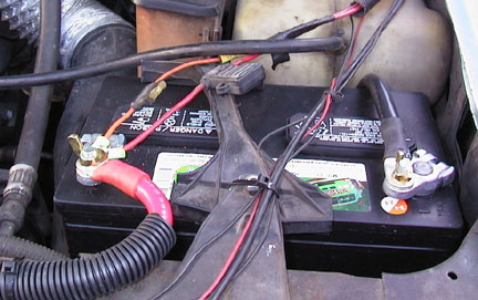

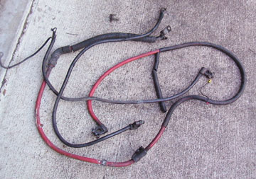

My cables were also shot on my 85 F250 diesel so I made new positive and ground cables out of tinned copper 2/0 wire with crimp on lugs and heat shrink (the kind with the glue in it...not the cheap stuff). I have a battery cable crimper so it makes it easier.
A couple of photos of the old cables and the new.

The terminal for the positive side of one of the batteries (diesel) is loose and wallowed out and you can't get it tight. I would get a new terminal and clamp it on there, but the problem is that the terminal is not at the end of the cable. Instead, the cable keeps going past the battery.
Anyone know of a way to fix this without replacing the entire cable? The replacement cable is $100 but more importantly it appears it would be very difficult to replace - its long and goes down in the engine compartment to the starter, etc where you can't see it.
put a copper penny on a board and peen it.. now slip it in to take up the space.

Use a hacksaw or file to remove some material on the inside where the tightening bolt goes thru.:D

It think somebody has already removed some material from the connector - its pretty thin as it is. But the penny trick might be worth a try for the short term.
