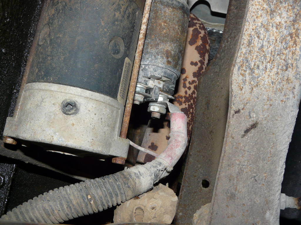

Actually the rest of the cable and connectors look fine. Here is a pick I took lying on my back under the truck of the end of the cable that goes to the starter. In the pic of the connector at the battery, the big cable that goes to the left goes down to the starter. The cable from the right comes from the other battery. This is the left battery (looking at the truck from the front) that the terminal is bad on, although I don't guess it matters, just a point of reference.

The technician in me says that the cable connection needs to be replaced. The redneck in me says you could save a lot of money and grief by putting a small C-clamp across the outside of the terminal and post and tighten it really good and tight.;):p

If you have some lead take the cable off, put the battery part in a jiggered up tin can mold and pour some new lead around it. Drill out the holes out afterward.:D

With that heat shrink and split loom around the cable, you cannot say that it looks good.

The copper penny/washer will probably work. Put the penny on top of a vise opened to about 1/2 in, and lay the penny/washer on top, and lay a rod across the penny/washer and smack it to round it. Then insert it in the clamp and tighten down. I have an F-250 diesel, and if the battery cable came loose, that is what I would do.
Could use one of these and connect both cable ends to the terminad stud.
East Penn Marine Battery Terminal, Model 00354 (usahardware.com)
YouTube - crimping battery cable terminals
YouTube - The proper way to solder battery terminals
This marine terminal might bed the way to go if I have enough slack. Would require 3 terminations though. Could I count on the overall connection being good?
So, there is something wrong with that part of the cable too? Not sure if I see what you're talking about on the heat shrink and "split loom"? If there is something wrong there I guess the whole cable needs replacing.

Once corrosion gets into the wire, it will work its way all the way through the cable. If one end of the cable has cracks in the insulation then the corrosion can work itself all the way to the other end even though the other end is sealed in heat shrink and split loom. Plus the wire in the original Ford battery cables is regular copper which is more susceptible to corrosion than tinned copper (which is used in marine applications). And those marine terminals provide good connections as long as the nut stays tight...replacing the wingnut with a nut and lockwasher usually works better.

I am not saying there is-because I (or you) can't see the cable. Moisture can get into the wire where the end is crimped on and work it's way up the cable causing high resistance. Often the insulation will be swelled up near the end.

Borg Warner makes a replacement cable that's about $70.
It's not that hard to change. The only hiccup is you have to cut up
the factory connection at the fender solenoid. Just cut off the old
batt. side and install the new. Do however get the factory ground
cables. They are made with the body/frame grounds on em.
