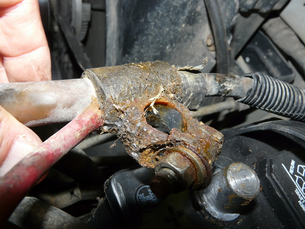

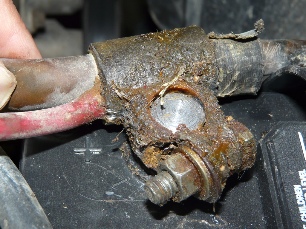

Well I don't think the penny solution will work, because it appears the connector is so thin it is now cracked. Also, there is another, smaller cable coming out that I have to get connected. Here are pics:

it's cracked from overtightening it since it was loose. it needed the penny trick months ago it seems.

The battery clamp assembly is cracked, the slip on battery cap will not do any good.

The technician in me says that the cable connection needs to be replaced. The redneck in me says you could save a lot of money and grief by putting a small C-clamp across the outside of the terminal and post and tighten it really good and tight.;):p
   / 94 Ford F250 battery cable #39
I know its to far gone but in the past I got a single terminal and a short wire and used a split bolt connector to join them together and for a worn terminal I took a piece of copper pipe cut 1 in. long and split it on the length type L for a big gap type M for a small gap ,works great.
   / 94 Ford F250 battery cable #40
I still say to suck it up and replace the whole cable...I am sure the other ends (at the other battery and the starter) are deteriorated also...
