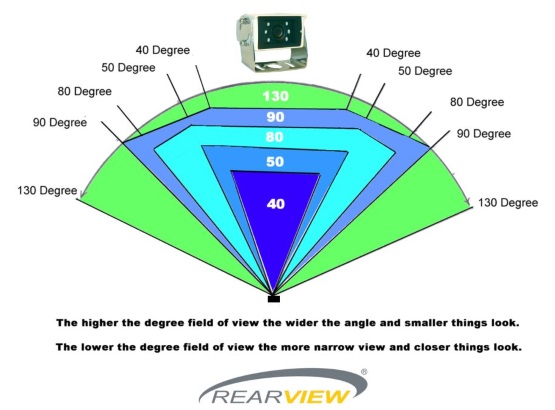

Backup cameras have a wide field of view. You need a camera with a narrow field of view:
The one I have on the front is 50 degrees and works gooder :D.
Correct Xfax. I think mine is 50° maybe 60°. I'll have to look at the book. The original camera, I bought was way too wide to be of much use.
Which one do you use and do you have some screen pics from the seat?
I have one from Rearview Systems: Backup Camera Safety Kits & Accessories Paid more but it had a 5 year warranty. Installed it on 9-2-2012 and it is still working great.

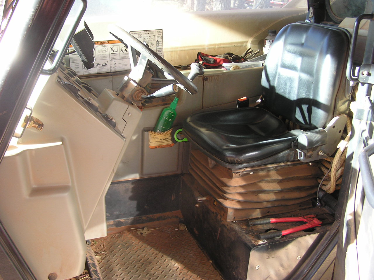

The monitor is right of the steering wheel, low enough to see out the windshield over it. The camera is over the right front wheel, pointed down to see what is out there and see the the SSQA plate when changing attachments:
The view from the seat, moving a big round bale and the monitor showing what I can't see:
Looking up I see a tree trunk ahead. Looking at the monitor I see that I will miss it:
Approaching the cattle guard:
And a picture from behind, showing the clearance:

I think that offset cab works to your advantage with the camera setup, being able to eyeball the left while viewing the right on the screen.
Yep, this shows the view and what the camera sees:
The offset cab works well with seeing the 42" forks also:
But the biggest advantage for this old man is the step-in cab:
