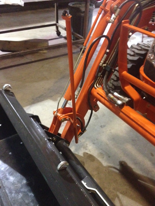

Did people mount their bucket cam to the loader arms or to the bucket?
I got my monitor installed along with the wiring for my power SSQA & put the dash all back together. Running the wires up the loader arms now & trying to figure out where I want to mount the camera. I'm thinking mounting it to the loader arms so it doesn't pivot with the bucket might protect it a bit better & give the best view compared to mounting it so it pivots with the bucket. I have a SSQA, so I wouldn't actually mount it to the bucket itself, but some of the braces behind the SSQA pivot with the bucket. Looking for thoughts & opinions.

I made a quick and simple mount out of emt conduit , and mounted it like waxman did so it pivots with the loader attachment. This way I have very little time or money in the mount to see if I'm going to like it mounted that way, or if I may need to modify the mount. Once I'm happy with it I will build a nicer mount. You could always mount the camera to a magnet so you can change locations for different views, would let you try different views before making York mount.
I mounted to bucket -- see pics on page 22 of this thread. First I tried a few different temporary mount locations/types and concluded the bucket mount was going to be the only one that would give the views I was looking for.
